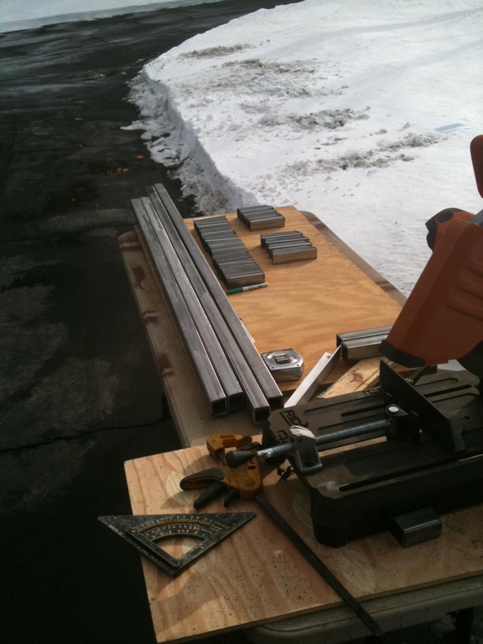

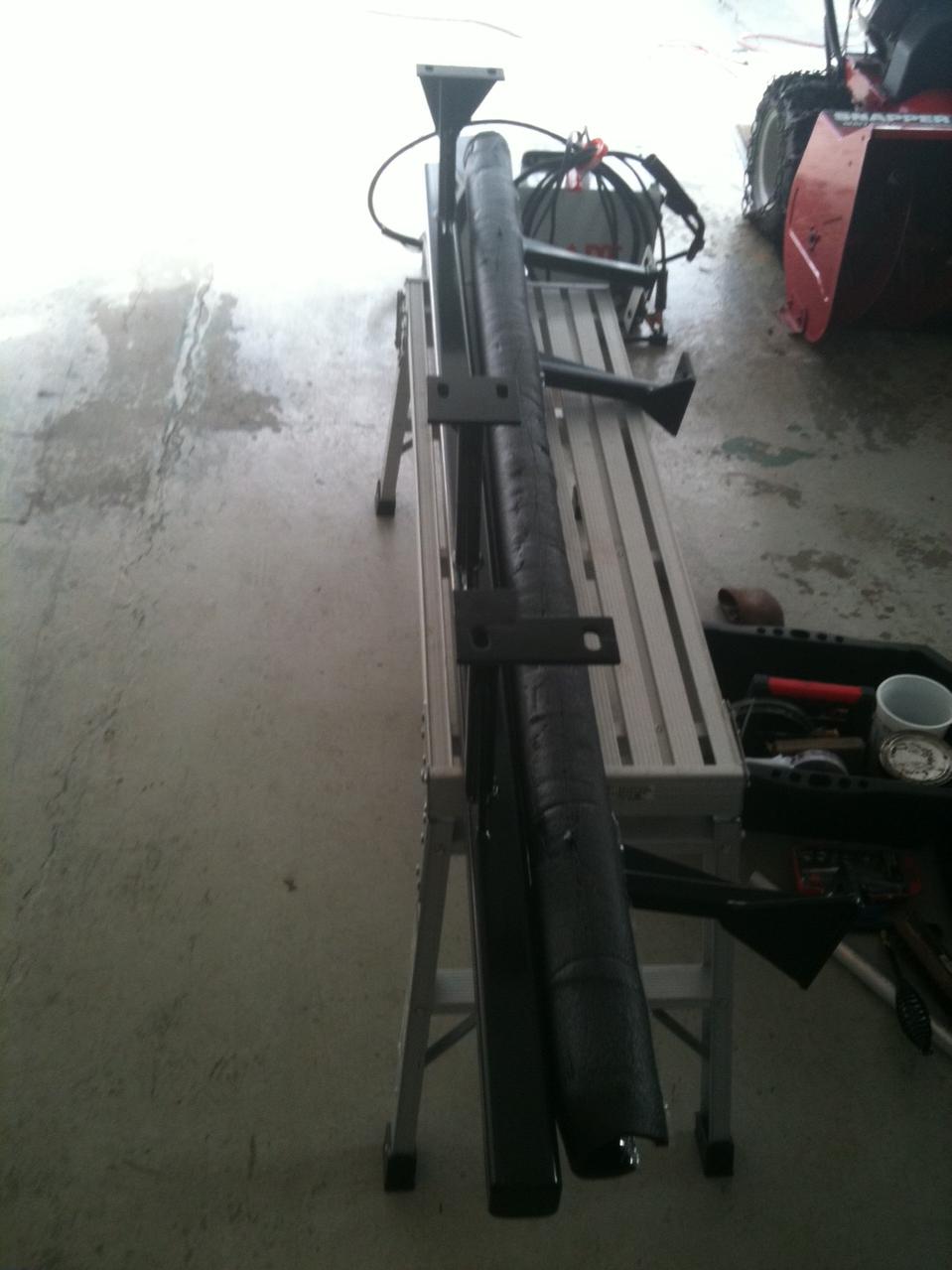

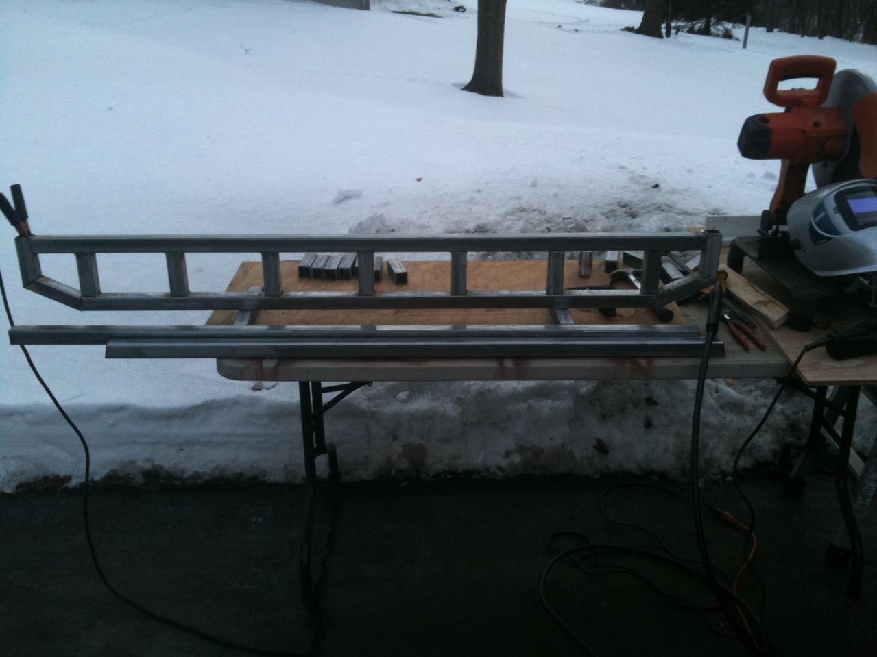

the first couple of pics are the materials...I got the steel and cleaned it all up...cut it to size ...and with a little grinding will be ready for welding.
I'm outdoors so weather is a factor...but at least the beer is cold!

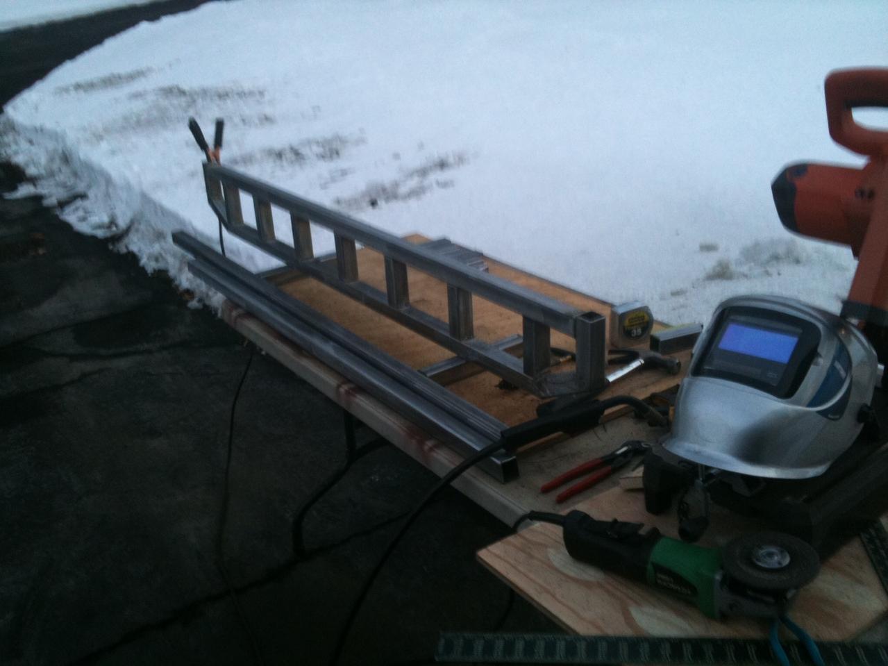

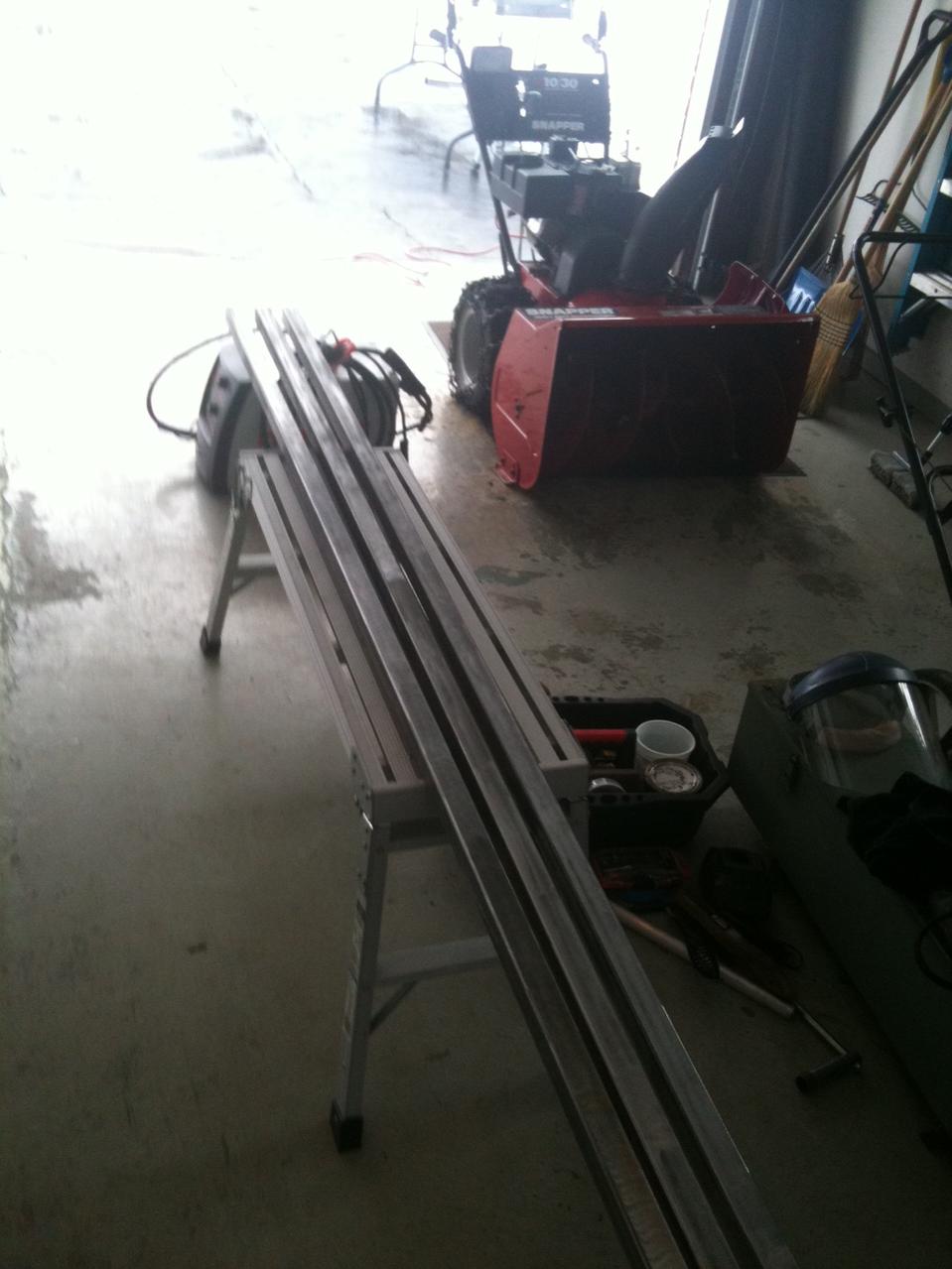

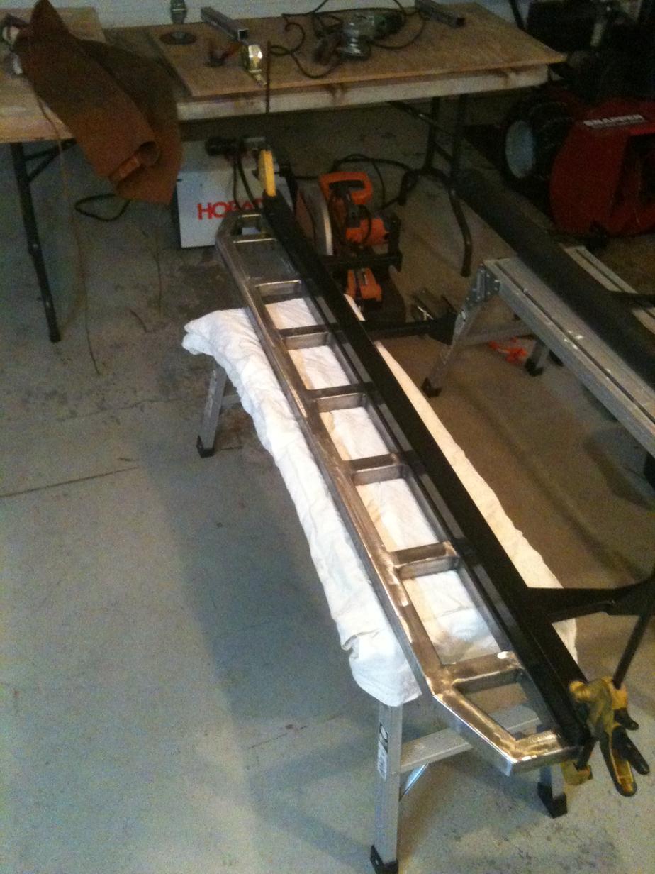

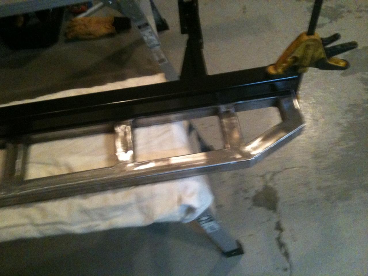

Got the pieces cut for both and got one fully together, sanded and clamped on the Rocky Road Slider...only problem is I didnt see an instruction sheet for the sliders, so I don't know if I'm mounting it the right way...lol....fawk it..I got a 50% shot of getting it right:naughty:
I got to be honest....I sure as hell ain't no welder, but buddy, I can cut and grind like there's no tomorrow....I have to see if BFLAN Industries has an opening for a grinder.....:lmao:

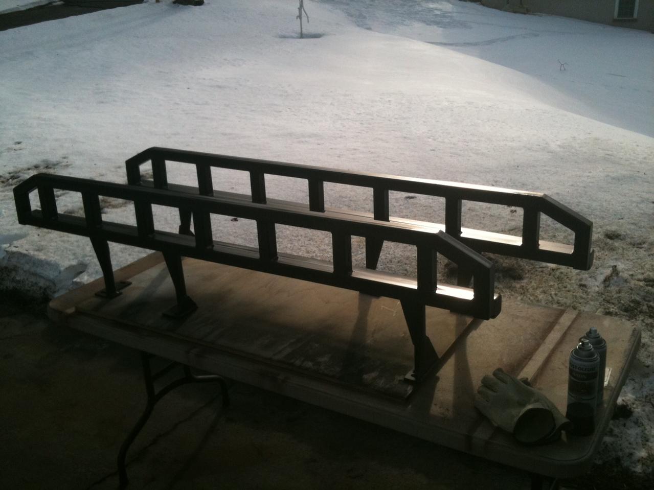

Tomorrow I finish the other one, weld them to the sliders, and prime.
Friday is finish paint, and diamond plate, Saturday install (depending if the paint is dry)
The weight of one step is about 38 lbs....but man is solid!!
The steel is 1-1/2" x 1-1/2" x .120 (1/8")

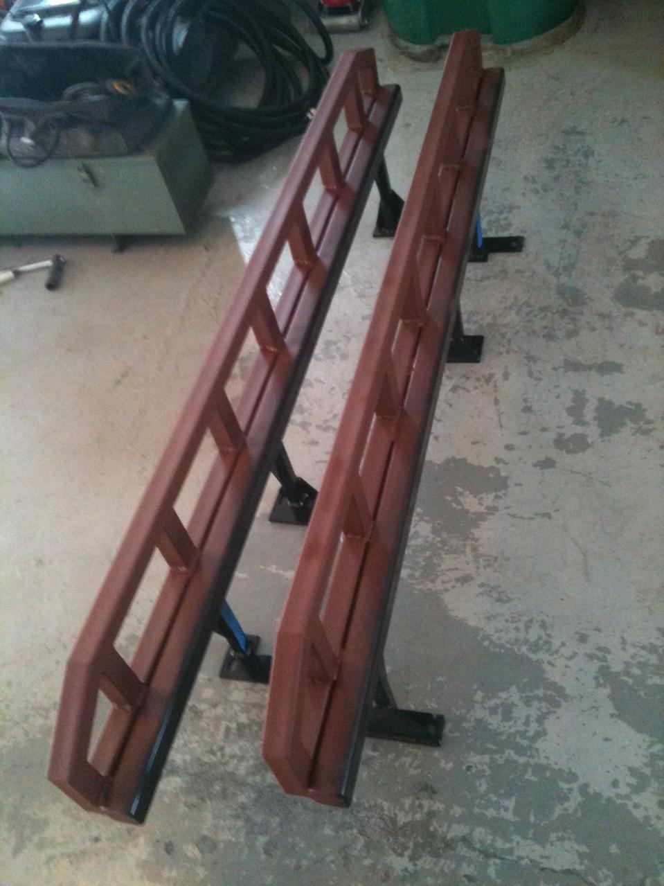

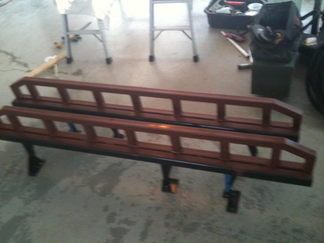

Ready for finish paint and diamond plate...
Special thanks to Seattle Mike for the pictures!

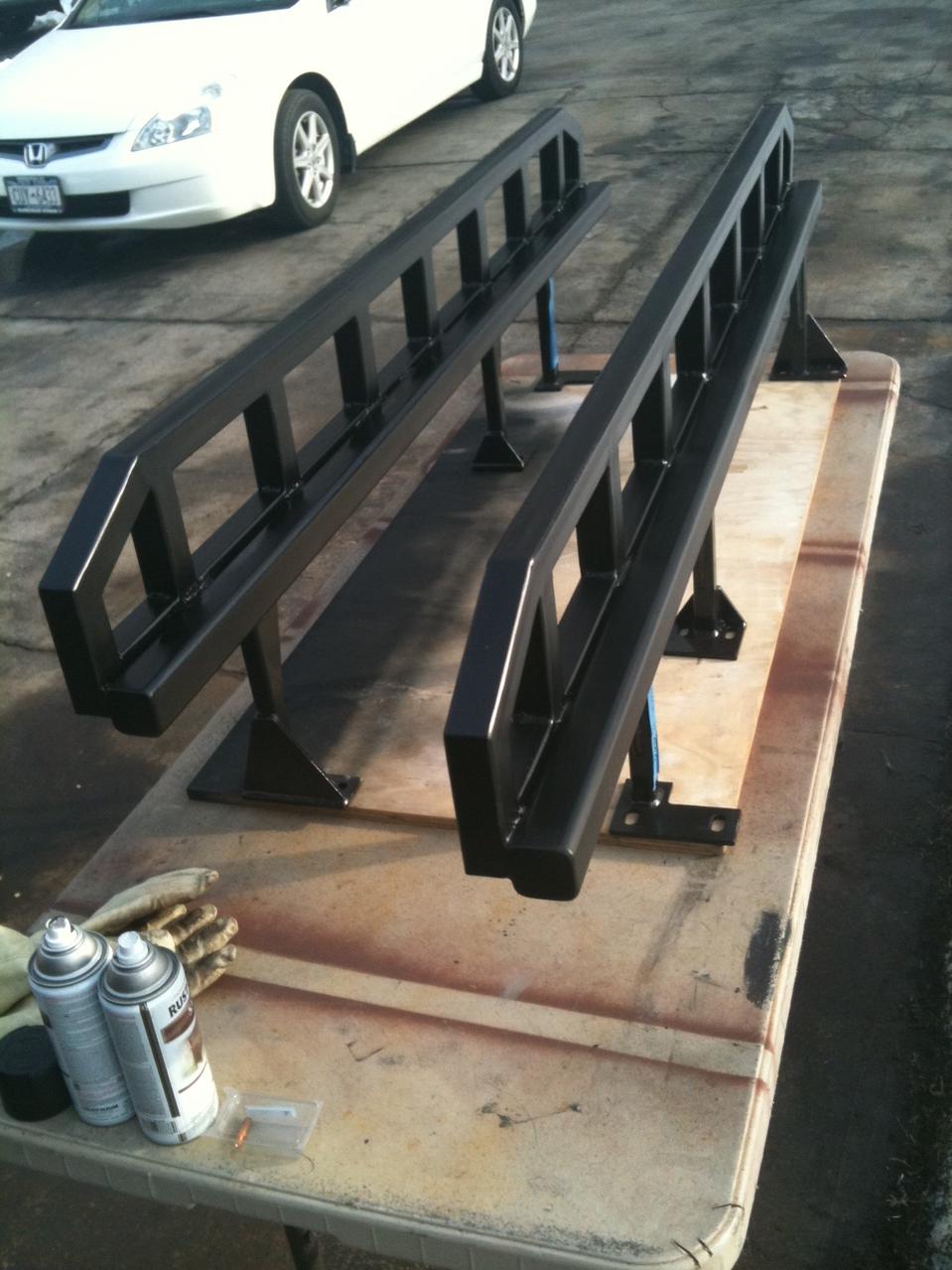

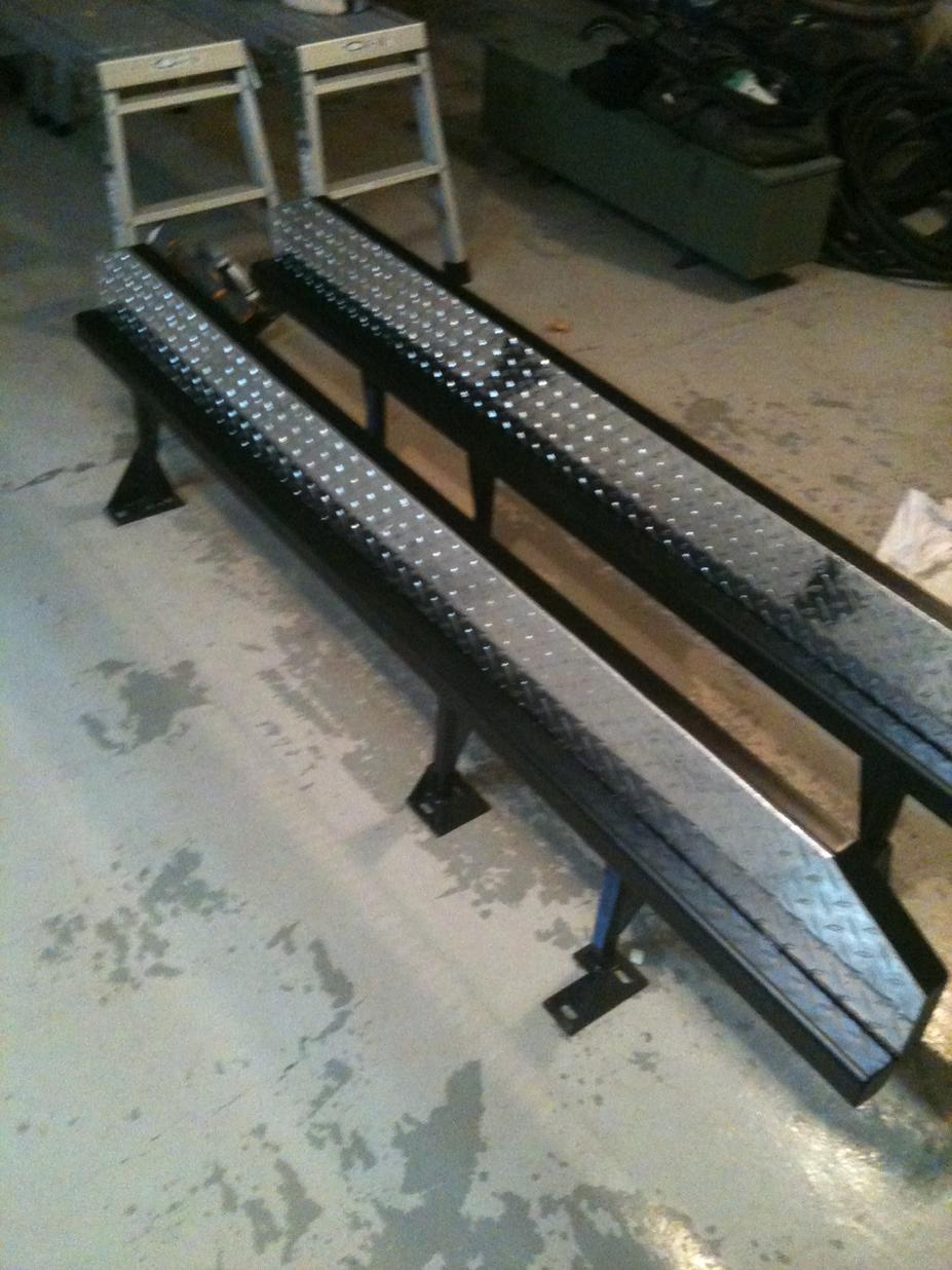

Painted and installed the diamond plate...install on 4R tomorrow.:hungry:

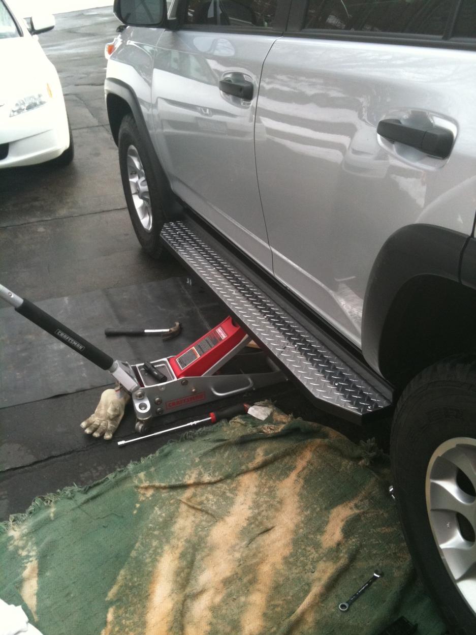

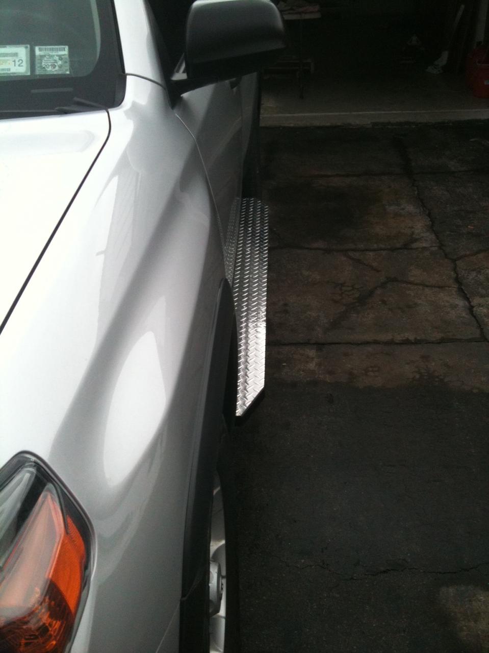

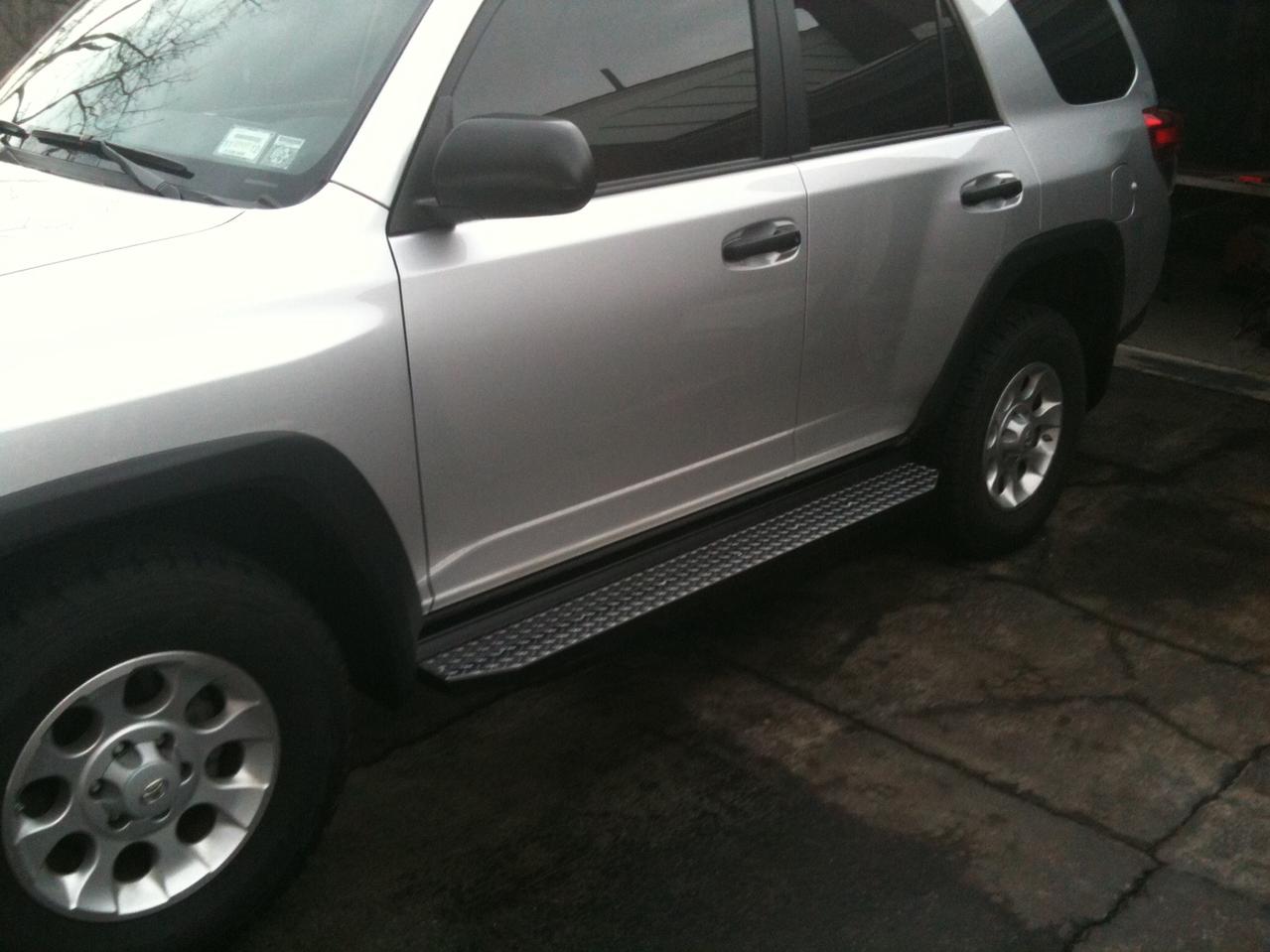

Project complete.:zoom:
I have to admit I'm blown away by the ease of installation on the Rocky Road Sliders. Everything lined up perfect, and the finish work was amazing.
Big thanks to Glen and Charlie!
The step sticks out about 6 1/2" and I wouldn't change a thing. It is about an inch out past the farthest point of the wheel well, and several inches less than the mirrors. Anybody pulling up along side too close and opening their doors will regret it. The finished slider step was about 75 lbs a/p.....but a great "armor" addition.

Looks mean! how much ground clearance did you lose?
Thanks Mike!
I think it came out to about 3-1/2"-4"....but by the time add a small lift later down the line and level the nose out it'll cut that back by a few inches.
Very happy with it, easy to reach the roofrack now and easier to wash the roof.

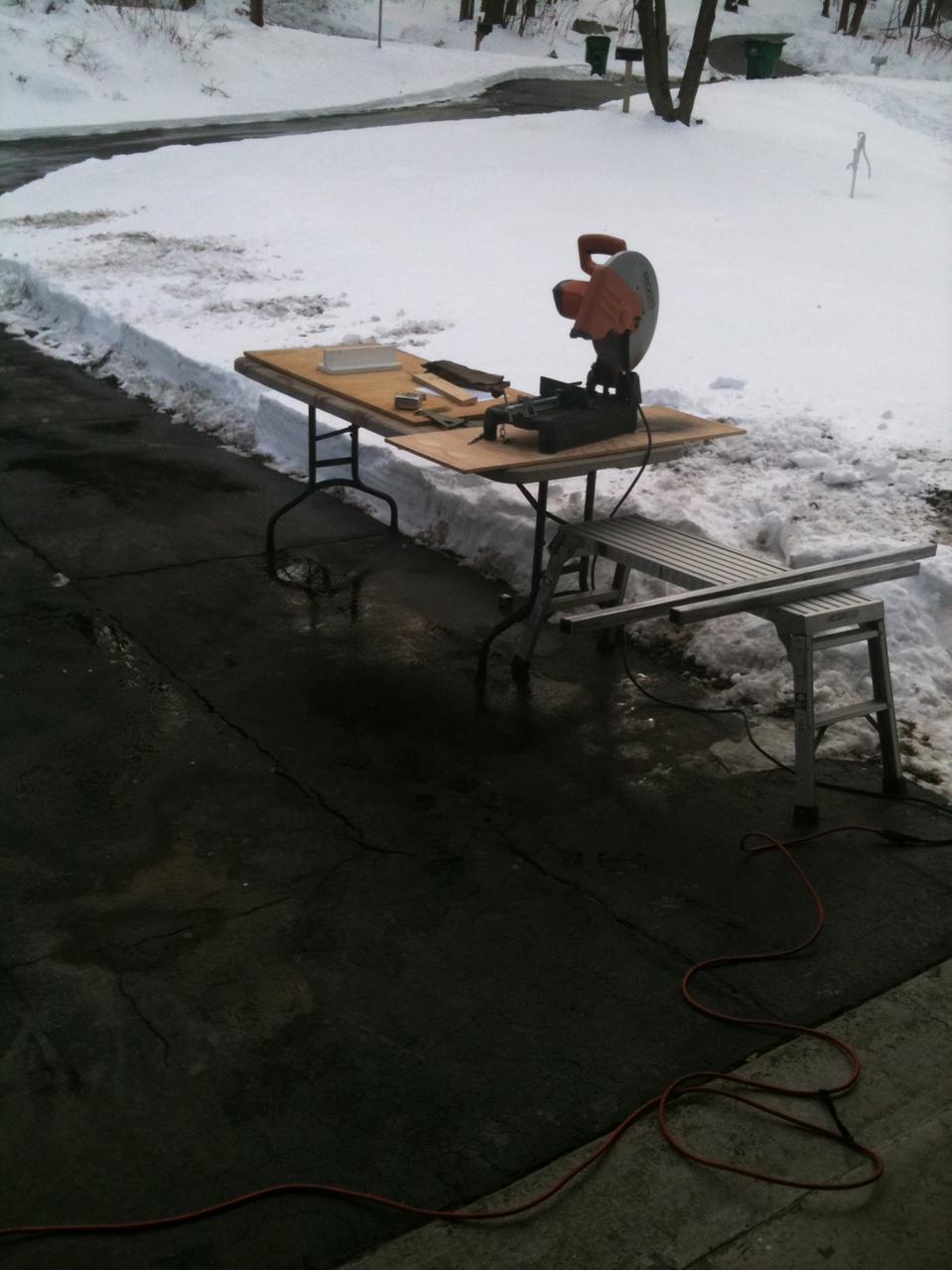

[MENTION=47340]Titanpat57[/MENTION], did you really cut all those pieces with only the chop saw? Talk about accuracy, I can barely cut it straight down with a chop saw, must be the beer, lol.
I think that should be plenty, I just measured my BB sliders and it's only 4" and change and that's already plenty for me to step on, either with my toes or with the side of my foot.
haha!
It wasn't too bad....the worst part was working outside, and we actually had a heatwave those few days...like 40 or so.
