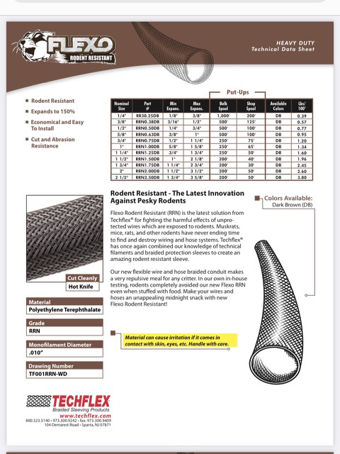

I need to figure out which size I need. The fuel injector wires are actually quite thin. I wonder if this stuff is split so it can be installed easily ? ? Otherwise, it would have to be threaded on from one end, keeping in mind the wires all have connectors on them.
Ehh, the more pics I see of this the more convinced I am that it is not split. Further, a "hot knife" cutter is recommended to cut lengths. I guess this for not really for retail user.
Ooop, found one pic that may indicate the contrary.
What do you guys think ?
Here is one that I like, I'll post the link, image, and some text from there webpage. No I don't work for the Flexo Company ! ! !

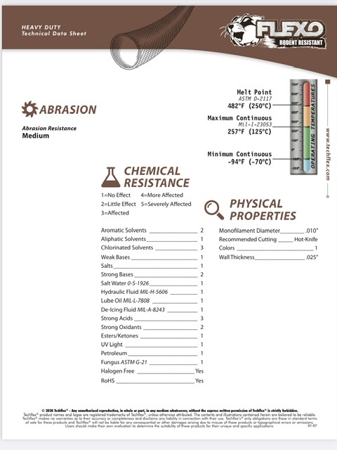

I’ve been interested in something like this also.
I have used regular Techflex braided cable sleeving in 1/4 inch and 1/8 inch diameters for inside the cabin wiring, purchased from Amazon. I wanted to sheath my wiring for neatness and to resist abrasion from vibration. The braiding is polyethylene terephthalate (PET, polyester), made from 0.008 inch filaments. It works well but is not split, you have to compress it lengthwise to expand it and feed the wires through. A little bit of a pain if the wire bundle is thick, but if the sheath is wide enough diameter you can expand it over some connectors.
The Techflex website claims that Flexo Rodent Resistant cable sheathing is unappealing to rodents but doesn’t say how it works. As far as I can tell, it’s the same material as their other cable products, PET. And it’s not split. The only difference I see is that it’s colored brown instead of black. And it’s woven from a slightly thicker fiber, 0.010 inch. Maybe the thicker wall is a deterrent once the rodent starts chewing. They don’t claim to add any chemical treatment to it, like hot pepper capsaicin, but they say take caution when handling, may cause skin or eye irritation.
Kind of confusing. It bugs me when product specs don’t give you enough information. Maybe an email or chat could clear it up. If you find out any more info please post an update.
