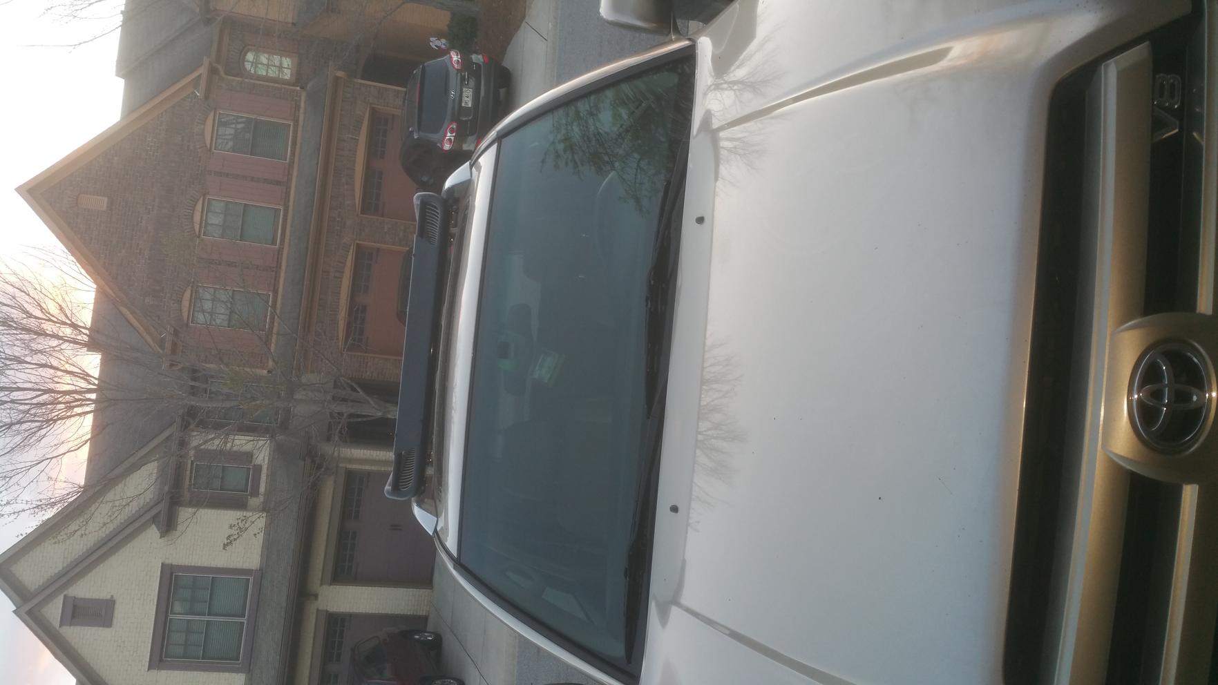

I installed it last night, but the base of the basket at places is touching the roof i.e no way I can open the sunroof,, a bit confused, I need to raise it abut 1/2", did anyone needed a spacer underneath.

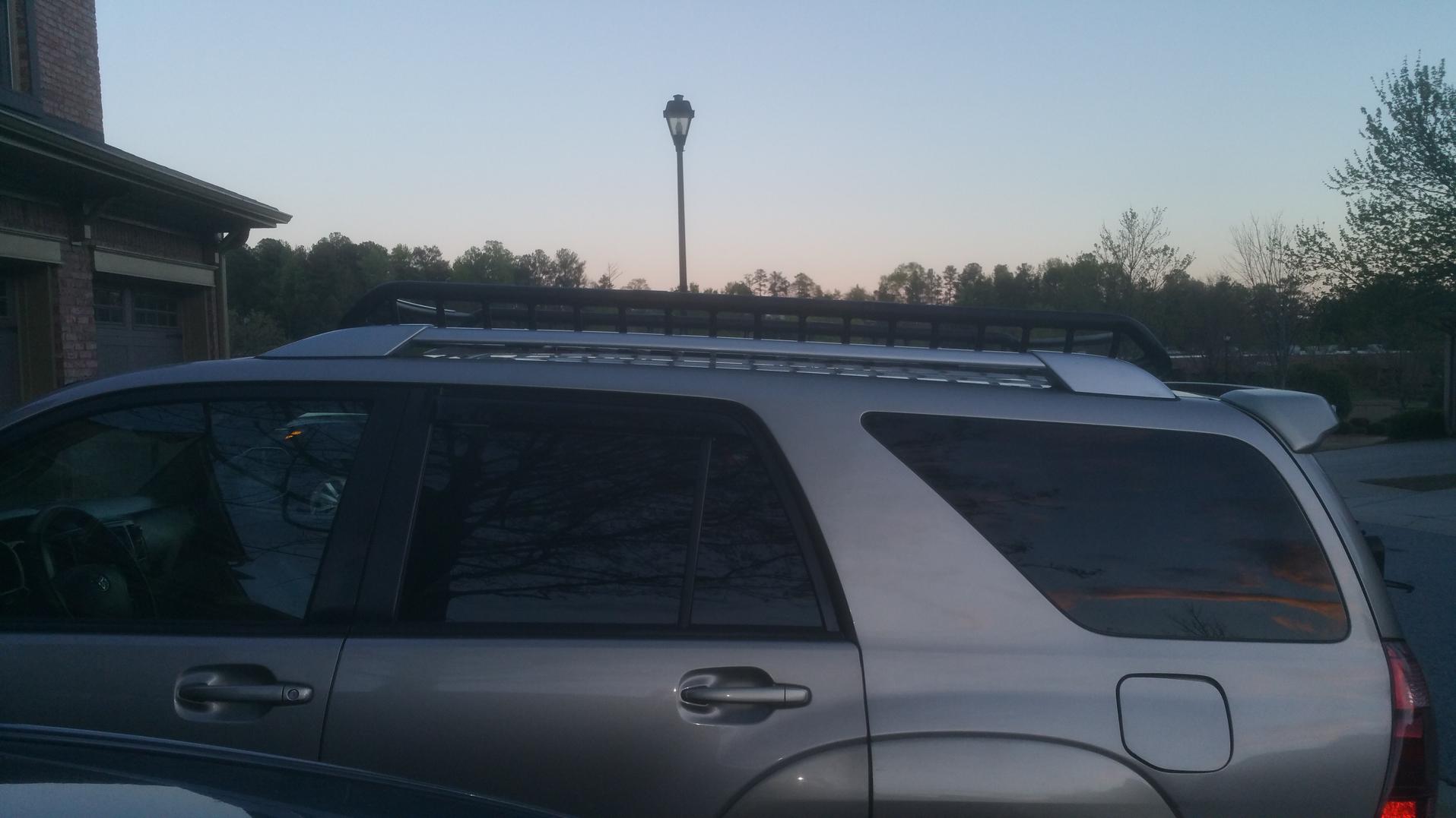

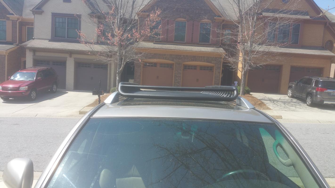

Hey man, I have been wanting to pick this exact setup for my 4runner. I disconnected my Sunroof as it got stuck once and I do not want to deal with it again. Anyway, Would you mind posting more pictures of how the rack looks from multiple angles? Thanks so much!

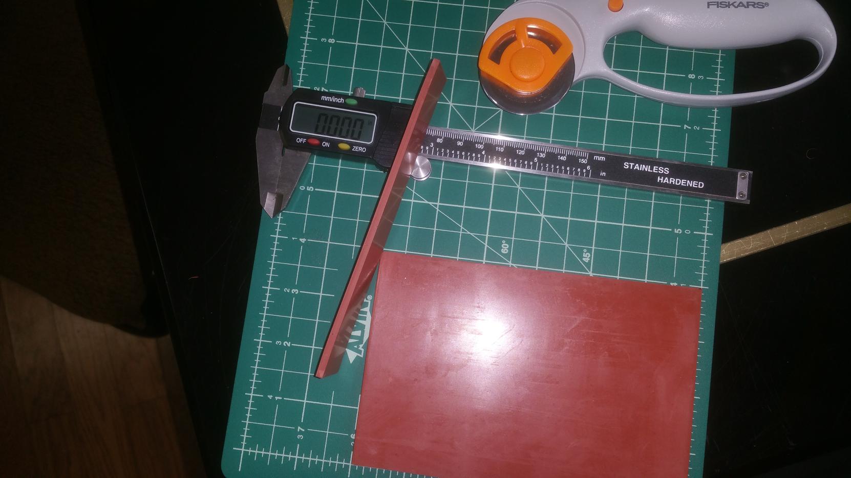

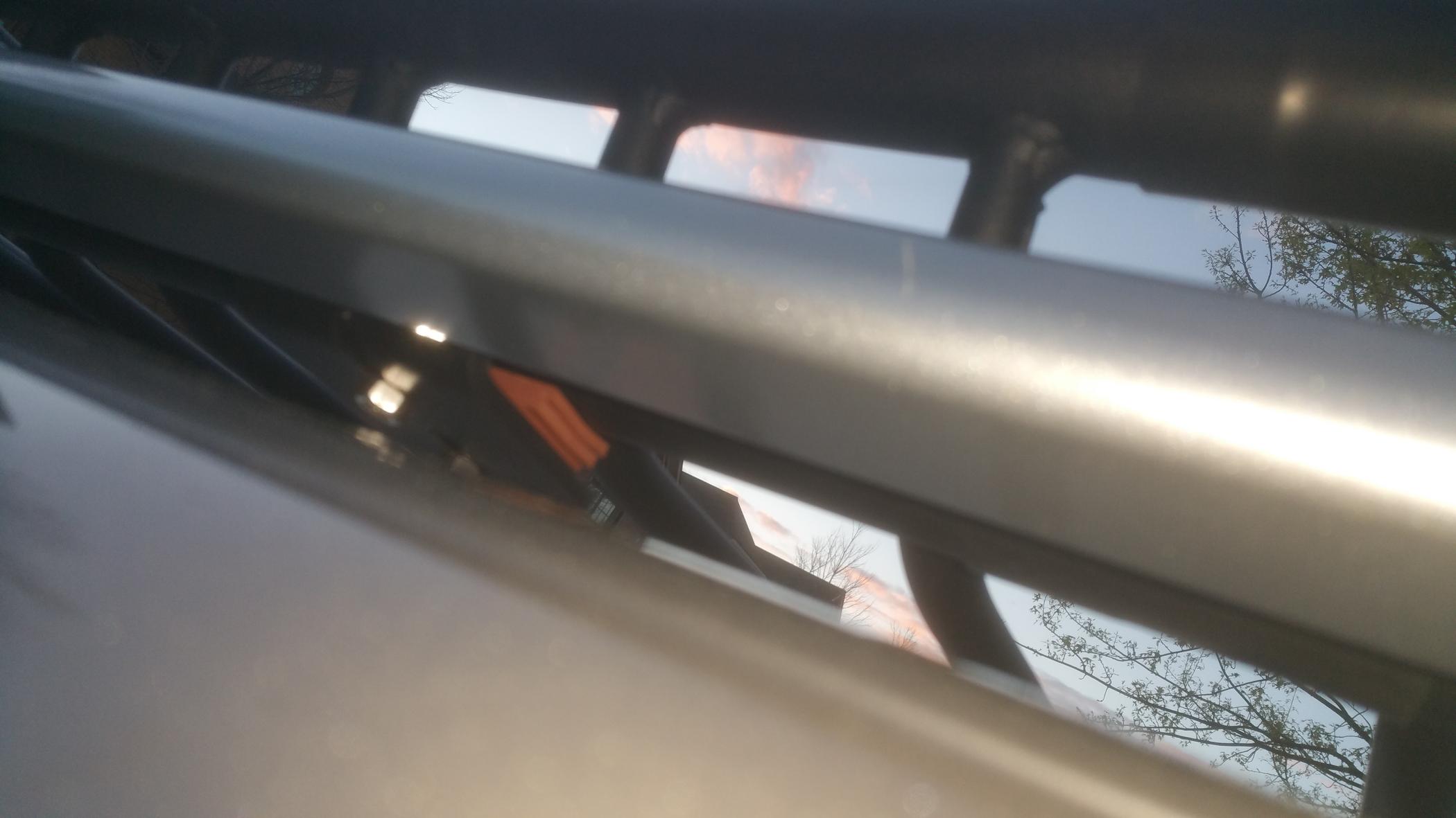

I raised the rack with a 1/8 rubber gasket cut into twelve 1 inch by 3 inch pieces, and slid three b/w each mount and rack so I do not have to flip the mounts, I think it will work with two as well but I want to put weight in it first and see if it touches the roof, if using the brackets as is they will definitely touch the roof...
PICS coming up
