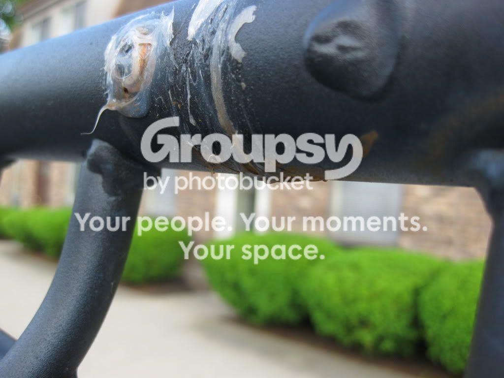

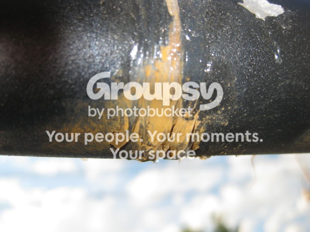

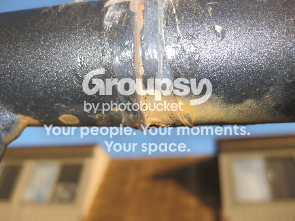

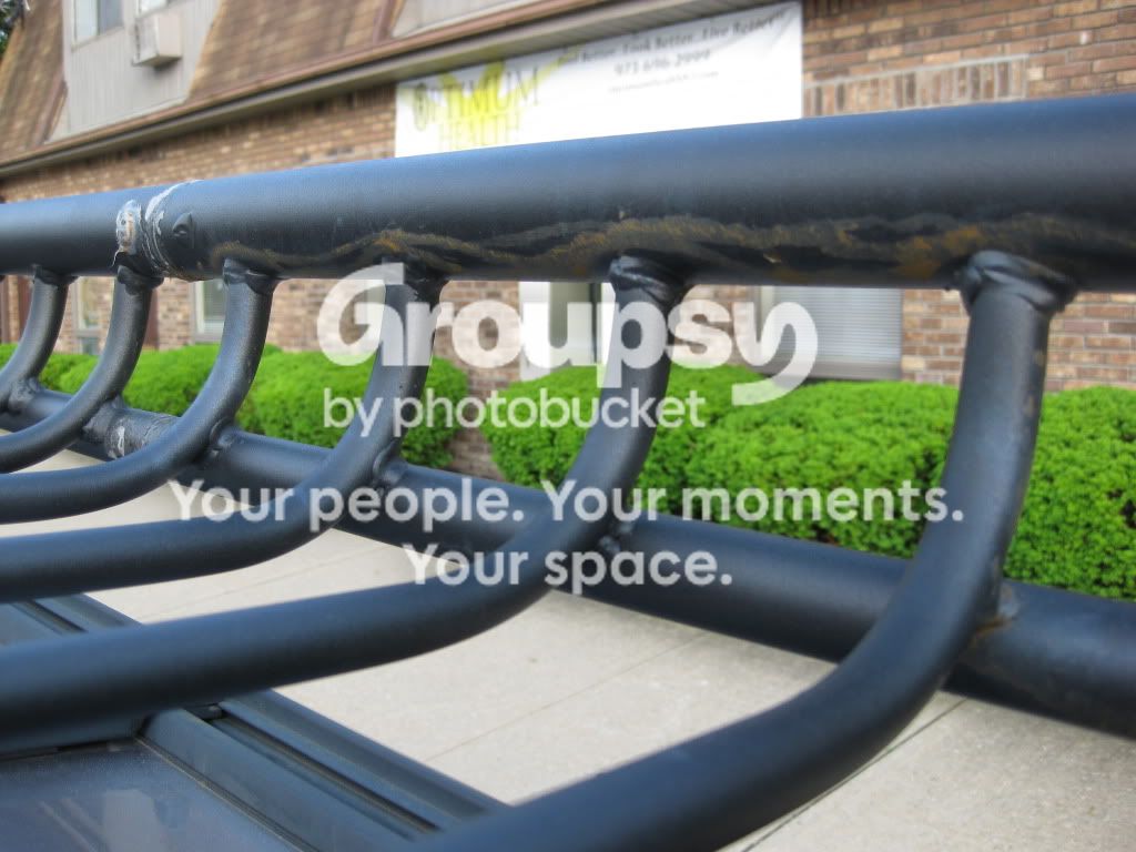

So I purchased a Rola rack for my 4Runner with my Christmas bonus this past January. I installed it sometime in Feb and have been using it since. About a month ago I took the truck out on the highway after a pretty heavy rain storm. When I got to my destination there was a horrible coating of rust colored water all over the roof and sides of the truck:barf:. I had seen some posts about people having similar problems so I went and put a good helping of silicone on all possible gaps. Well its unfortunately gotten worse. I contacted realtruck.com where I purchased the rack from. Not only are they taking the old one back but also sending me a replacement. Great website and customer service BTW. Anyways, how the hell can I keep this from happening again? When I used the silicone last time I did it while it was assembled and on the truck (see pics). Anyone else have this problem? :mad:

Sorry to hear about the BS you're going through with the Rola. Glad you got some pics up, those welds look like :toilet: I was thinking about ordering one!
Had the same issues, here is what I did......
Unmounted it from the truck and cleaned everything up.
Let it sit a dry for a few days.
Reassembled and used shower chalk around the part that mounts together and let set.
Painted with Rustoleum, 3 coats and 2 coats clear.
Put wind deflector back on and sealed those screws with shower chalk as well.
No issues as of yet. Multiple cash washes and rainy days.
Quality on these things is pretty poor but its expected for the price.

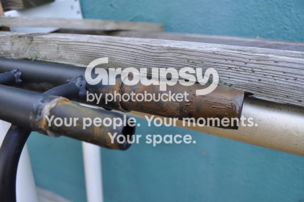

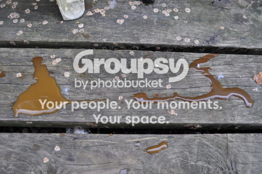

So I took the rack off the truck today to get it all packaged up for shipment. This wonderful concoction poured out all over the place....
DSC_1407.jpg~original
And the inside looked like this....
DSC_1408.jpg~original
Ughhhhhhhhhhhhhhhhhhhhh................ and I was even thinking of getting the extension. Lame! I might just take the new one when it comes, craigslist it, and by something else. Ideas? :D

Hate to see this happen to you. Unless you feel like spending $400+ I would probably take the new rack and seal it up really good. It looks like you did a good job on the first one, but I guess use even more.
It's hard to beat this rack for the price.
I was thinking about getting the Rola rack because the price seems good, I guess you have to clearcoat the hell out of it when its new and hope it doesn't rust and seep that sh!t out.
What about using a rubberized rocker coating or bedliner? That stuffs pretty thick and would definitely seal any voids. More scratch resistant and less upkeep than paint IMO.
