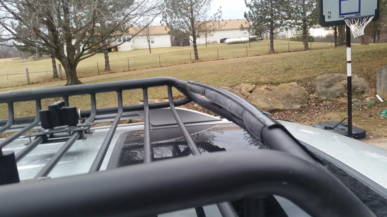

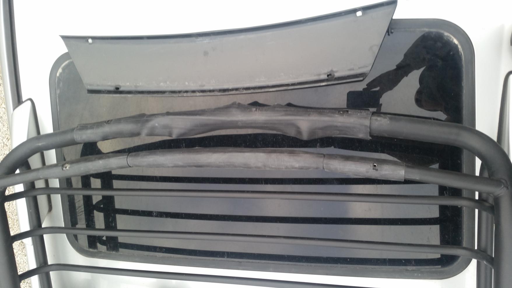

Heres a few photos after I completed the job. I hope this helps my incoherent babbling.:noidea:
The plastic deflector vibrates against the metal bars its attched to on the rack. This is where the go awful humming is coming from. http://www.toyota-4runner.org/attachment.php?attachmentid=236634&stc=1&d=1485731736
I pulled the deflector off and simply wrapped the bars on the rack with a bicycle tube. http://www.toyota-4runner.org/attachment.php?attachmentid=236638&stc=1&d=1485731736

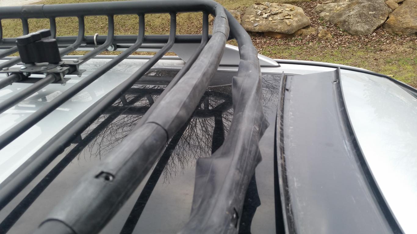

This is looking down on the rack after the tube has been attached. I cut the tire tube down the middle to open it up and wrapped it around the bars on the rack. The tube did not want to stay on the bars when I was putting the deflector back on so I used a touch of super to hold them in place when I installed the deflector.

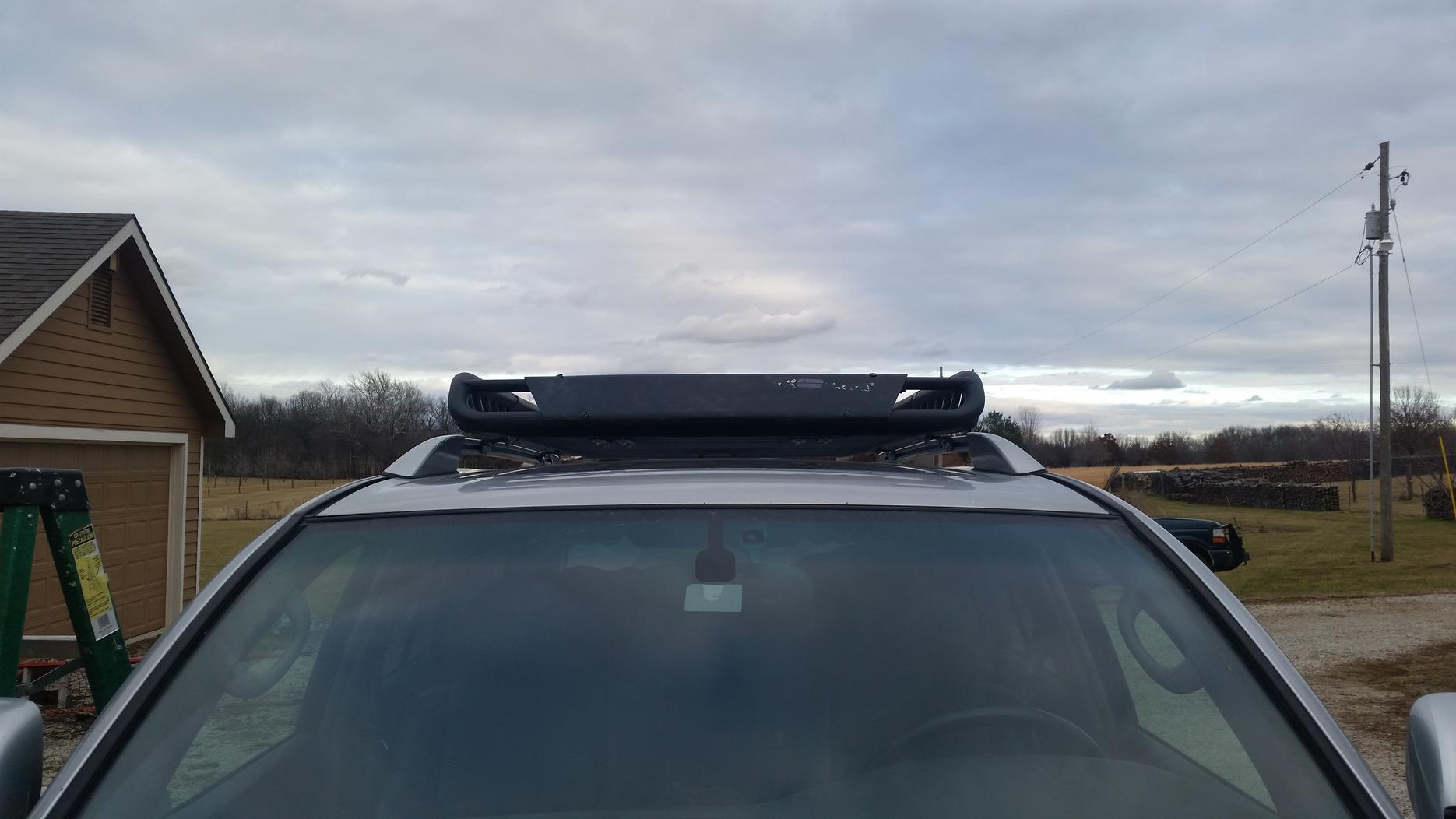

This is looking at it with the deflector back in place. The tube really isn't very noticeable at all. I may trim off some that excess hanging down.
http://www.toyota-4runner.org/attachment.php?attachmentid=236635&stc=1&d=1485731736
