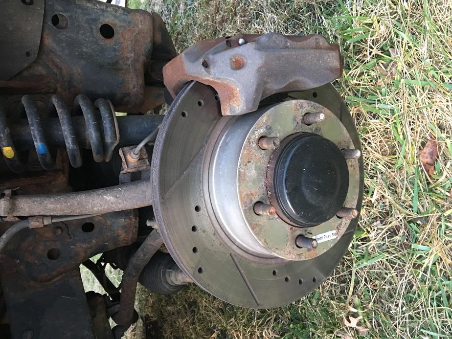

I got the front wheels off to figure out why the front had 16" wheels and the rear had 15" wheels...
I guess these will make their way over to my 4Runner at some point.... but as of right now I am going to spend the week taking as much off this POS as possible and then the big thing is trying to figure out what to do with the frame / shell once it is stripped
