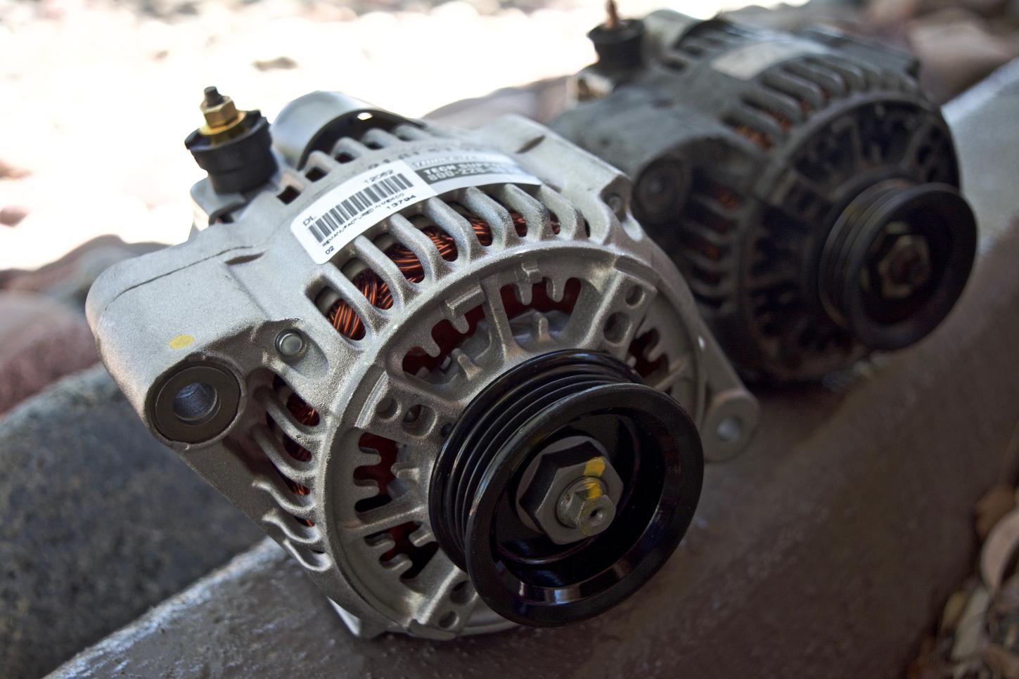

new alternator photo
here is the new one vs the old. still working on the video!

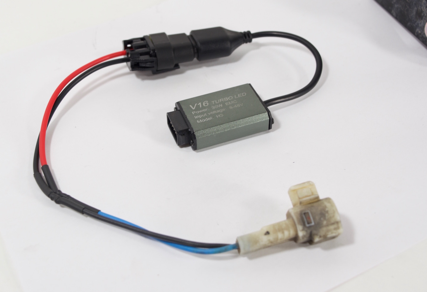

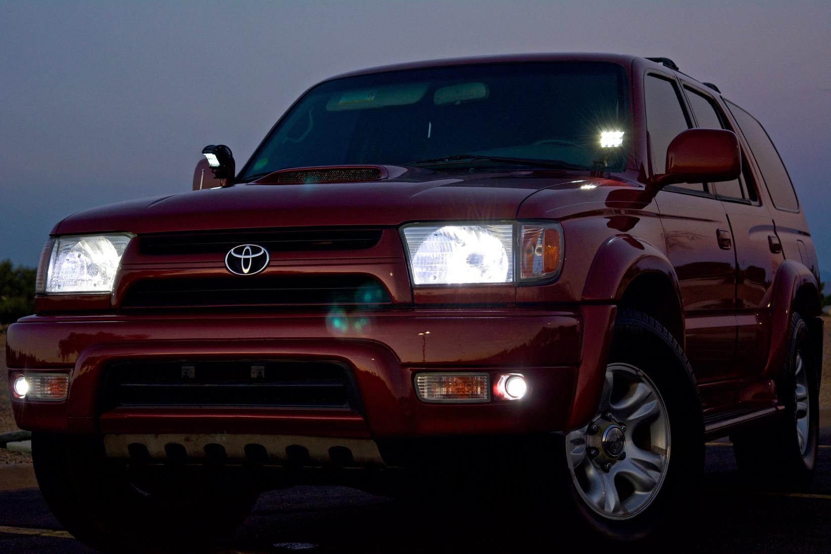

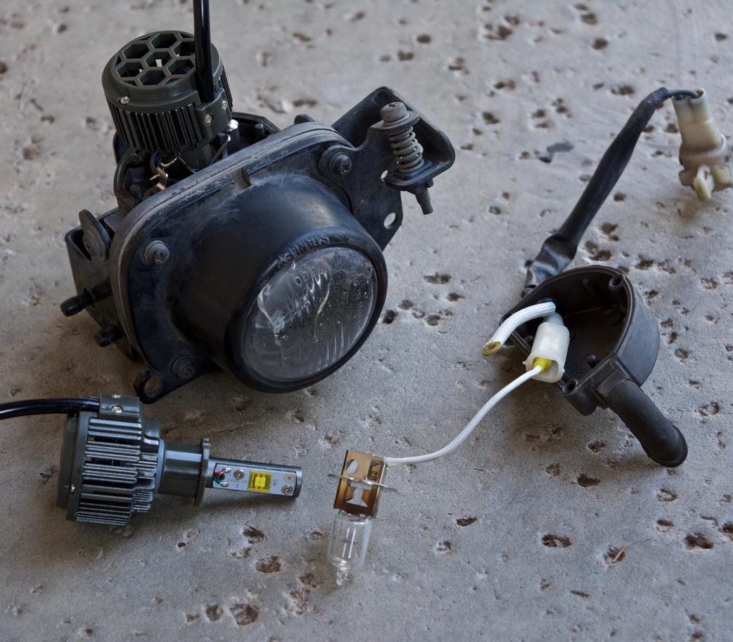

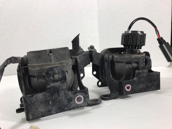

how did you retrofit that led into your factory fog lamp? thanks
Hello,
its was a bit tricky that is for sure. Im working on a video to show how i did it too. You remove the part that has the bulb and cut its wire that has the connector off. Then splice / heat shrink it to the extra wire in the led kit and then connect that wire to the ballast . To secure the bulb in the housing , you need to bend and manipulate the metal clip that holds the bulb. Thats all! The Bulbs are water proof while operating too so there is no issue there.
