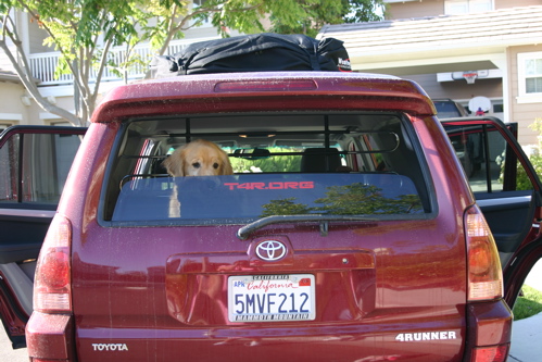

I originally bought this for my wife's Expedition. However, once we got the 4Runner we took it to Mammoth instead.
It is a Weathertech Rack Sack. I had to remove the little plugs at the beginning and end to slide the cross bars as far as possible apart. The Rack Sack fit perfectly between the bars and on top of the roof.
It has two zippers and you can open three sides. There is an overlap to protect the zipper from the weather. It has all weather styled material.
There are just four clasps. You simply wrap them around the cross back and pull up the slack. You then roll up the slack and use the velcor ties to keep the slack from being buffeted by the wind and hitting the roof.
You can really cinch it down tight. I took my wife and two kids to Mammoth. All of our stuff goes on top in the Rack Sack. Dog gets to go in back.
Easy on and off. When done can just hose off and fold up.

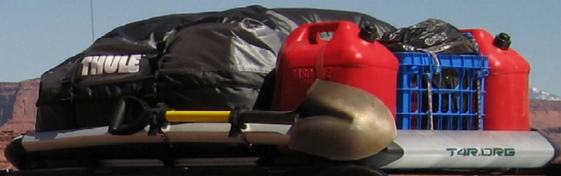

Thule Expedition large basket and Playpen Pouch that I ran recently offroading in Utah

This is kind of off-topic but I noticed the plastic gas cans on the roof. I am currently debating between buying plastic gas cans or making the investment in metal. On your expeditions, do you ever feel unsafe with the plastic. I had some plastic ones a while back and always felt uneasy because they always expanded like crazy with sun exposure - made me feel like it would explode.

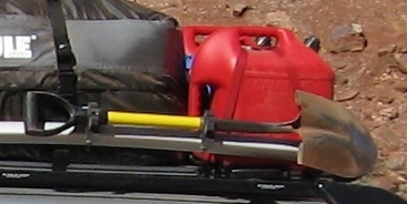

The plastic ones are built better nowadays. The key is how the cap seals so that they do not dribble gas on the roof of the truck. Don't buy the ones with the little air vent as those leak. I drove over 100 miles offroad in Utah and never had a problem with the ones I bought. Got them at Target for 1/2 the price of the auto stores.
Buy the one-piece blow-molded cans. The ones that are molded in two halves and fused together seem to fail after a while.
Mounting is important too. Don't let them bang around or rub against hard edges. Mine were securely strapped down.
The metal ones are a lot heavier and I did not want to waste cargo payload as there is a limit to what you can put on the roof. If I had a killer bumper to mount cans on I would use metal just because of worries about getting rear-ended.

Thanks for the info. Very valuable.
