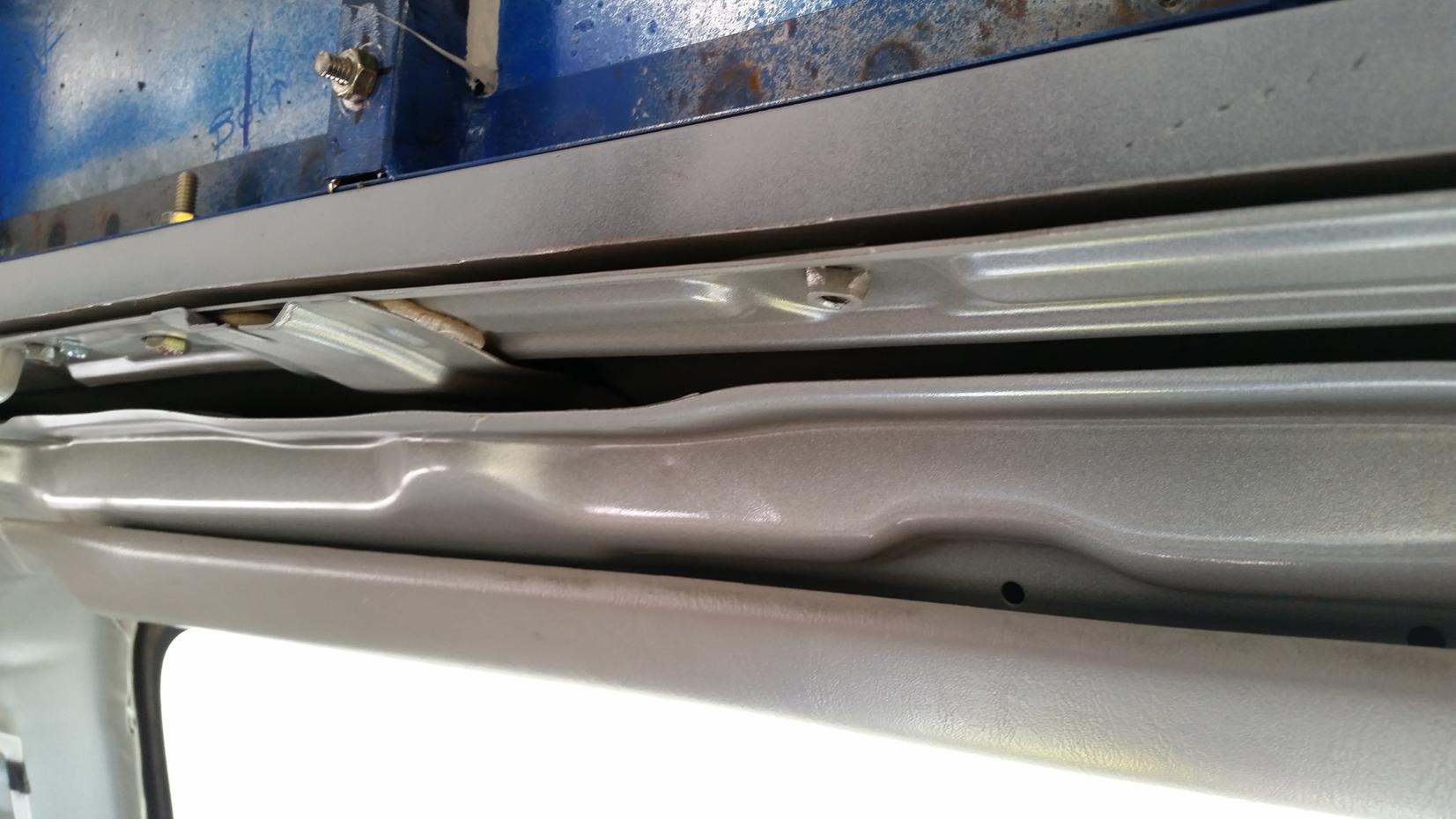

I cut the roof off one of mine so I've had a good look at how it's re enforced, or not as I've seen. I grabbed a pic over the rear window by the tailgate. The re enforcement strip is under the roof sheet metal, but it is not attached to the unibody. That may be where your roof is flexing.
