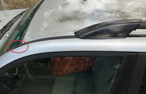

Great idea! I believe that I found the problem area. The leak appears when I apply water on this circled location or behind the rack mount. Time to find new seals.
Nice. Post back if you find/replace the seal, I'm thinking this is going to become more and more necessary. Although it's not leaking, my seals are buckling like yours on my 2008...

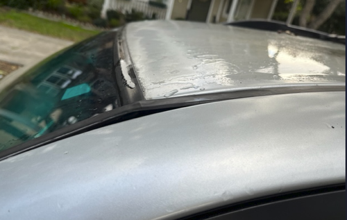

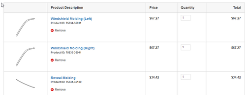

I found it for my 2004. These pns may not be the same for other models. I am going to get 3 parts. Left, right, center reveal.
I'm just guessing here..BUT those moldings aren't going to completely reseal where it's leaking, it may require some sealant under them to stop the leaking...But I could be wrong.

Good find, you think the water is going underneath the windshield? if so the adheasive to the windshield may need to be looked at.

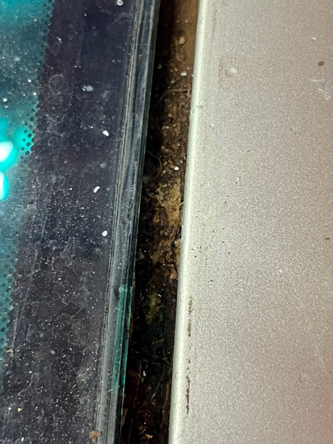

Not too be over critical but clean your roof.and areas around it. If the painted areas look like that, under the moldings could be worse. The areas under that molding do not lead into the vehicle unless you have rot or missing, dried out urethane. Also unless you park on an in cline with the back end facing down that area would leak on the dash not the console or seat belt. Remember water follows the path of least resistance.
I've had those moldings off many times and there is nothing under there, it's just trim. If you are leaking that high and in that area, my guess is under the roof rack rail moldings is dirty and it's blocking a path for water to flow and its backing up somewhere. Also take out the silicone and use Strip Caulk by 3m or some equivalent product. Strip caulk is what Toyota used. Silicone was not made to be used in that area and there could be a pinhole somewhere in the silicone.
I took my roof rack off to put on a Sport rack and under the moldings was beyond filthy.
I had a windshield person take a look at it and those moldings on the outside of the windshield are not a water seal, they are cosmetic. There is urethane/sealant that goes around the windshield that I cannot see. There may be frame rust under the windshield. There may be a break in the sealant adhesive where it was not seamed properly. Only way to determine that is to remove the windshield which may crack when they do that. I did notice that under the roof rack was very dirty. I cleaned under the mounts but could do better elsewhere. I may take the rack off completely and put the plugs in.

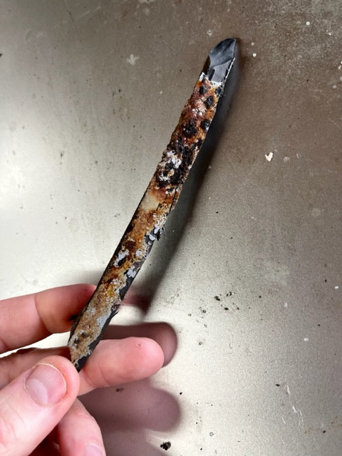

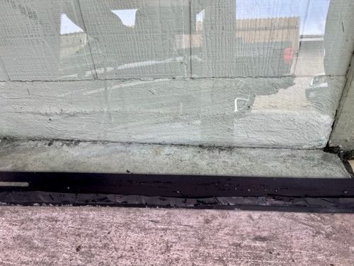

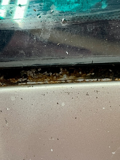

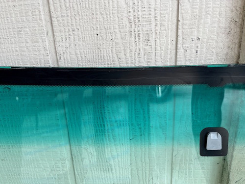

Pretty sure we found the root cause for my leaks....crapping adhesive sealing on the window replace many years ago. As soon as he pulled the urethane out he could see rust at the top. When he got the windshield out there was no adhesive sticking to the top edge like there was at the bottom. Thankfully no rust holes in the frame. The technician cleaned the rust, applied primer, and put in a new (hopefully properly sealed) windshield for $328 (glass/labor/tax).
It's supposed to rain tomorrow. We shall see how it goes. Thanks for all the replies.
Top edge frame rust under urethane
Piece of old urethane, rust stuck to it
Top inside glass, no adhesive
Bottom inside glass, adhesive stuck
