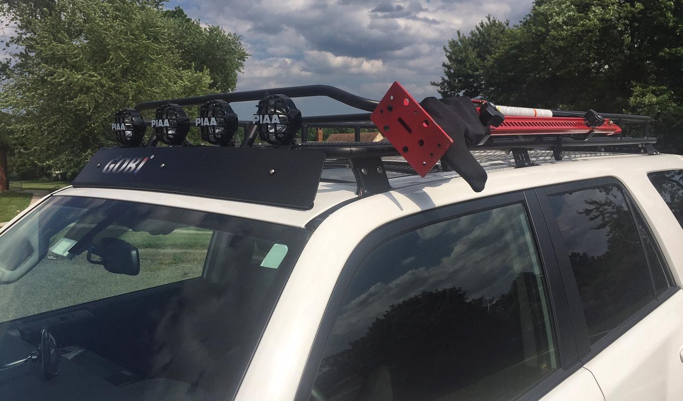

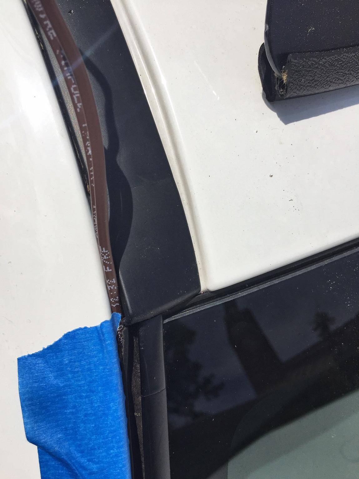

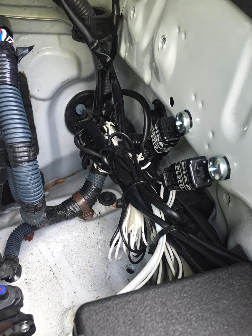

I installed my PIAA fog lights by routing the wires underneath the windshield side molding. No drilling through the roof. There is enough space underneath the molding for 2 sets of 2 x 18 gauge wires.
