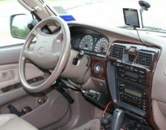

i have the cobra 19 and mounted it between the steering wheel and radio. I wired it to be portable so it is plugged in to the cigarette charger, and I ran the antenna cable under the driver's side door sill trim and up the pillar, out the passenger door even with just past the moon roof. I have a magnetic roof mounted antenna.
