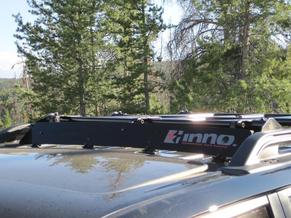

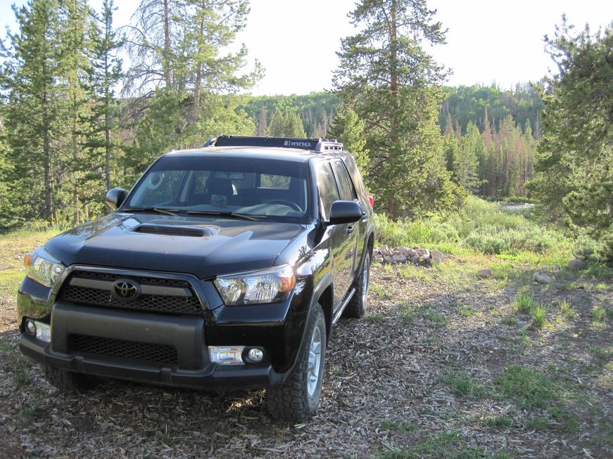

I added a Inno fairing to my Rocky Road roof rack. Got rid of wind noise (only tested to 80 mph). I noticed howling at around 70 mph prior to the fairing. Fits perfectly and I am very pleased. Also, mpg's are back to where they were without a roof rack (and rock sliders) installed. I had to use zip ties on the middle bracket because of the center crossbar on the rack. However, it seems pretty secure.
Edit: Also, it seems to track much better, like night and day. Even over having no rack. Not sure if it's just in my head or what, but it used to feel like it would wander quite a bit.
The pictures were taken in the Uinta mountains.

the Rocky Road rack looks slick. that shorter profile may be just the ticket to squeeze my rig into the garage after it's been lifted! (which is some time off, but still...)

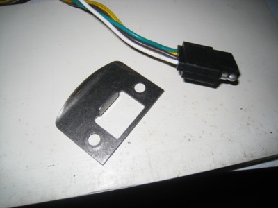

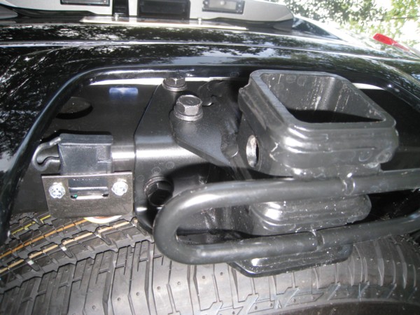

Quick Jerry rig. Used an exterior door strike plate to mount a 4-pin vehicle-side plug just to the left of the hitch receiver. The door strike plate has a tab on the back that sort-of fits right onto the back of the 4-pin assembly to keep it from sliding backwards when you push your trailer-side plug into it. Had to drill two small holes on the under side. Used regular drill bit and sheet metal screws. Just ran a short 4-wire line from the existing 7-pin hookup up and over the bumper frame. Didn't even hard wire that...just used the 7-pin to 4-pin adapter. This would only work for a 4-pin rig. If you wanted 7-pin, I am not sure how that would fit. The ones that they make aftermarket are too wide to fit in this spot without cutting. I don't use 7-pin so I dont really care on that...but would like to know if someone has done it. Please note that this is only a quick fix, and not really professional!
