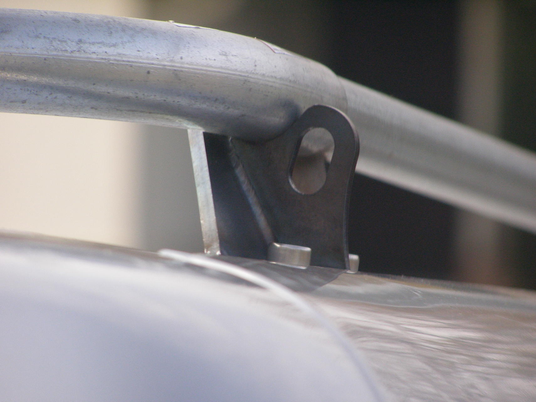

Just 2 pieces of metal welded and have another welded on for support.
the rain drain is about 1 in deep and 1 in wide. So you would need a sleeve or tube to compensate. See how the bolt heads are visible so he used something to raise it up. shouldn't be too hard to get up and you should see how some members welded their role rack to the stock locations.
