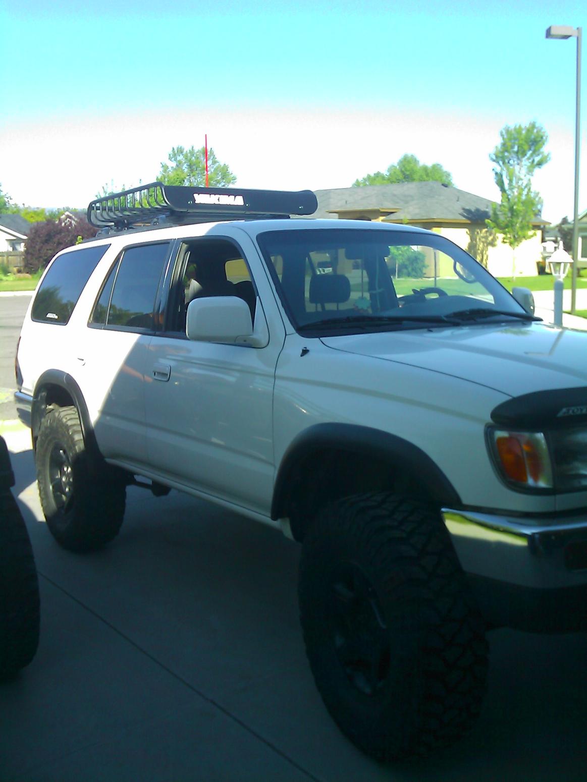

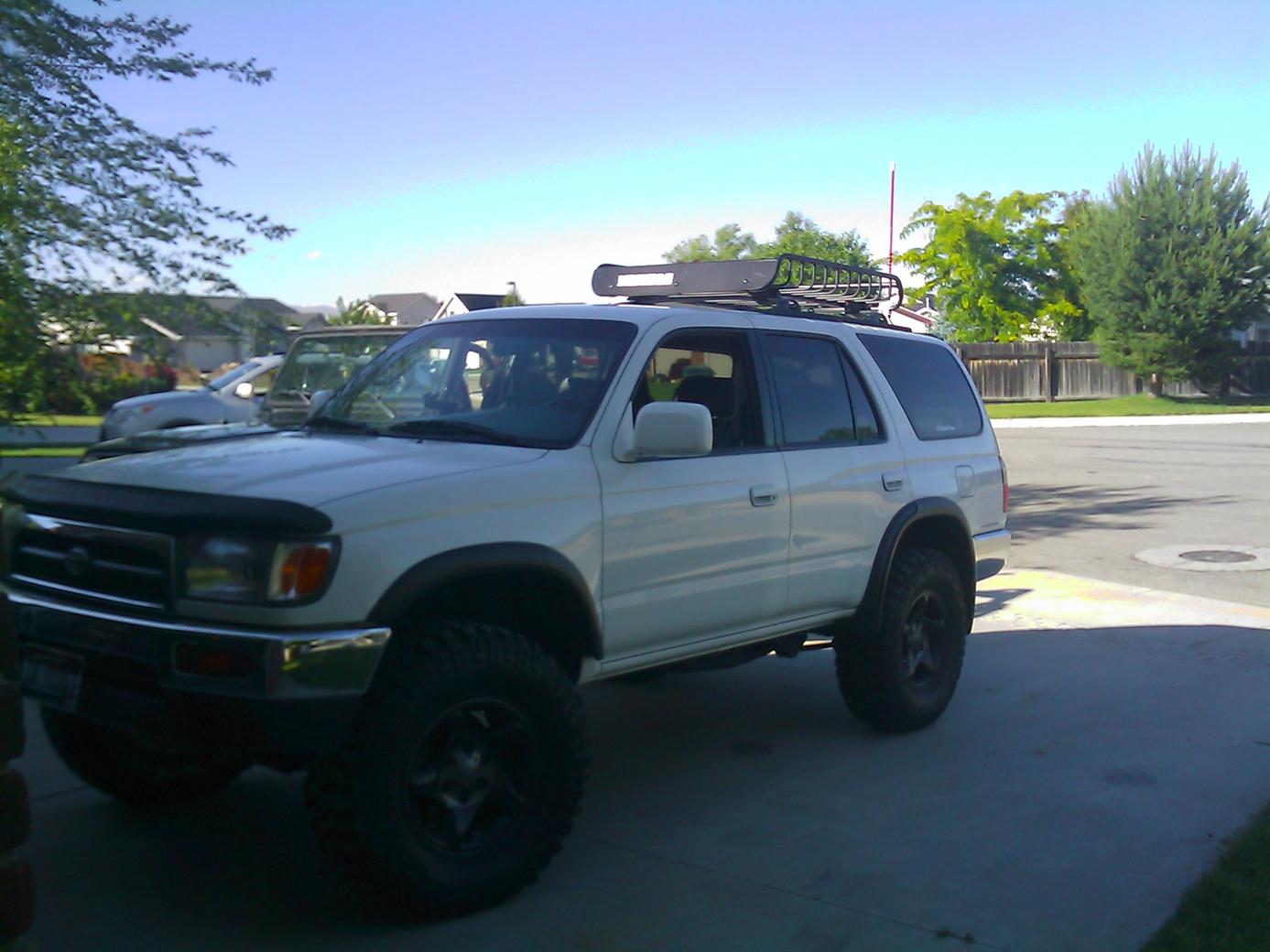

Roof Rack, CB and Firestick installed.
Toy4ever
The title tells the tale. Heres the photo's.

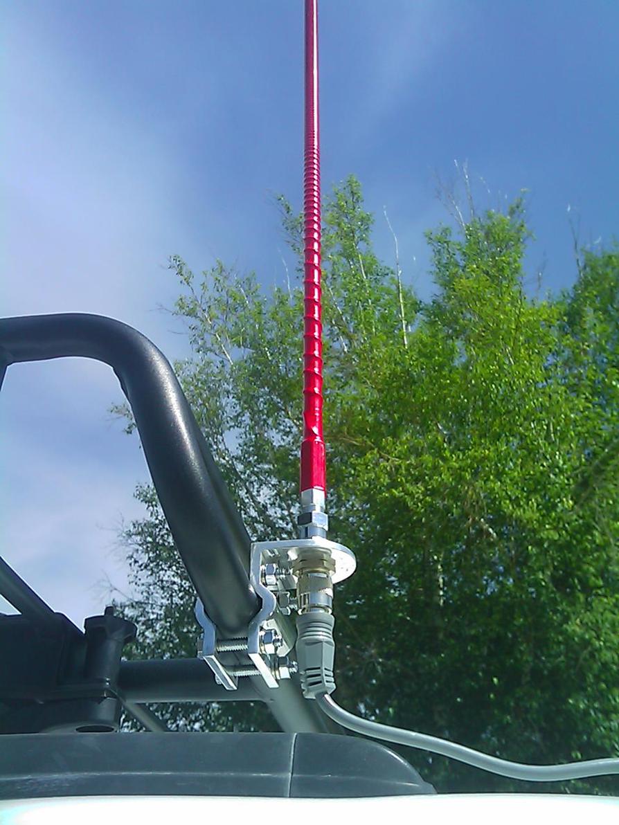

I want some better pics of the CB and antenna. Where did you mount the antenna? The rack looks nice! :girl:

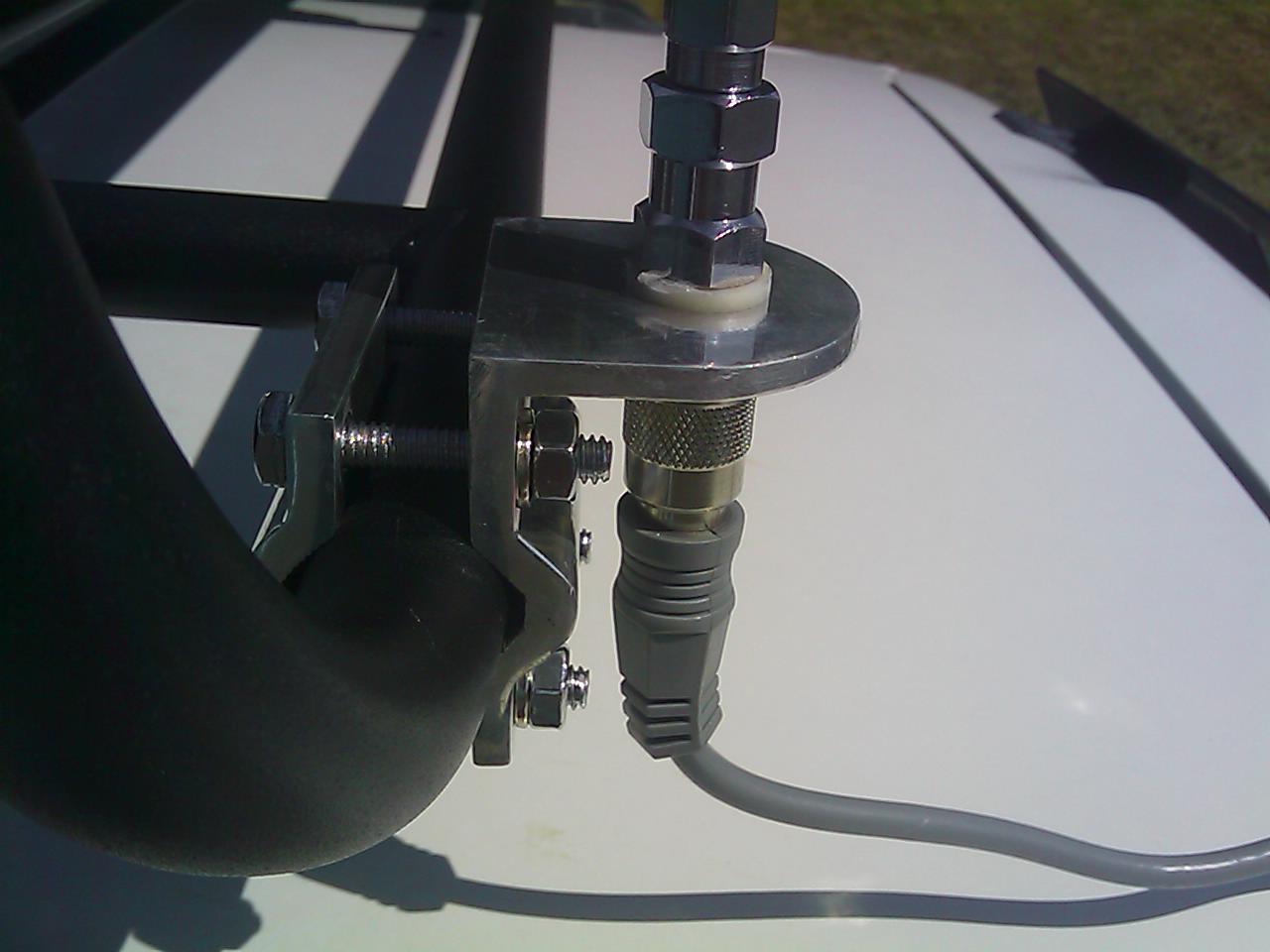

I used a radio shack bracket to mount the firestick onto the back of the Yakima Rack. Ill post some better pictures for you in a minute :)

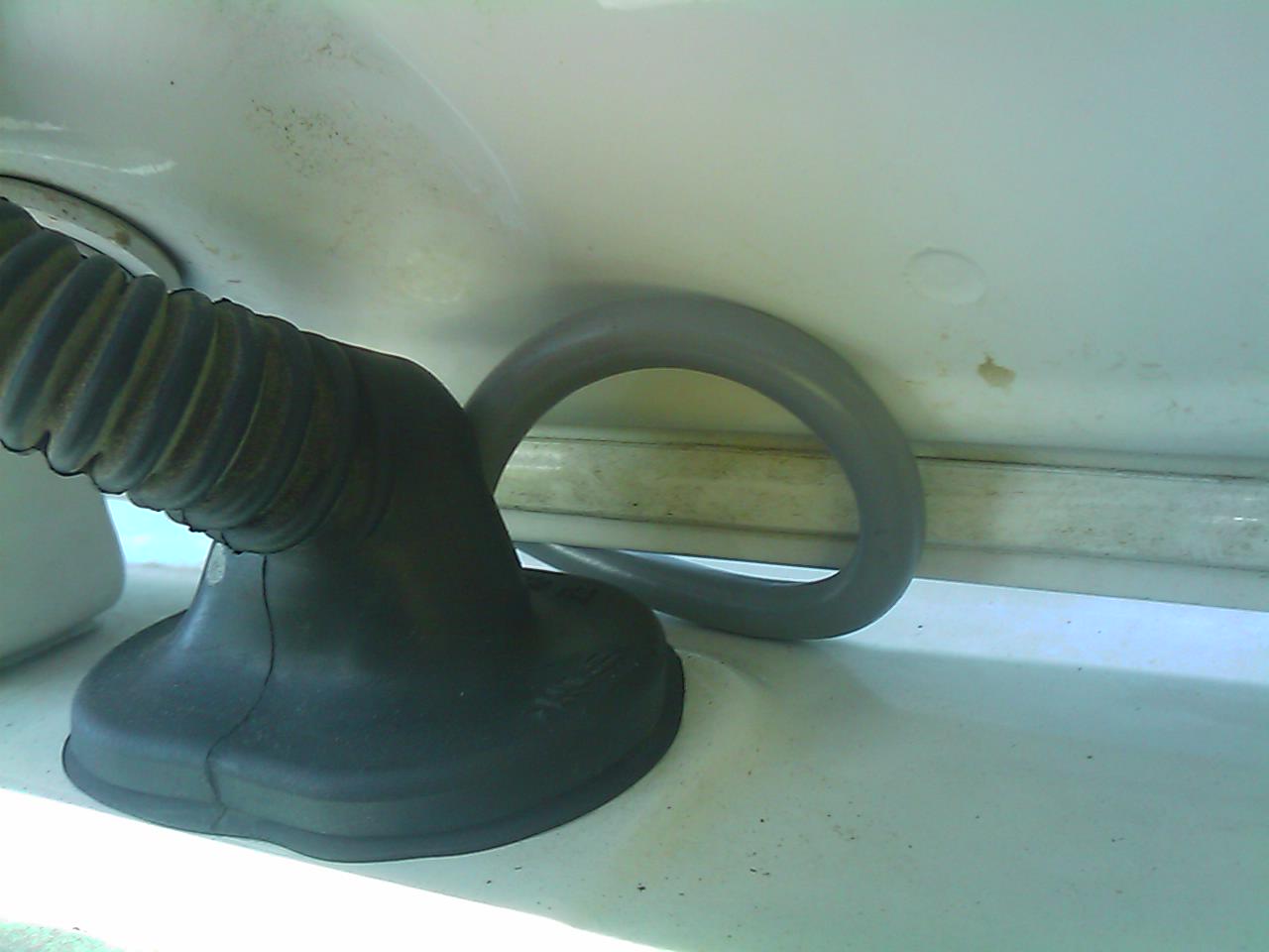

Heres some closer images. I still need to get the spring for the Antenna so its not so stiff but its all a work in progress and in the meantime i can just unscrew it and put it under the back seat when i need to get in and out of the garage.

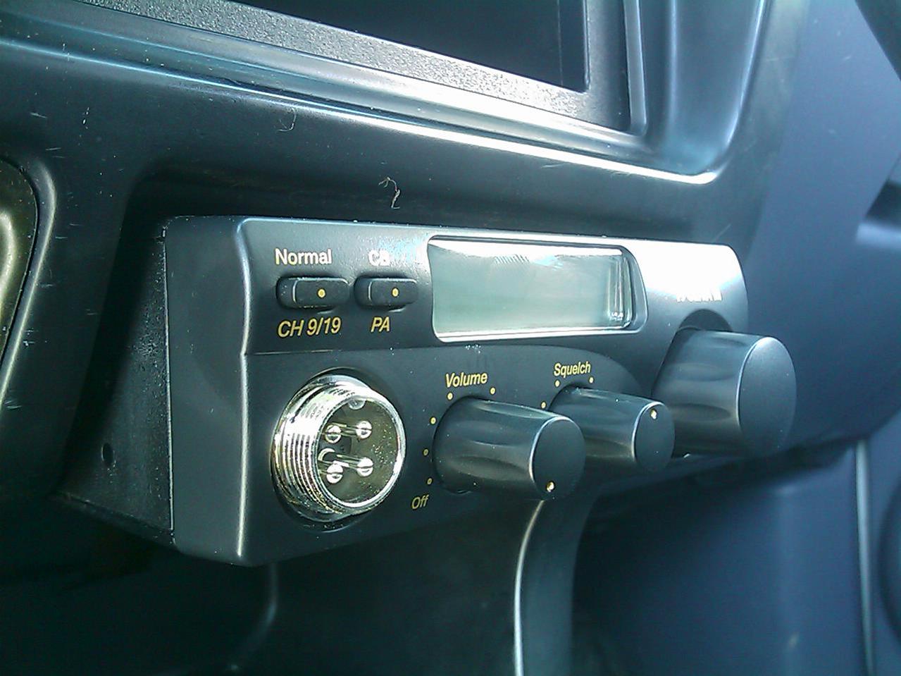

The CB was installed following the advice of some other threads and removing the ashtray. I had to dremel out the back of the dash mount to make it fit but it came out perfect.

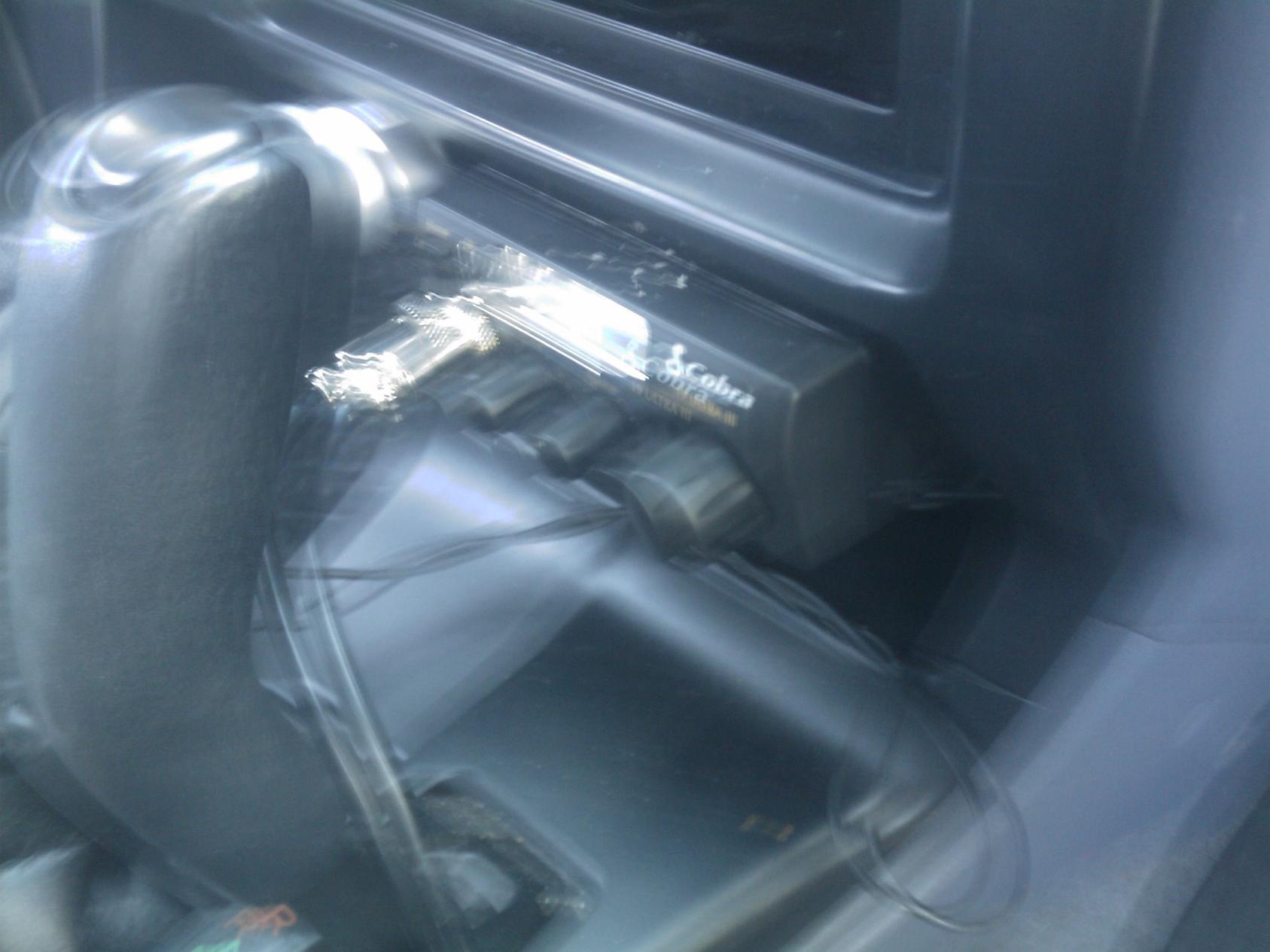

You can see on the back that i made a small slit through that seal and pushed the coax through there. I ran it along the left side of the roof and it seated perfectly.

Yeah the install was pretty easy all things considered. I picked up the mount from Radio Shack for $20 but they are alot cheaper on amazon i just didn't have the time (maybe i am impatient). Let me know if you have any questions.

If I can make a suggestion, from working in radio for 40+ years, I'd recommend that you put some weather proofing on the PL-259 (antenna connector) where it connects to the bottom of the base. Water is an enemy to RF!
I noticed you are in Boise, so I'd recommend Scotch 33 tape or better yet, Scotch 66. 66 has better cold weather properties.
