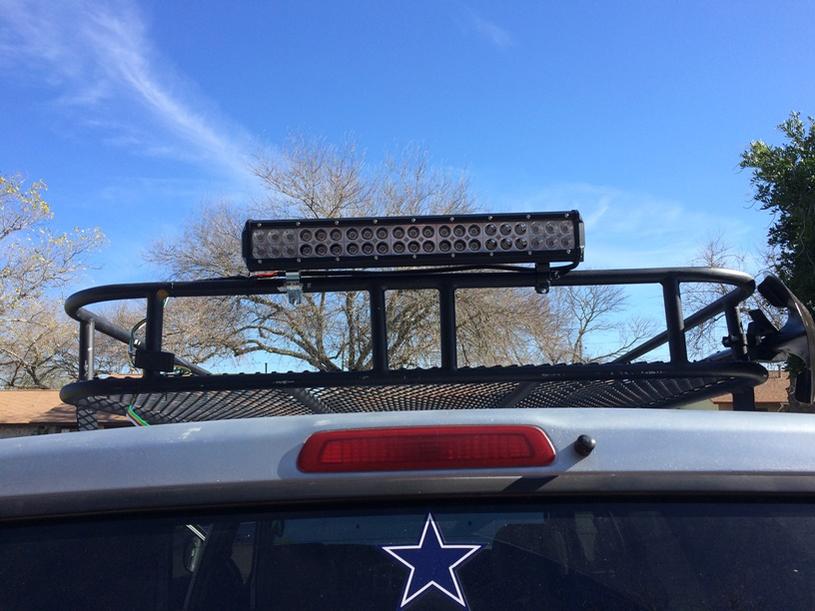

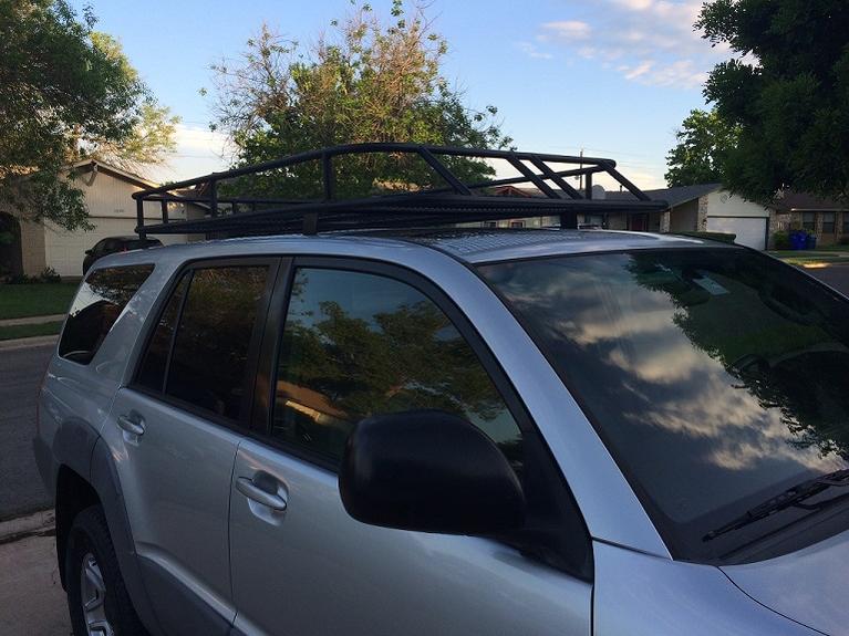

Added a basket frame, bed liner paint, and Harbor Freight Web, and still under $150. I would have been closer to $100 for this project if it wasn't for trial and error. Can't wait to put it to the test this weekend!

I'm planning home brew roof rails and rack someday. I think I got one of about 5 models without roof rails from the factory, so I get to design my own. :) Any lessons learned to share from your trial and error?
So did you test it? What were the results? The rack looks great, and the price is right. Curious to know how you did.

Yes, loaded up about 350 lbs. of camping gear up there for a 300 mile round trip with no issues what so ever. The only thing I have been thinking about adding is a mesh flooring.

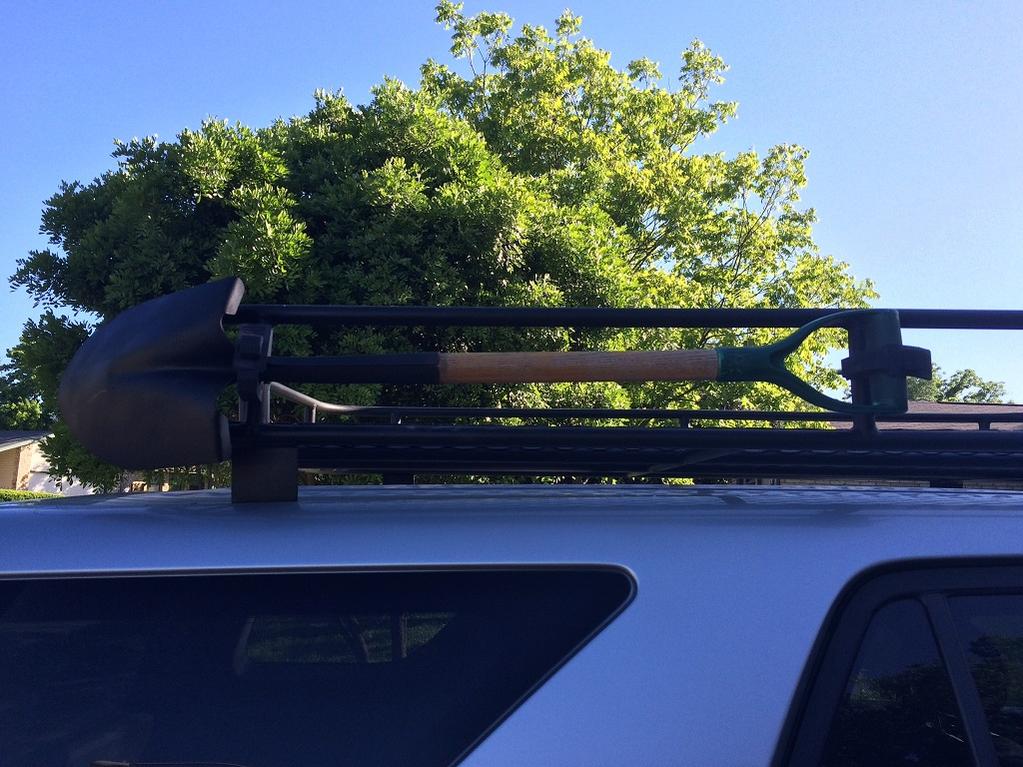

Nice thing about using EMT. Makes it easy to mount stuff.

what exactly did you use for those floor joists? What length are the joists across?
Sorry I accidentally put 3/8 EMT but it is all 3/4. For the floor I just measured each piece once I installed the rails and used a vice to flatten the ends.
