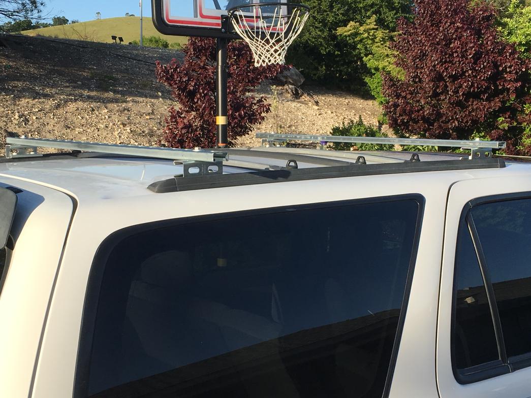

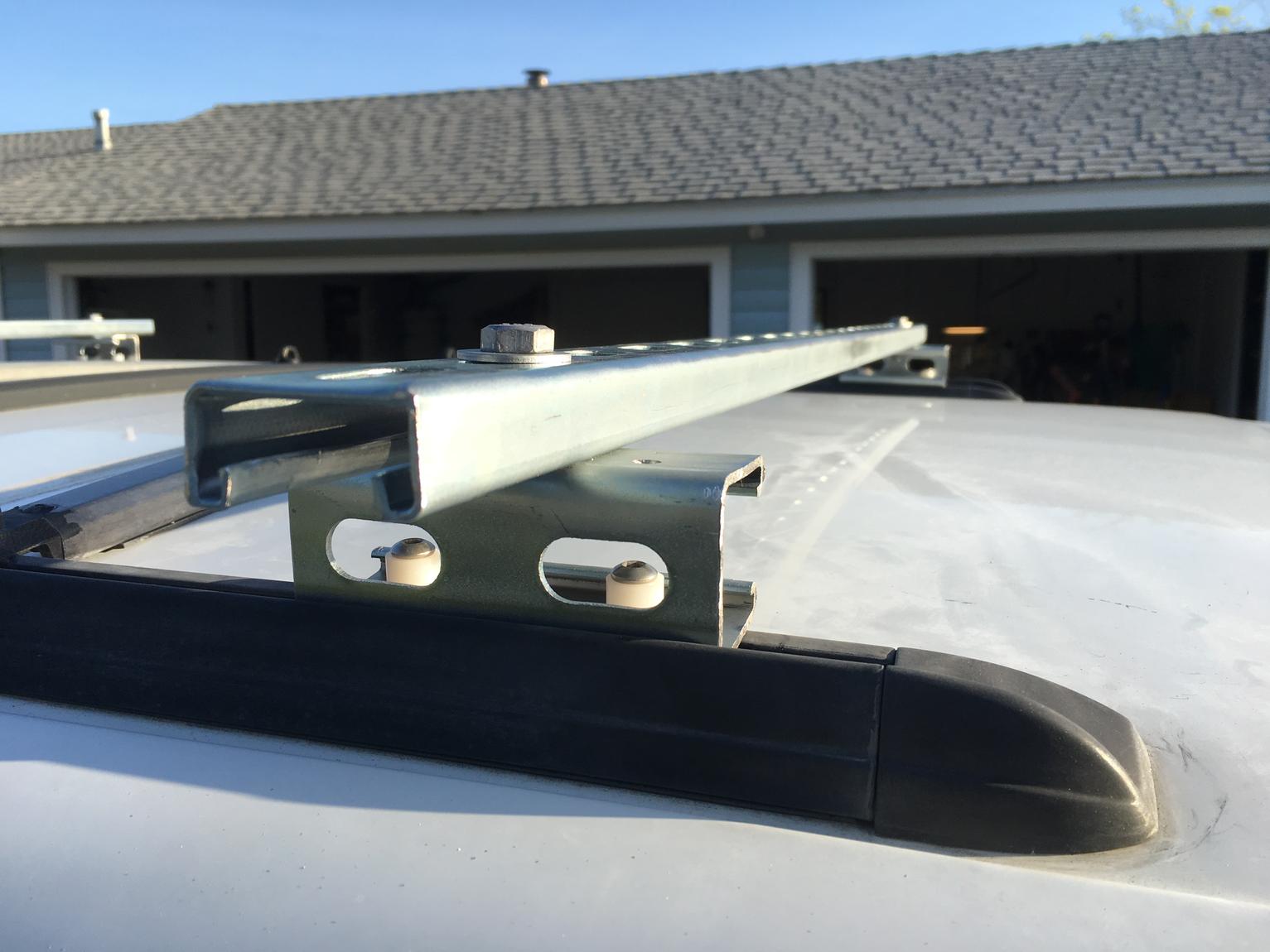

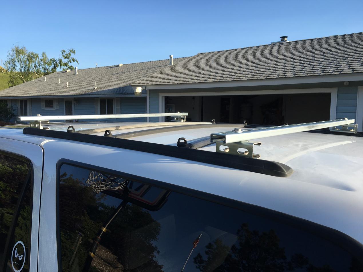

Here is what it looks like so far

Nice! What screws did you use to mount the 4" strut to the factory roof rail? Are they just screw that secured the original factory crossbars?
Since your using conduit strut they make a special flat spring loaded nut that goes inside the Chanel. I use that stuff all the time.
Bwarren
Thanks for comment. I used the original screws that held the original bracket down. They are a little long so i might change to shorter ones and eliminate the nylon spacers.

I did see the the spring loaded nuts, I just thought I be able to work with traditional nuts and they were cheaper.

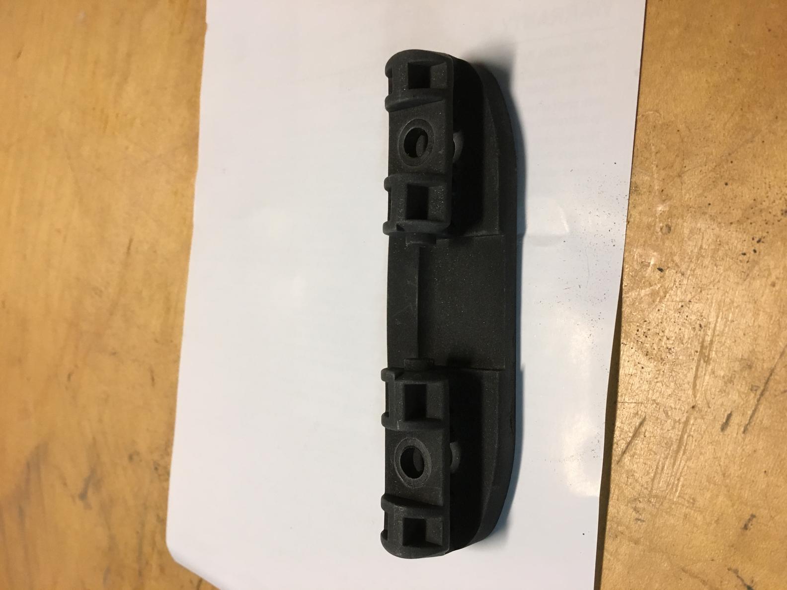

For the 4" pieces that attach to the rack, I see you used 2 bolts per side. But doesn't the original have only 1 of the square nuts? Where did the extra square nut come from? There are three of the cross pieces that rest on the roof, making for a total of 5 square nuts per side.
The original mounting brackets (4) are held on with two stainless allen head bolts and 2 square nuts inside the channel. I also have 3 square nuts per side for holding the cross beams down. I will take pictures of my original mounting brackets

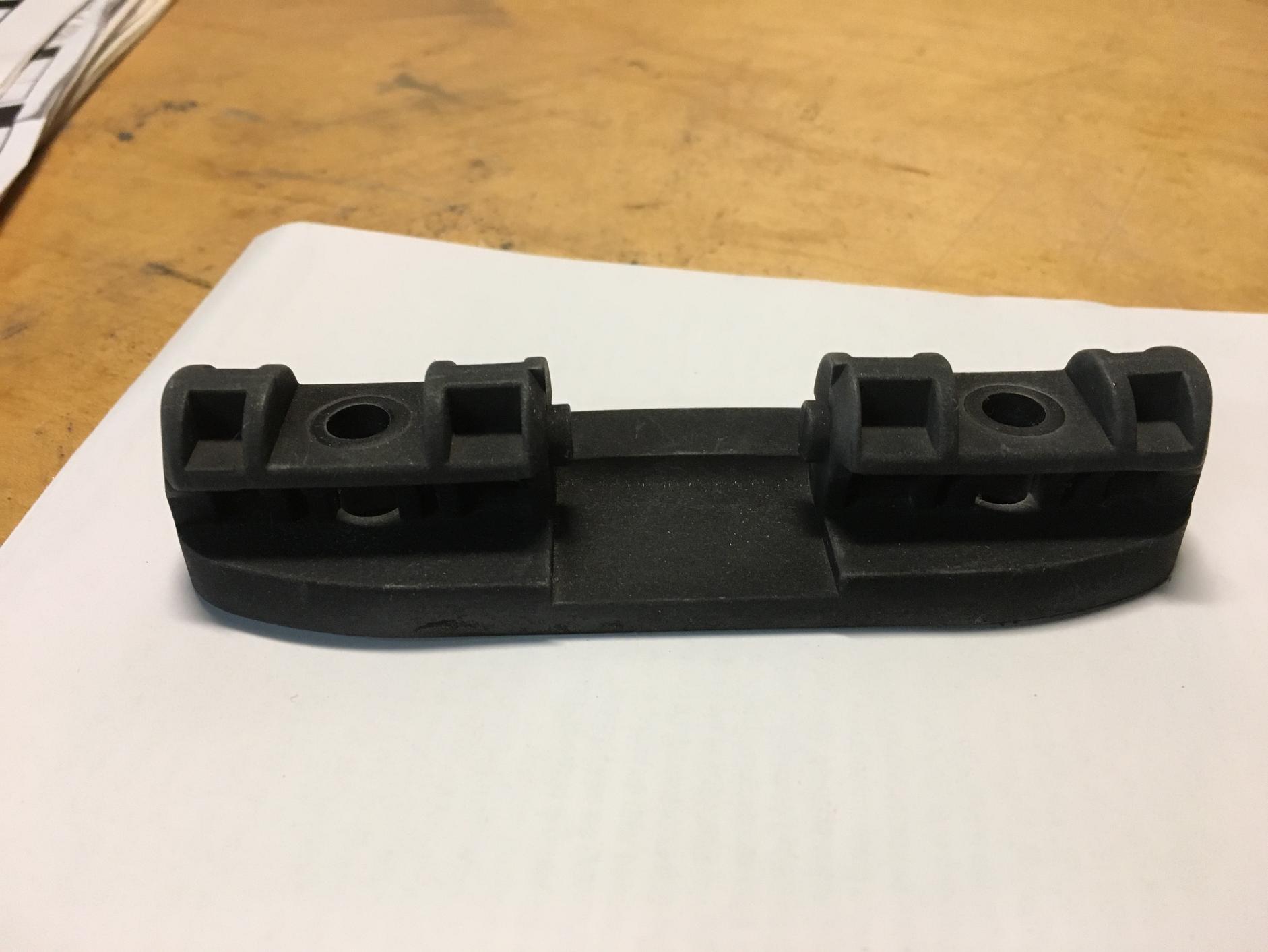

Pics of the brackets I removed and reused the 2 stainless allen head bolts.

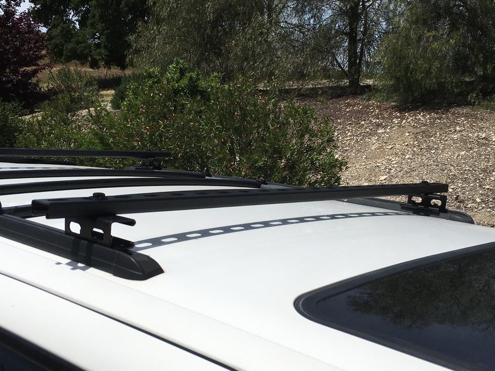

I began sanding and painting today on the cross beams. I discovered that where the strut had been cut it was beginning to rust very quickly.
I de-greased, sanded, cleaned, primed (self etching primer) and painted (flat black). I also removed and painted the 3 factory beams (the ones that touch the roof).
I am not very good at painting so I hope my paint job holds up.

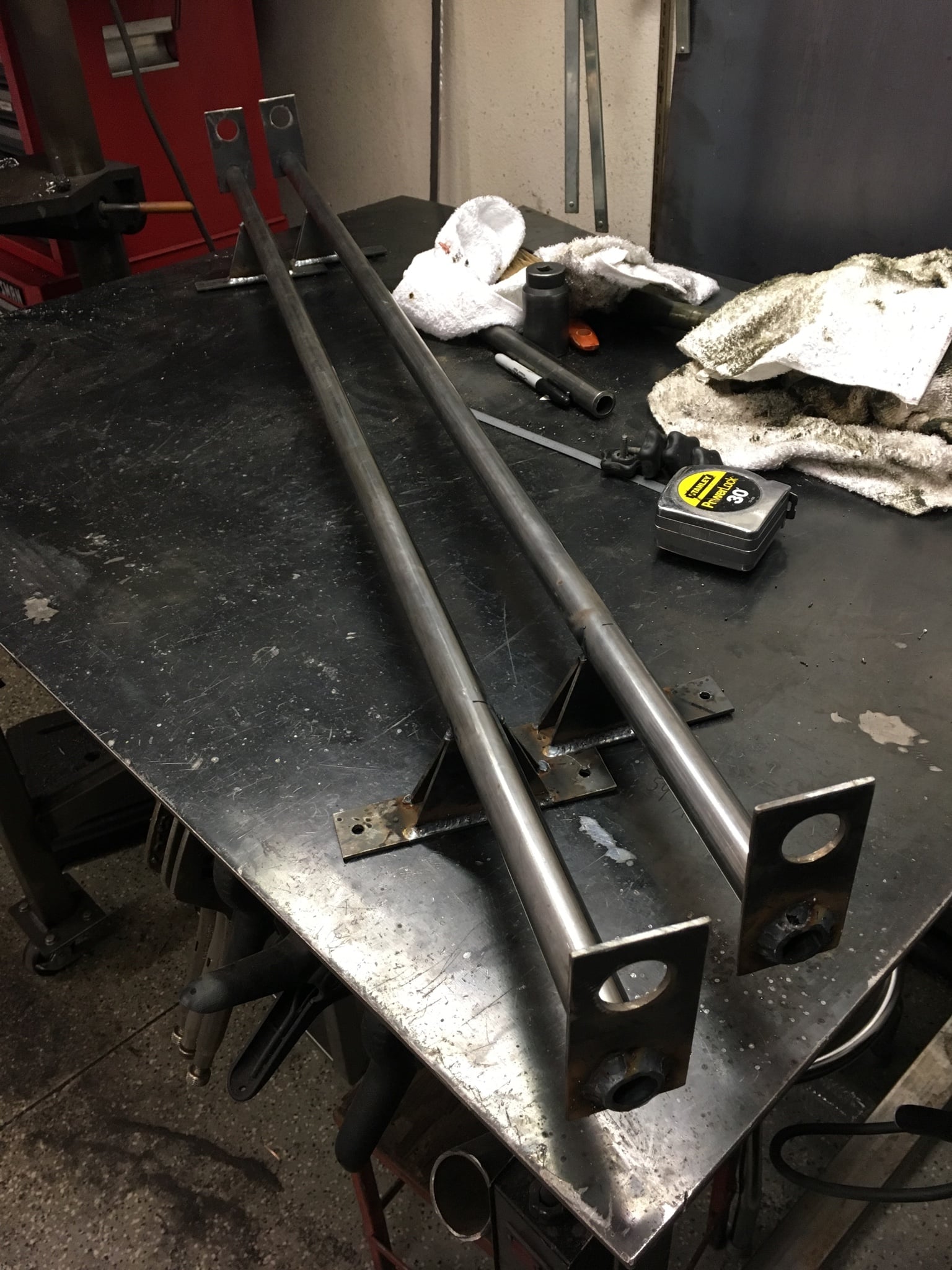

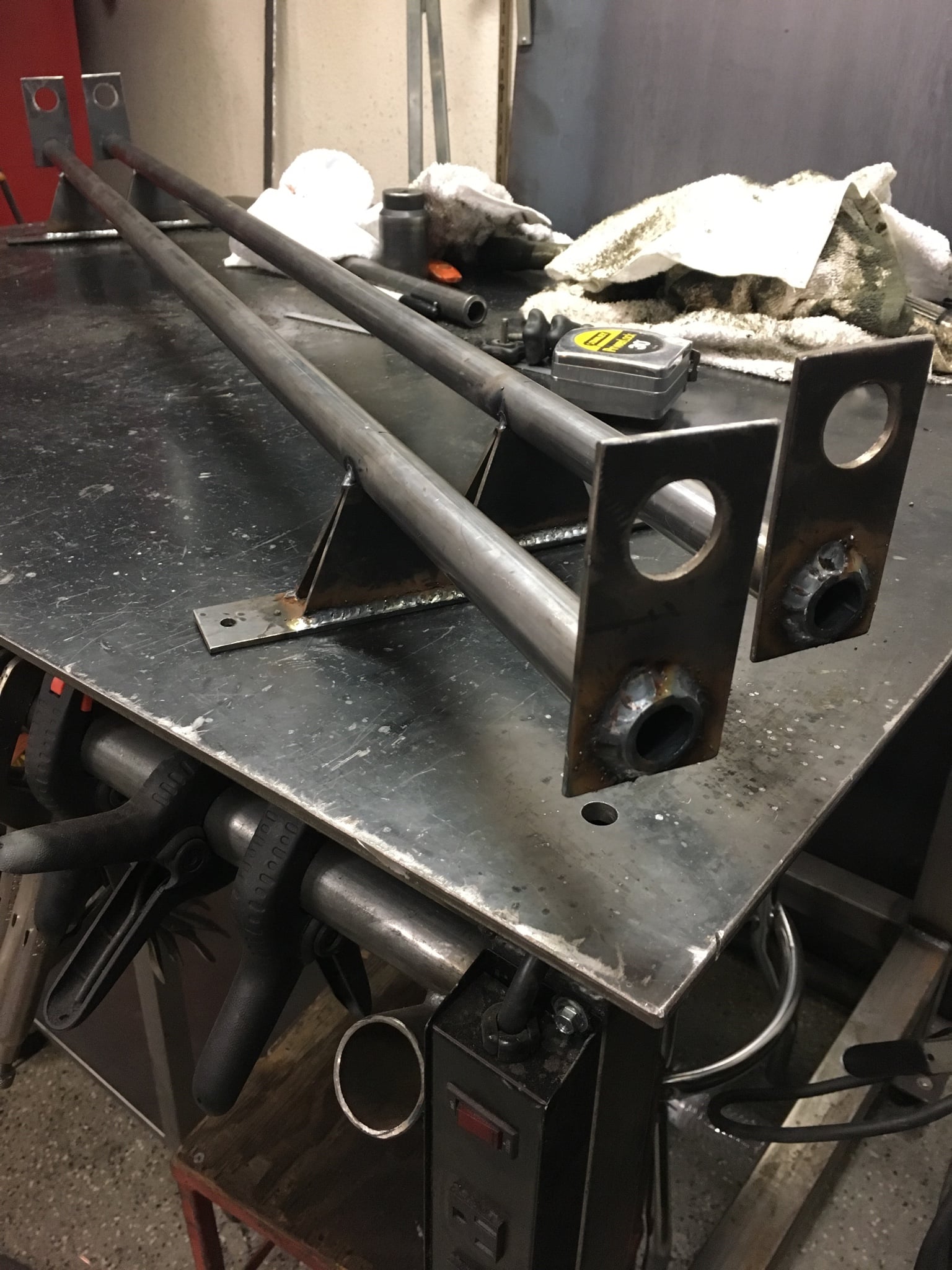

I just got most of the fab work completed on my cross beams tonight and I happen to run across this thread. I had the OEM ones but one bent from throwing my 12' aluminum boat up there so I decided to made some new ones out of 1" x .120" wall tubing and some 1/8" plate. Bolts directly to the factory rails. I made it wide enough for my boat to sit upside down on the beams and easy enough to take down between trips. I also added some side plates with some tie down points for ease of securing the boat. Still got to clean them all up and paint them. I'll share more pics once complete.

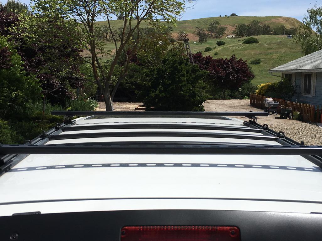

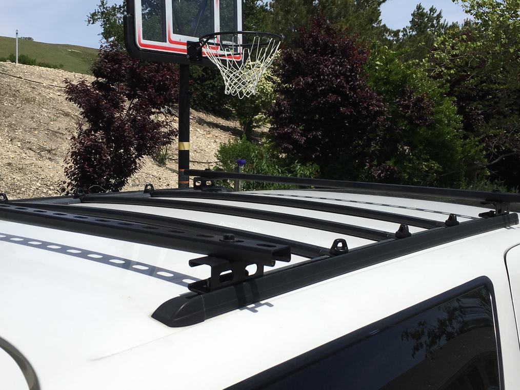

I finally finished painting the roof rack cross beams and reinstalled them today. I like the way they turned out. Hopefully my paint job holds up.
