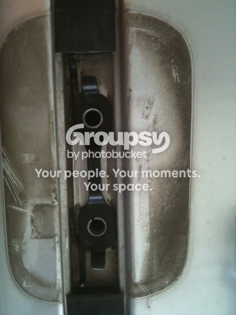

IMG_1483.jpg~original

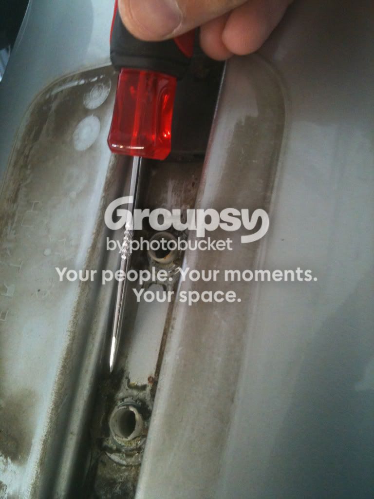

remove all the old foam:

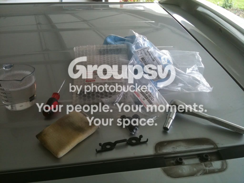

IMG_1485.jpg~original
place the clip over the holes with the small arrow point out (the arrow is hard to see in the pic):

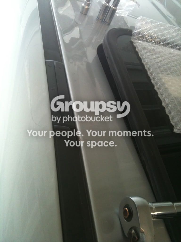

IMG_1484.jpg~original
then clip the molding into place with the arrow pointing out, and scrub the old grime off the paint:

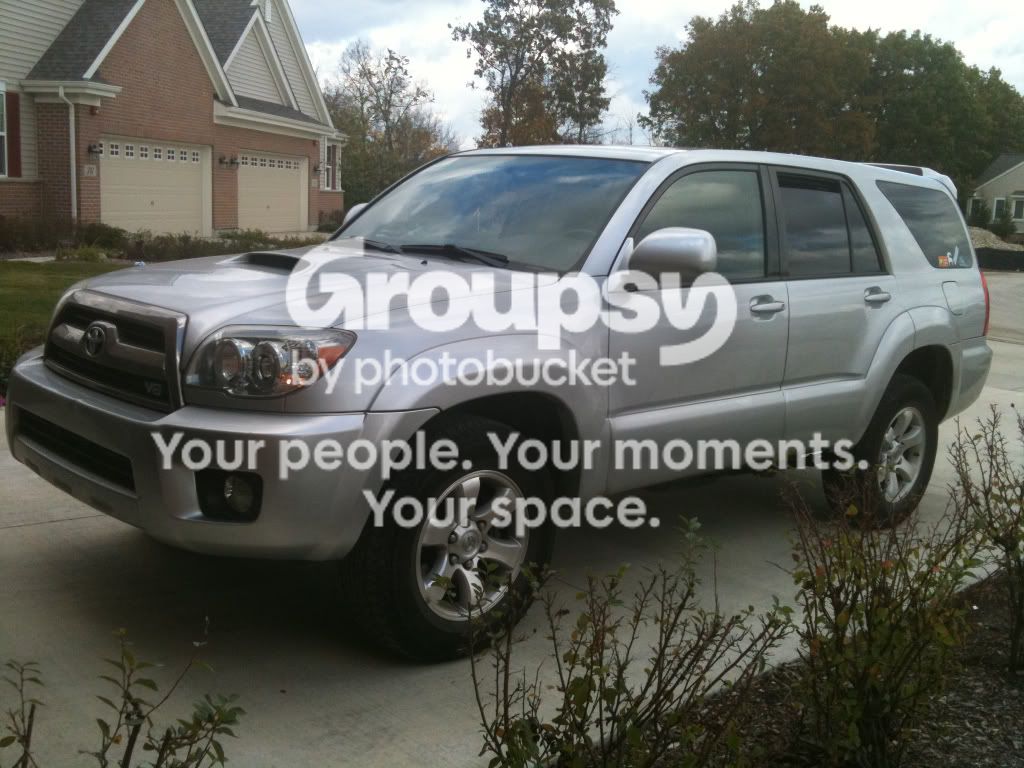

and now enjoy your truck without the rack!

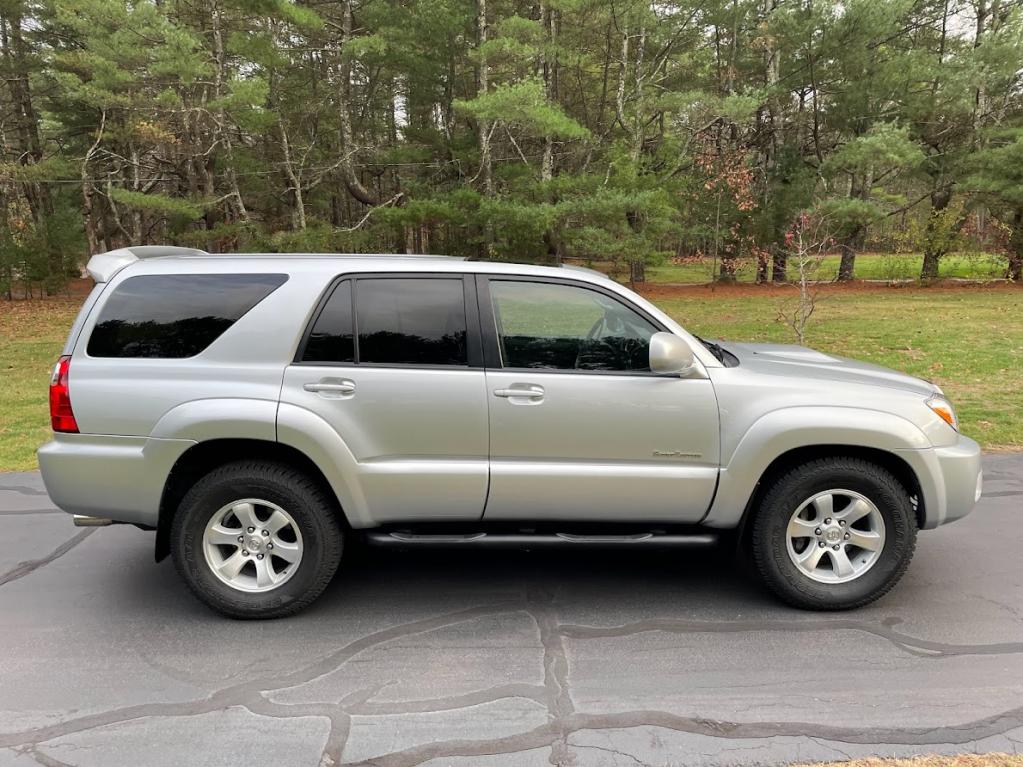

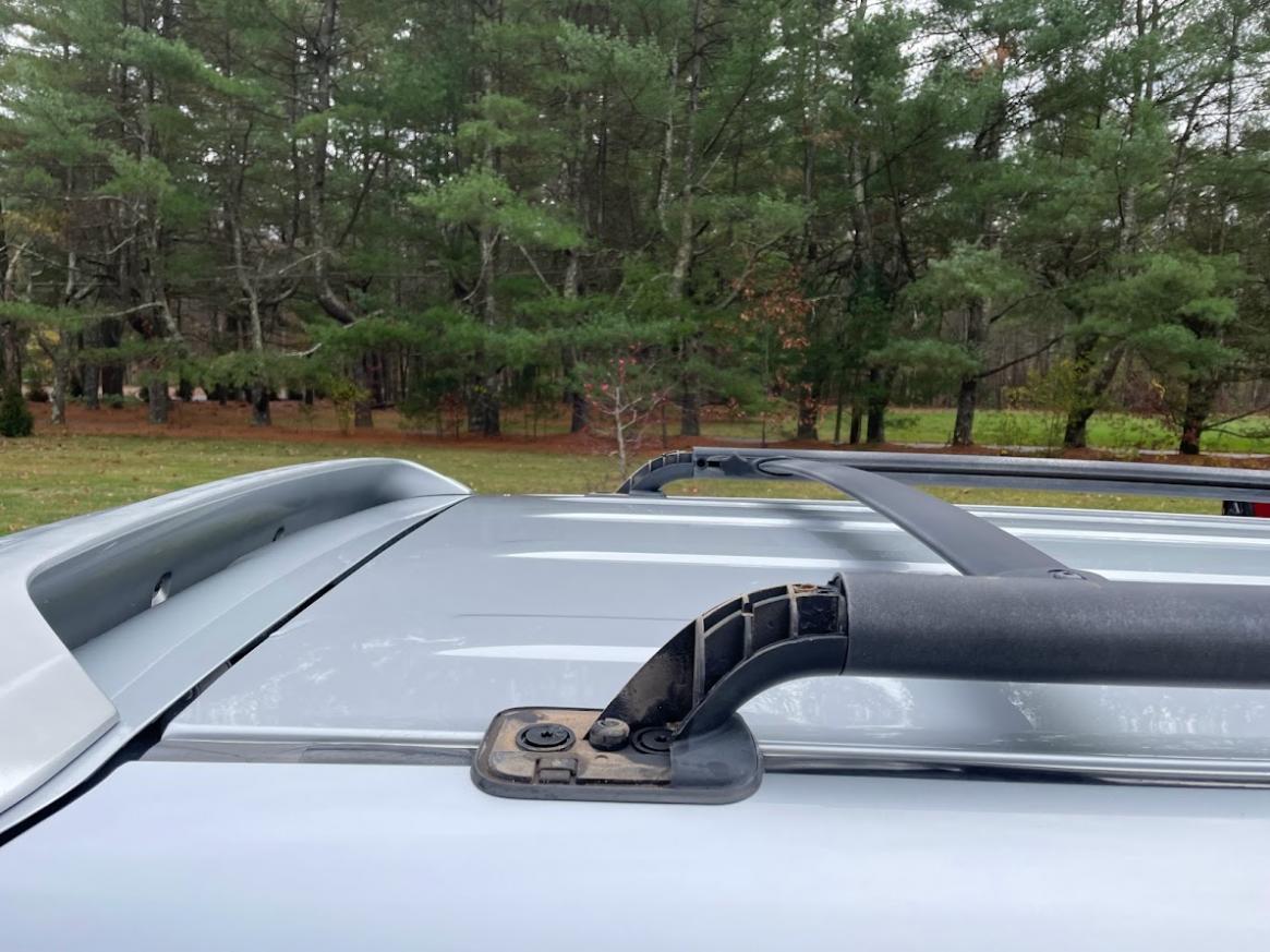

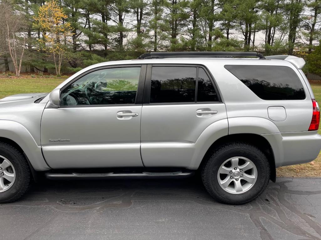

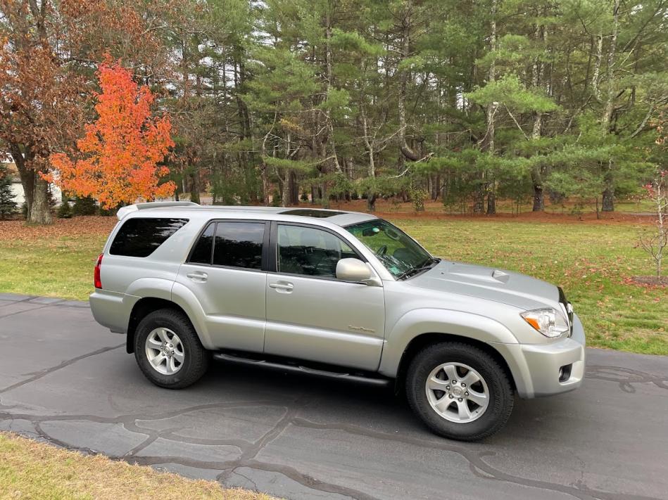

I know this is an old thread but I am probably going to do a Roof Rack Delete. It actually does not look bad and I never use the top rack. I am painting the rack in case I sell it and keeping it but I think the rackless looks OK in silver at least. This is a 2007 Sport 4Runner with moonroof that had the plastic mounted rack. It has less wind noise on the hi way and slightly better gas mileage so that is a small plus.

here are more photos

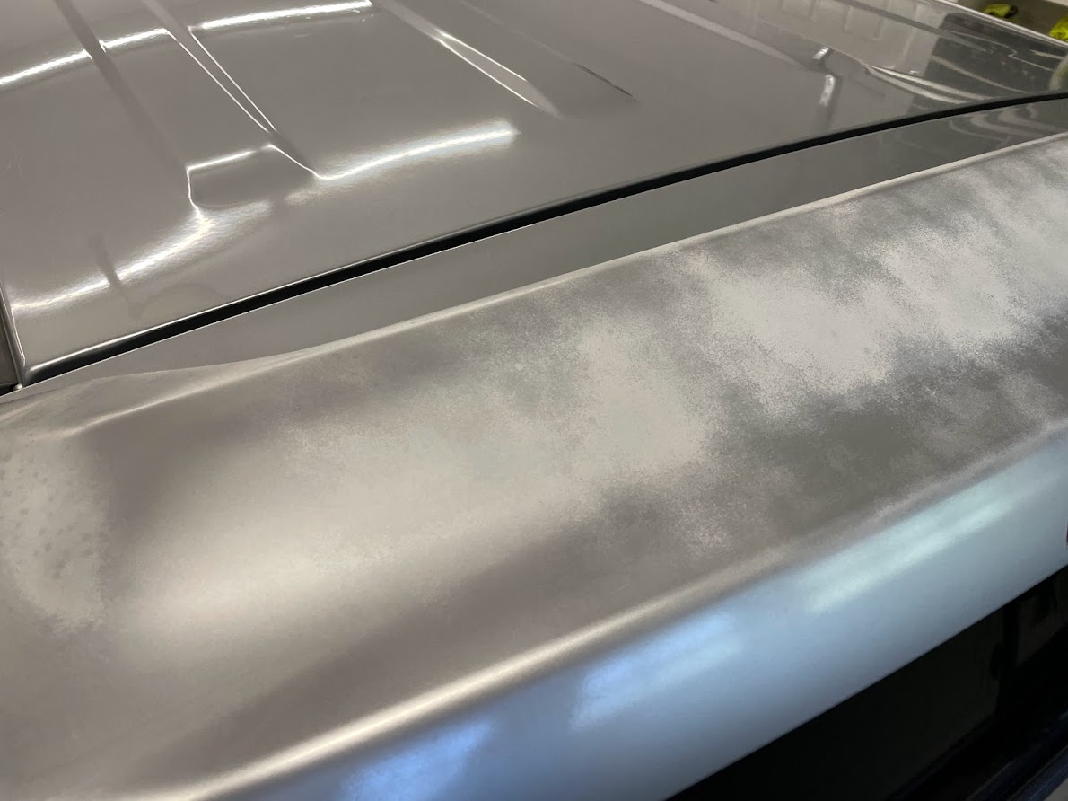

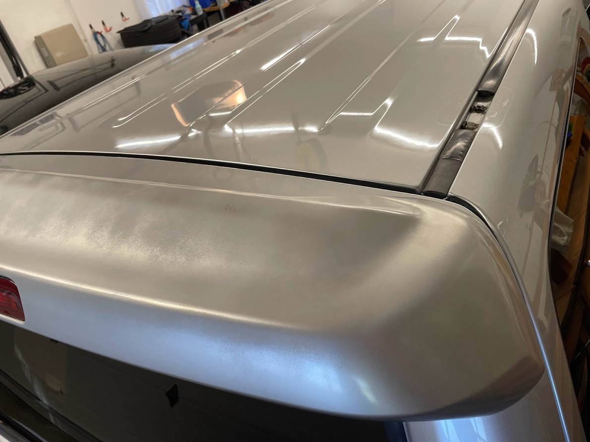

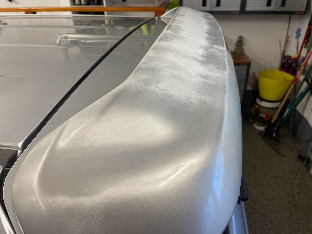

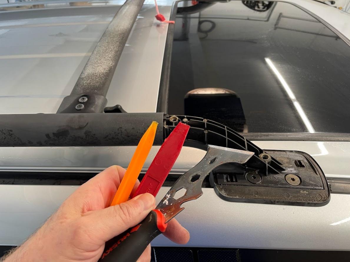

My plan is to leave the rear large spoiler on long term. I will be removing it to paint it silver ID4 though so I will take photos. The plastic parts of this 2007 4runner need to be replaced and or repainted. It was a Arizona vehicle and the sun trashed all the painted plastic parts. The rest of the car is mint.....and it has 247,000 miles.

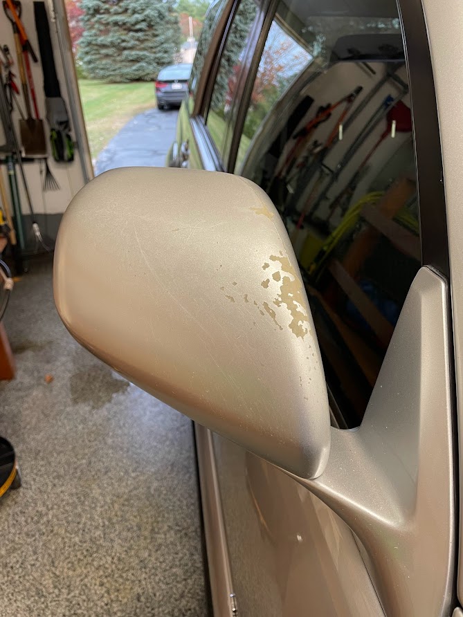

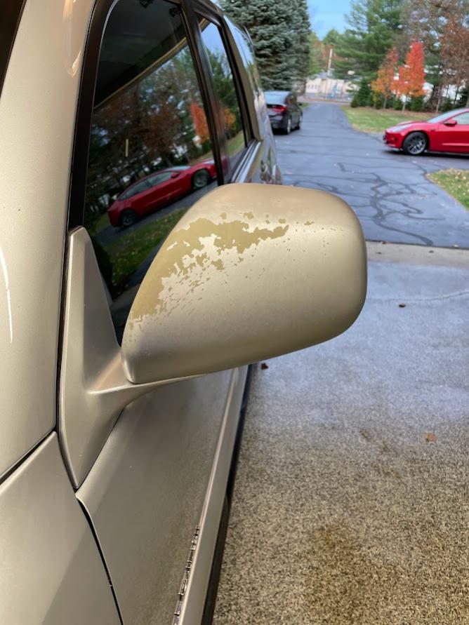

Here are the side Mirrors. I am replacing with new factory mirrors. I am not going with aftermarket mirrors as the last ones I bought shook to much on the interstate. Not all aftermarket mirrors shake but unless you have first hand knowledge on the type you are buying you might buy some that do shake. Shaking mirrors makes the whole car feel cheap so its not worth it to me.
