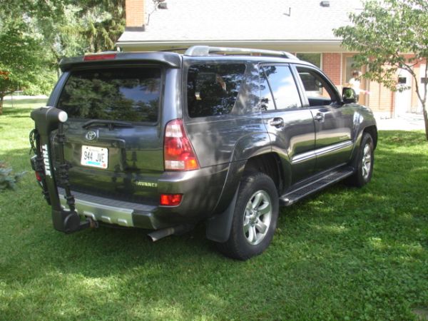

I've been roof rack user for a long time. When I got T4R I decided to give the hitch rack a try. No regrets, it tilts out of the way for easy access to the rear.
