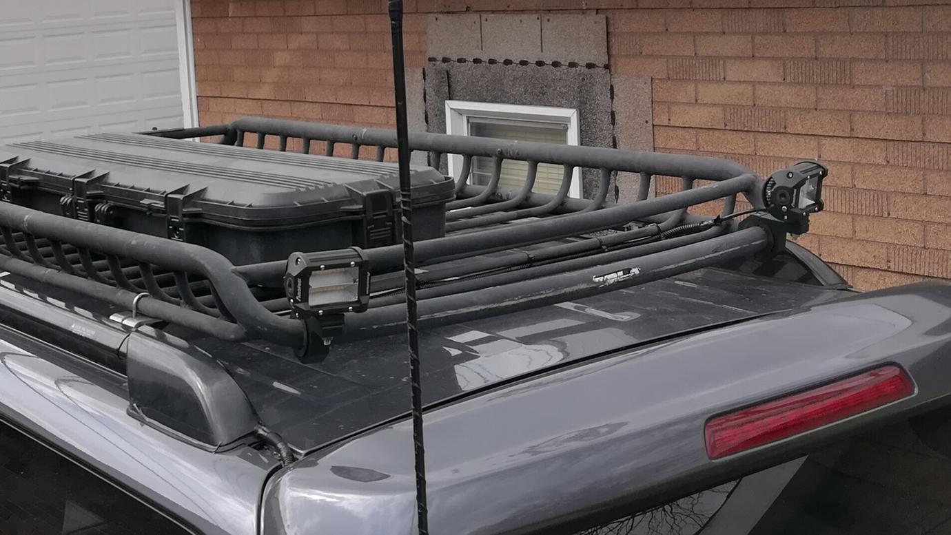

Yep. I am no light expert, but I have experience with different types of offroad/fog/driving lights and the ones I thought were the best budget lights were Auxbeam 4" pods on Amazon. They never went bad, never got water in the lenses, Cree LED's with good light output and overall good quality led lights for the 20 bucks I paid at the time.
I used those clamps on my Rola rack for my rear LED pods and they work really well

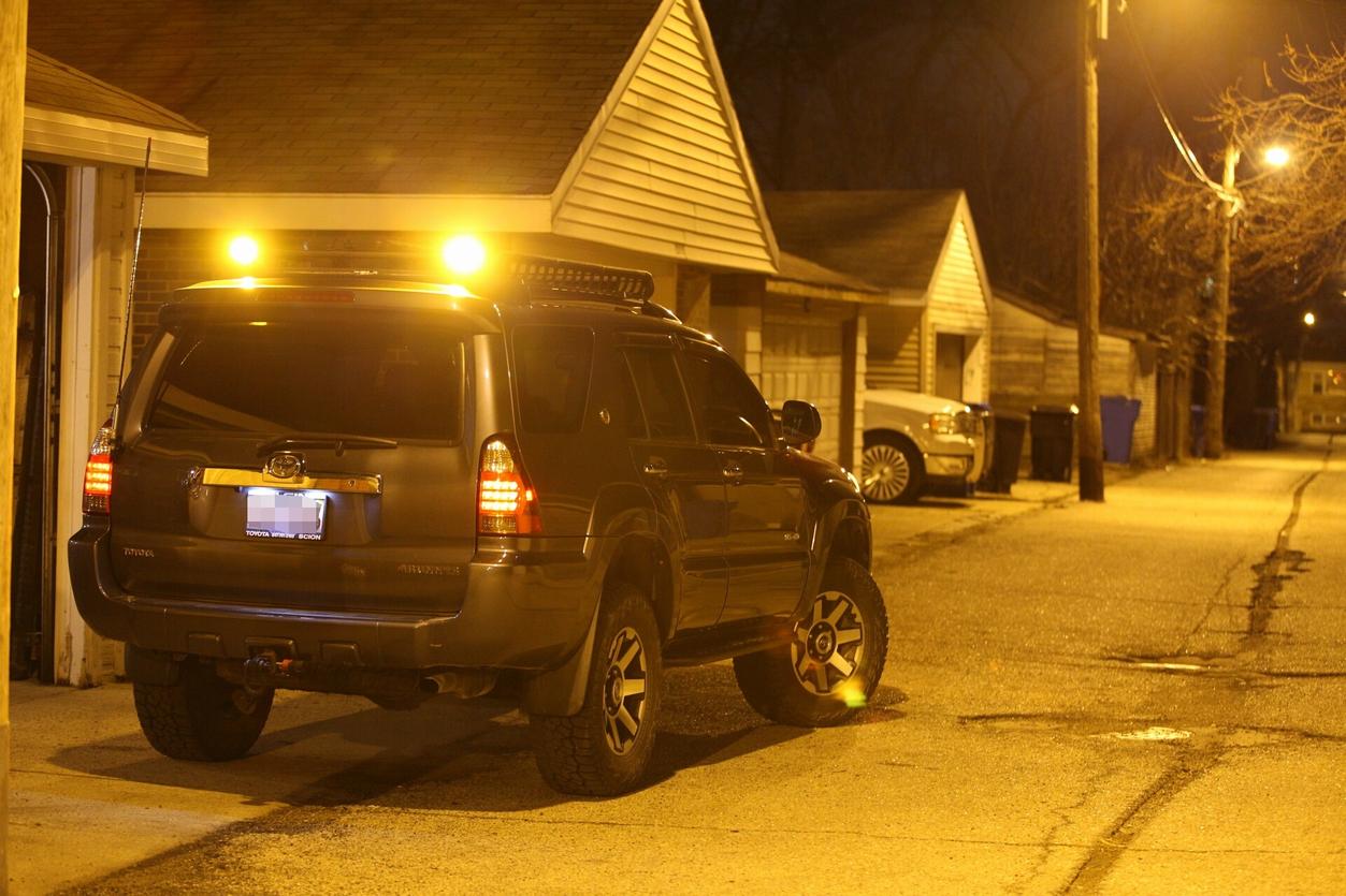

Have you considered something like this? I had a cheap Amazon light bar left over from a project that was outside the return window, I think I spent about 50 bucks on it.
