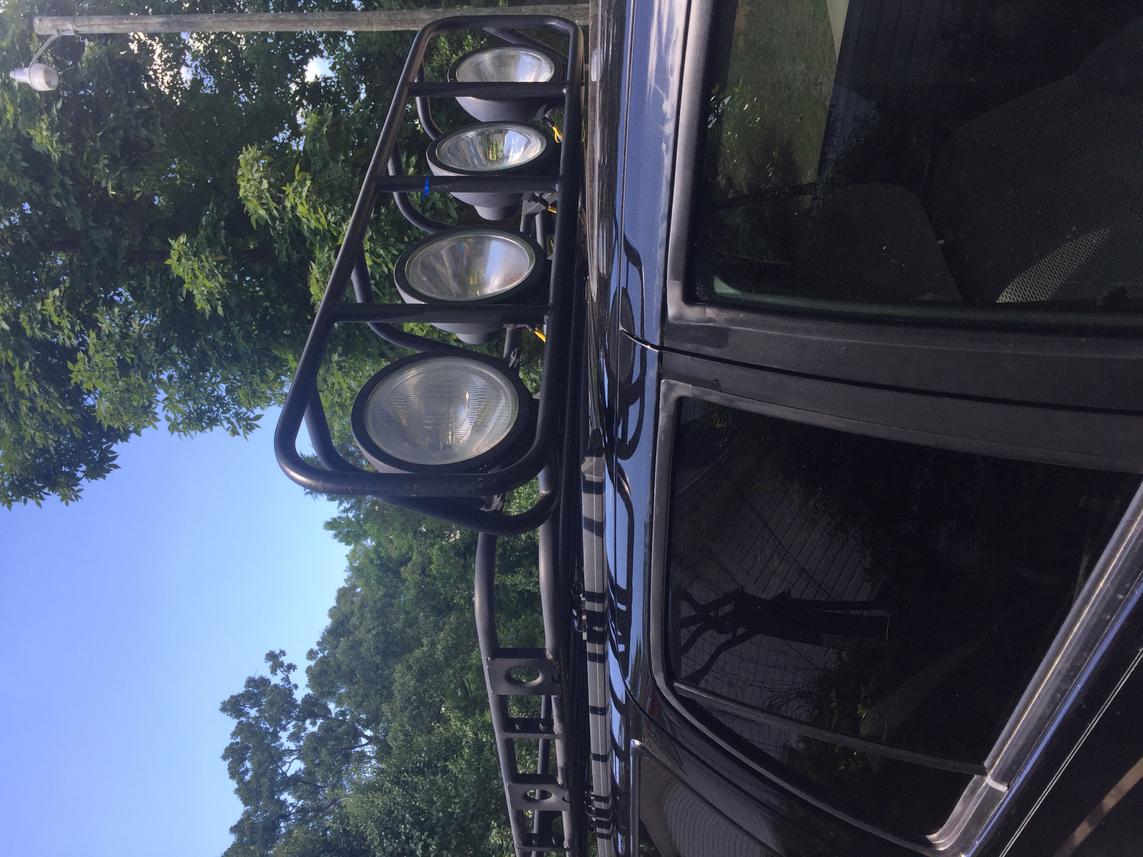

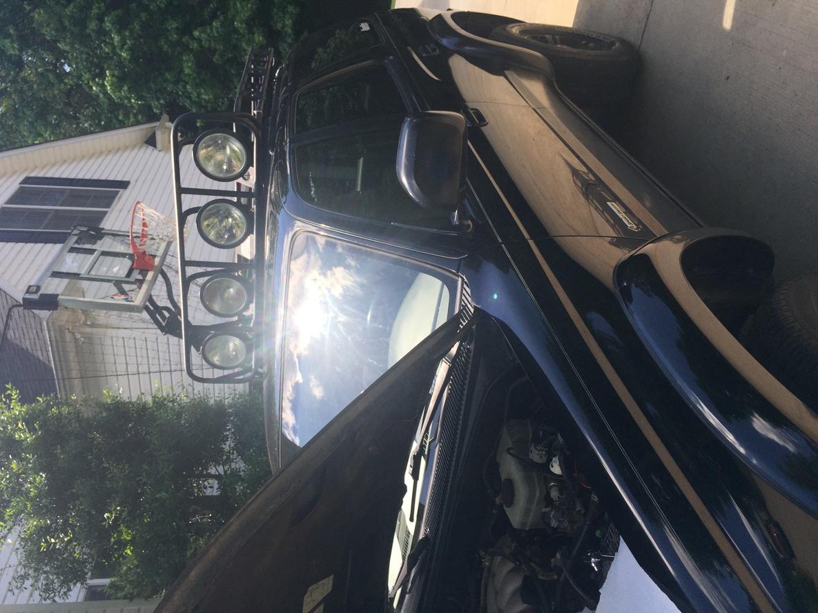

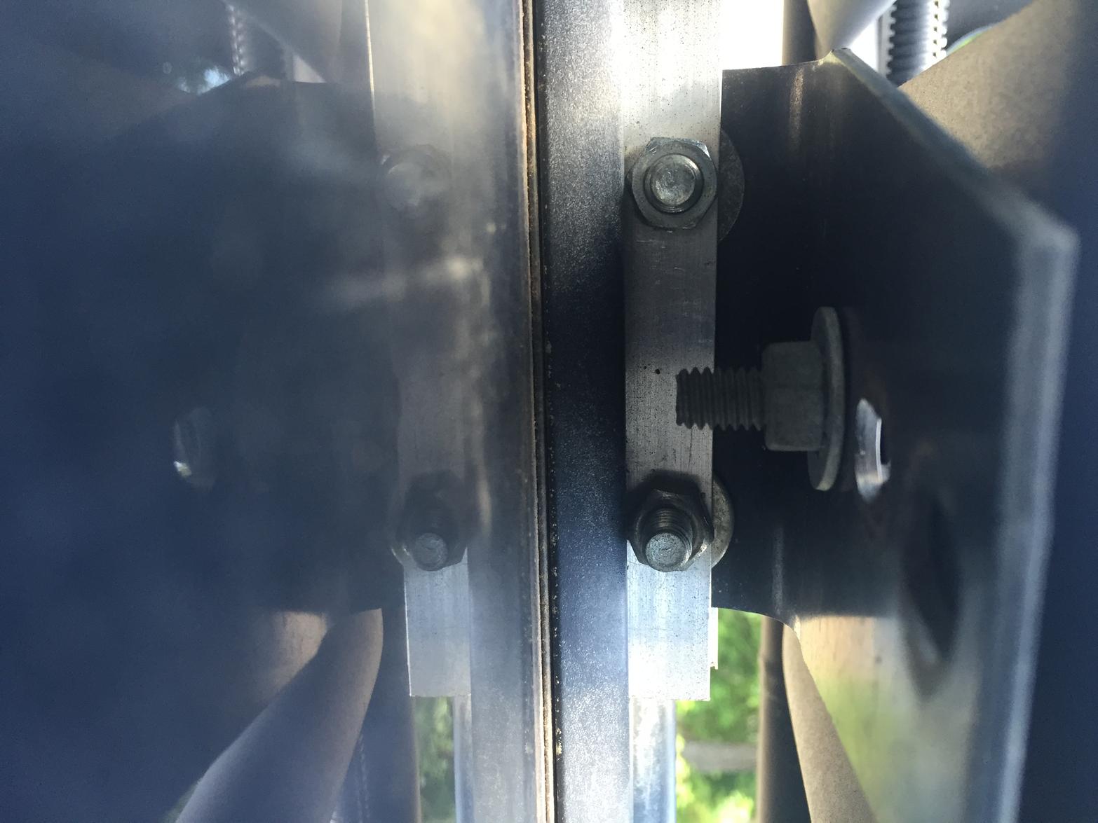

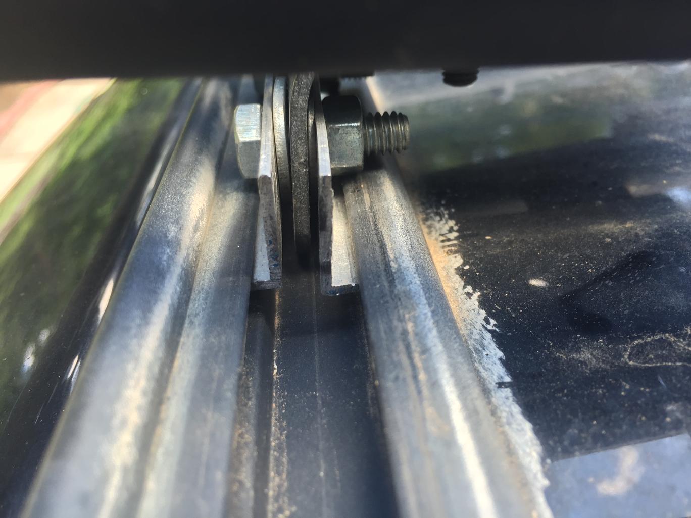

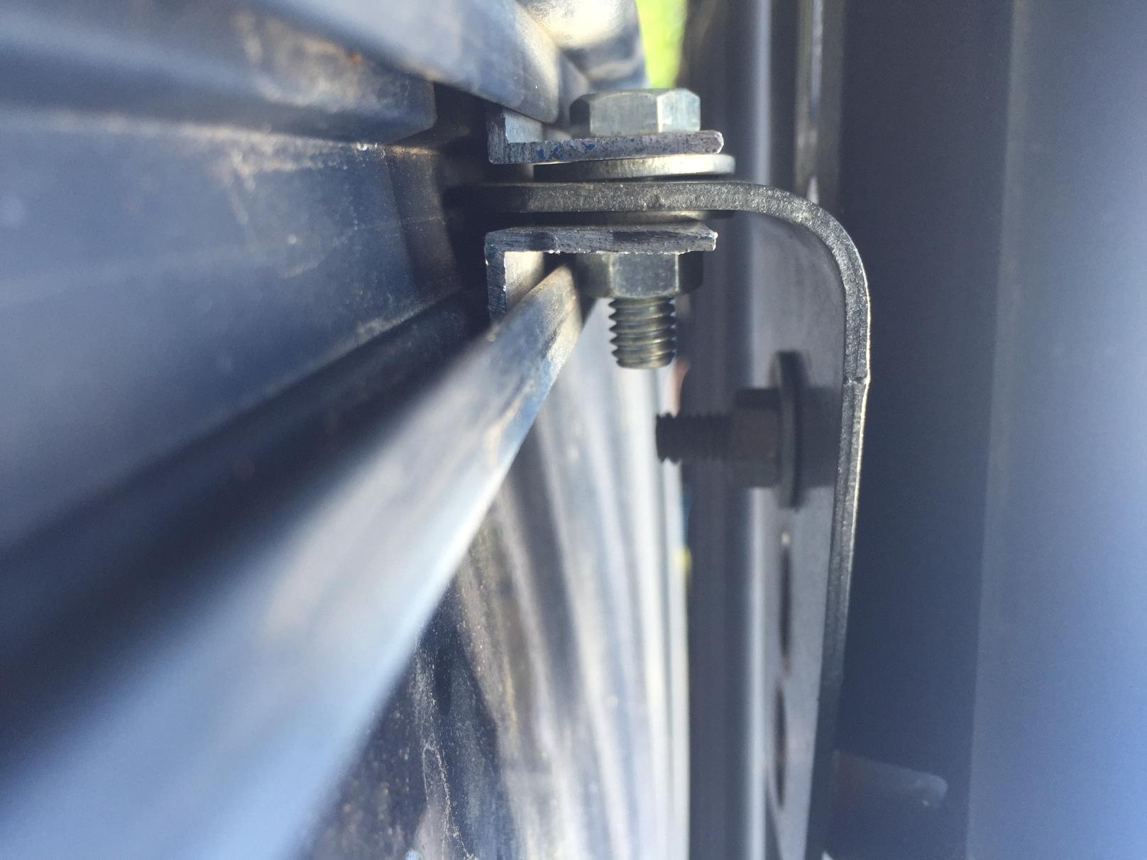

This is what i did. The Smittybilt rack came with 4 "L" bracket that bolted to the rack and then went down straight. They were already pre-drilled with holes on the straight part so I went to Lowes and bought like 4 ft of aluminum metal that was also shaped like an "L". I drilled matching holes in those and put bolts through the aluminum brackets and the rack bracket. i then cut the newly made brackets in the roof rack slits to see if they would fit and then cut them accordingly with a hacksaw. Haha sorry if this is really confusing, its hard to explain, but the pictures explain it better.
That's a great solution.
Props on the creativity!
Thanks! I love that it's so low to the roof, there like an inch gap and I needed that with lights this big. My mpg is still suffering though haha
When I welded mine up I actually used your concept to get it so close to the roof. I got to 3/4" of clearance and ended up with 1/2" deflection with 200lbs+ on my rack.
