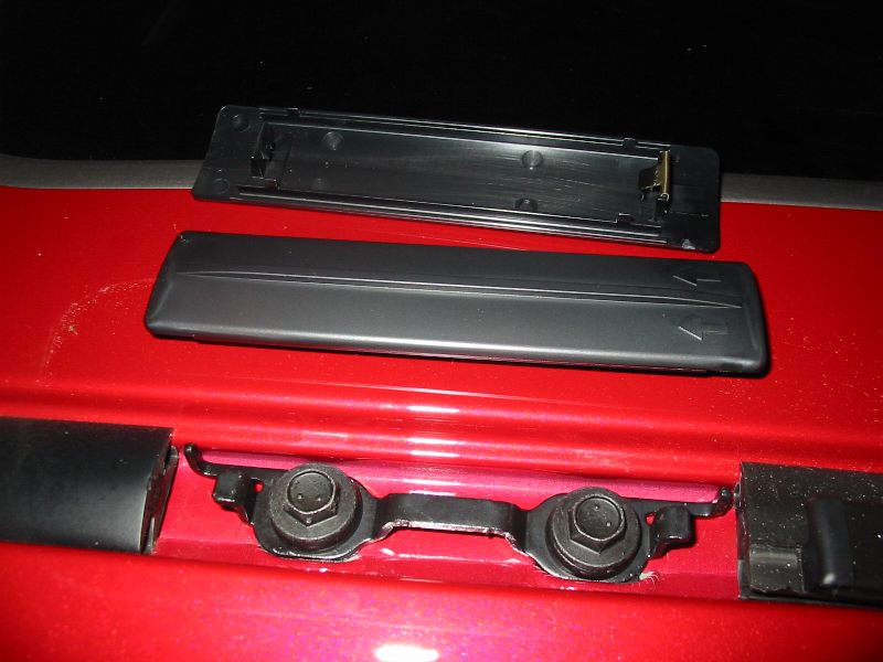

Hi,new member here.Picked up My 08 Sport Ed Titanium Metalic Runner early Novenber.Very happy with it.Any ways been looking on forums for parts needed to remove roof racks.Seems a few others were interested too but no info.After much searching found parts needed to do it.Parts needed 8ea.90119-08C47 Bolt W/Washer 4ea. 63185-42020 Bracket 4ea.75596-02020 Cover.Just remove rack and install parts and its done.Removed my rack because I dont need it and easier to clean roof.Also no more wind noise.Hope this info helps.Bellow ispictures of a Rav 4.Parts are same part number except for cover.Totalcost was about 72.00

Sorry but dont have a camara ,mines broke.Let me know what more info you need .The bracket has like a small rubber felt like gasket on the bottom of it to seal the bottom and the bolts have a rubber gasket about3/16th of an inch thick.The cap just snaps onto the brackets.You can see the tabs on the bottom of the cover.The cover doesnt seal out water from going into channel.If you take off rack you will notice that the base of rack also doesnt seal out the water.Wanted to seal it but was thinking if water did get in it wouldnt be able to dry up.Guess thats the way it was designed.
