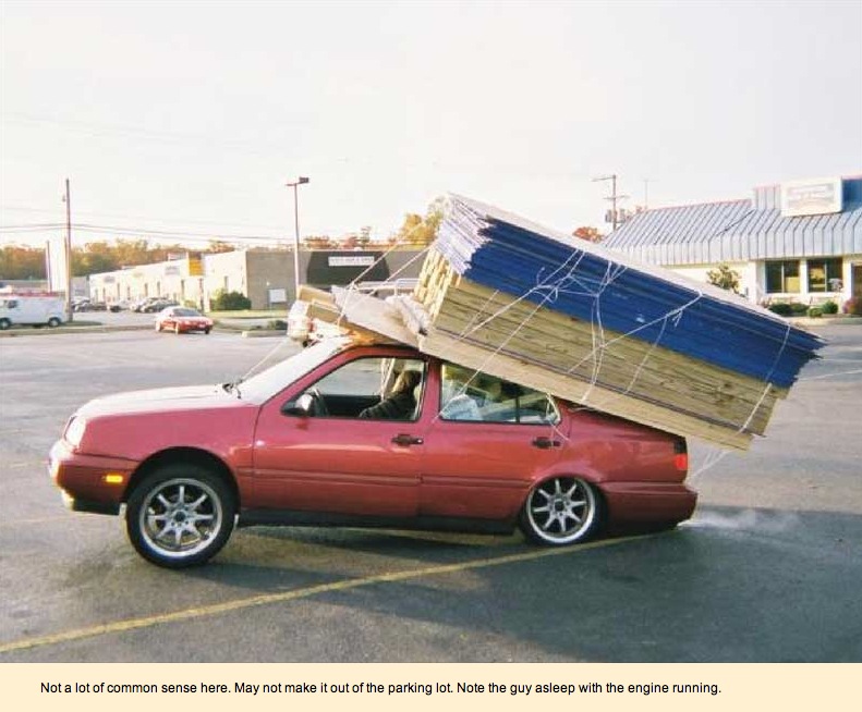

i saw a picture not to long ago of a guy that put atleast 20-25 sheets of sheetrock up on his roof.

Of course, you could try to be like this guy:

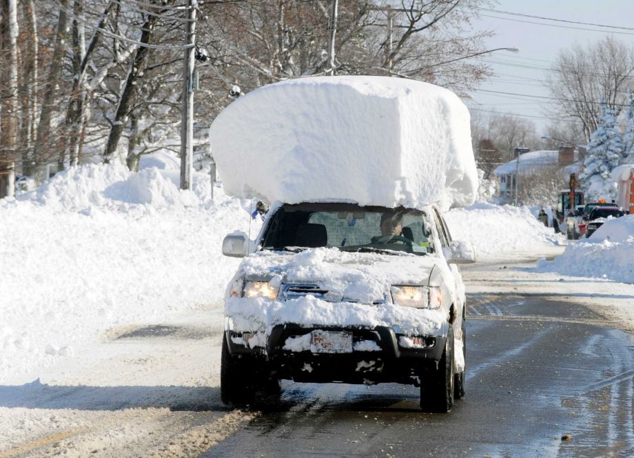

Thats all BS, I've had 1000lb of snow on mine! They're indestructible!

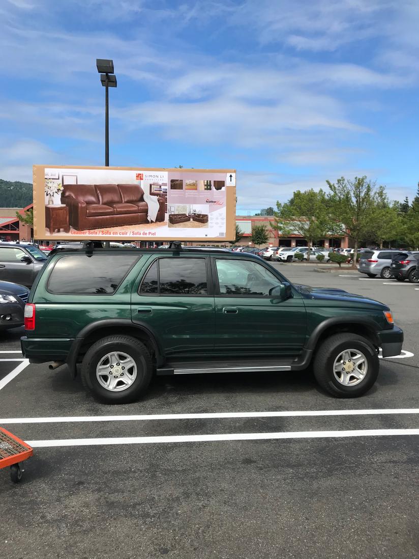

Did just fine with this couch on top, for about 8 blocks. Yes, I used straps. It helps to have an understanding of dynamic and static loads, and the importance of very strong sphincter control when driving over small bumps. Also, don't ever do this. I'm sure I exceeded the published limits of both the rack (Yakima) and the 4runner, in addition to breaking several local and state safety laws.
Nice couch...:)
