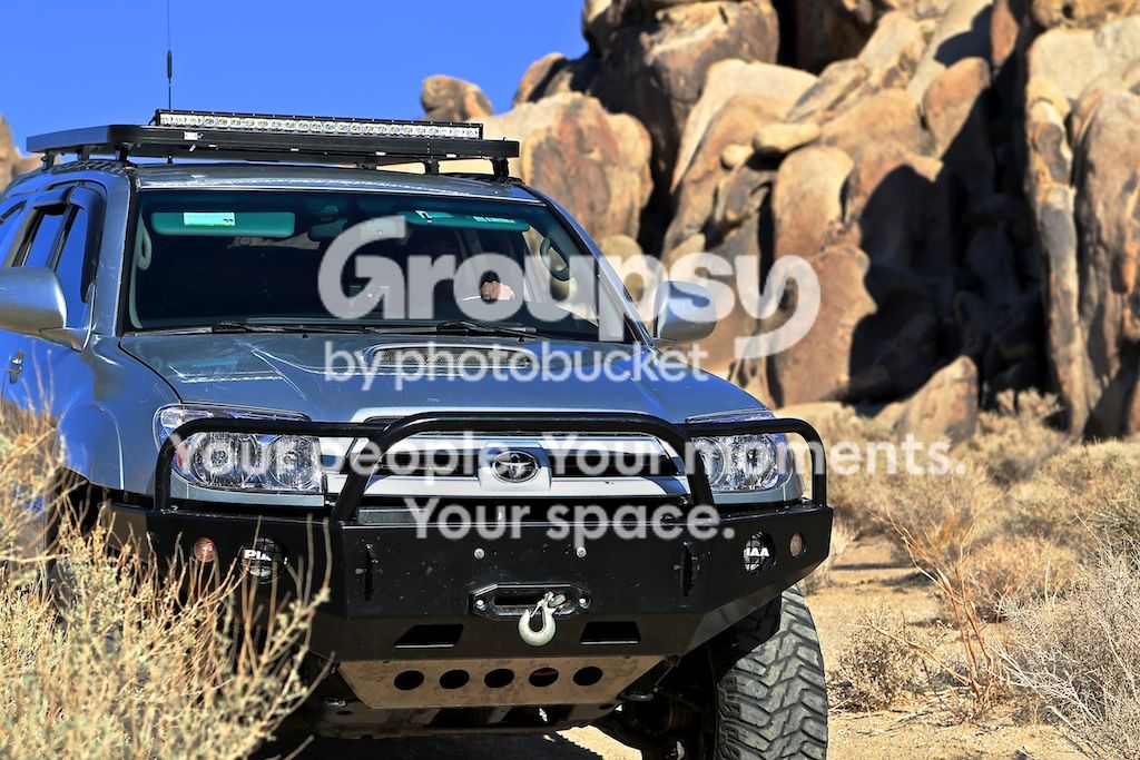

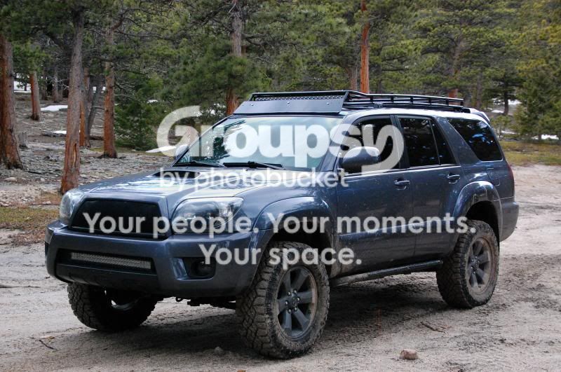

Gobi Stealth Rack with 2x Hanma 7.5" bars and a 13.5" bar.

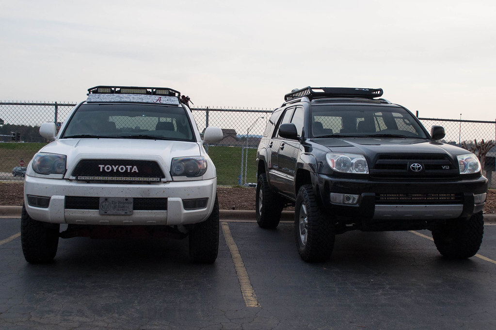

How about some pics from [MENTION=46025]HokieRunner[/MENTION] [MENTION=44999]HOJeepster[/MENTION] [MENTION=69441]Dawg4Runner[/MENTION] [MENTION=84676]Tayzorz[/MENTION] & [MENTION=79982]T4rman[/MENTION] to get this thread going
edit- wiring goes through the firewall, up the A-pillar and through a hole I drilled under the rack foot mount. Could've went to the rear, out, and back to the front but I didn't wanna run that much 14 ga wire.

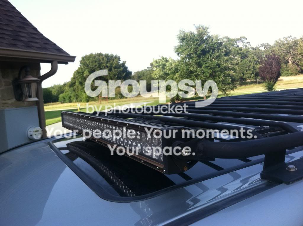

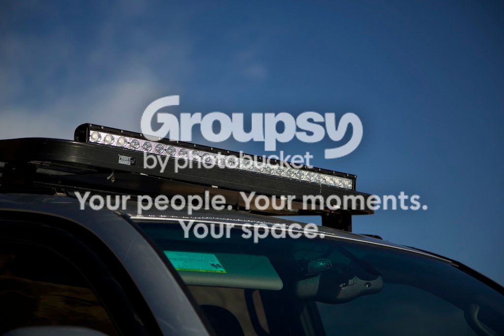

Perkins Performance Roof Rack custom designed by [MENTION=20116]darkie3495[/MENTION]. Rigid Industries 40" E Series LED Light Bar.

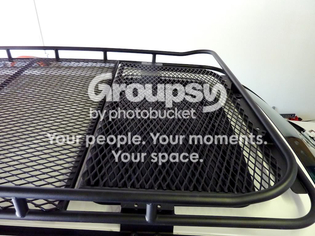

Removable grate over sunroof (no longer useable with current light bar)

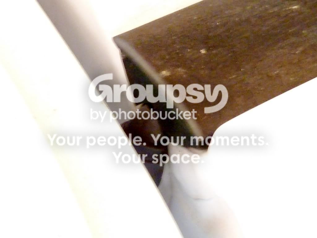

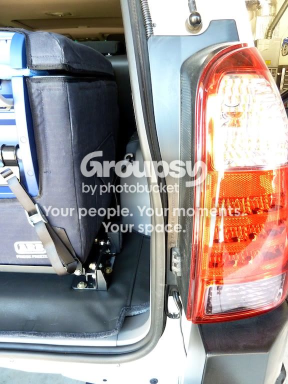

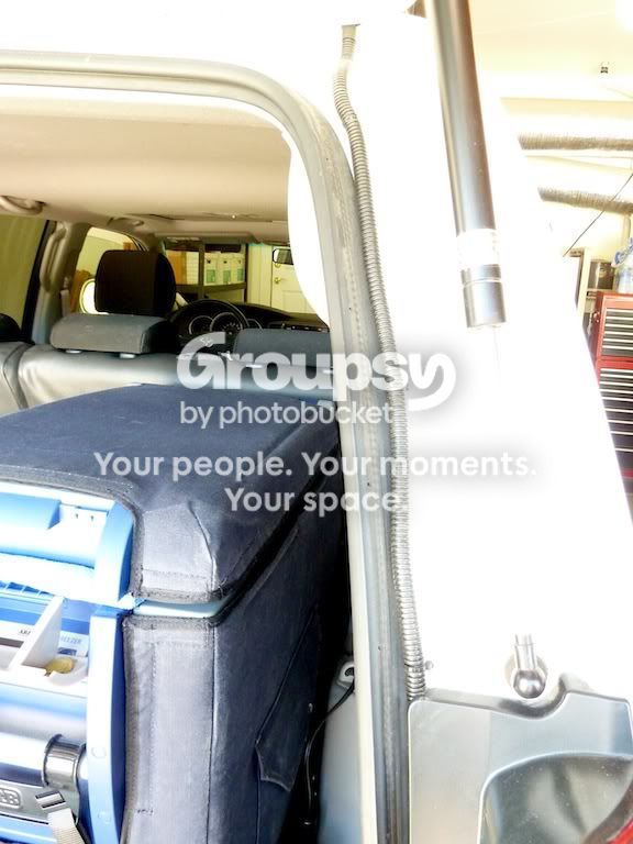

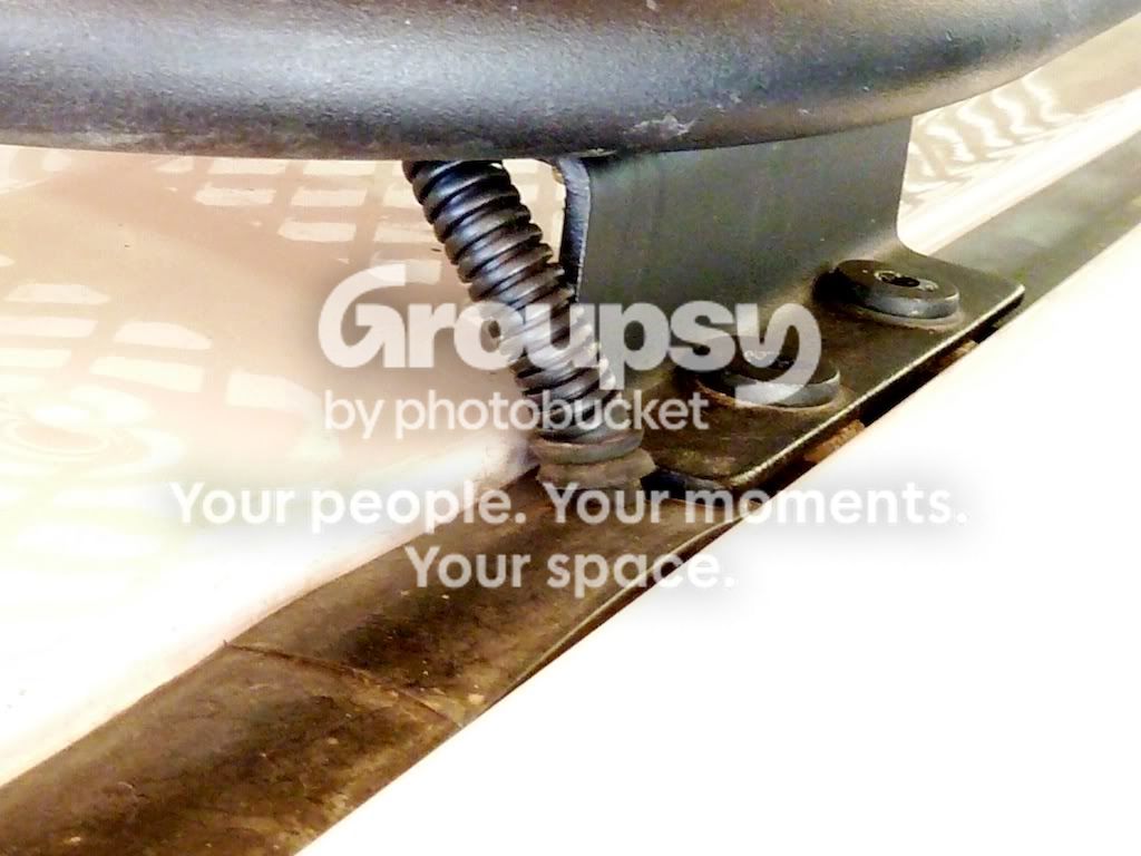

Wiring runs under the passenger side lower roof rack tube then under the rear roof gutter molding. The wiring then runs down along the rubber gasket for the rear hatch door, under the tail lamp assembly and enters through a rubber grommet below the tail lamp. Power comes from the auxiliary battery.

I don't know why I'm asking since I'm obviously not going to buy one, but is the grate not usable at all or just not removable with the light in the way?

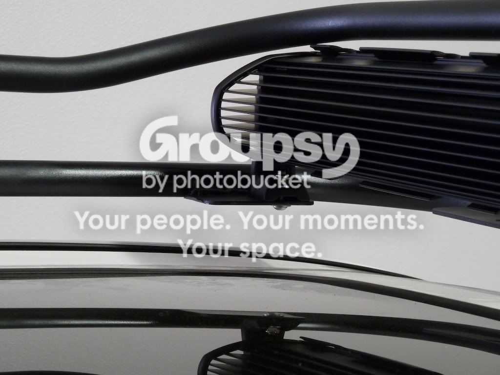

I had to weld a couple of tabs on the rack for the legs of the light bar to mount on. The tabs and the light bar legs prevent the grate from being installed. The grate could be modified to work but since I've never had to use it in the past and probably will never need to use it in the future it's not an issue.
