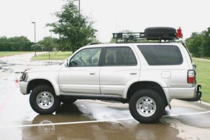

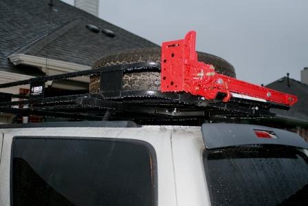

Not sure if your 91 has pre-existing channels on the roof with a factory rack, but if so, that is what you would fasten the after-market ones to. I have a Surco Safari roof rack loaded with the spare tire, hi-lift jack, and couple of other recovery tools. The weight does not seem to be an issue, but it squeaks and rattles alot while driving (maybe I need to re-tighten all the bolts).
