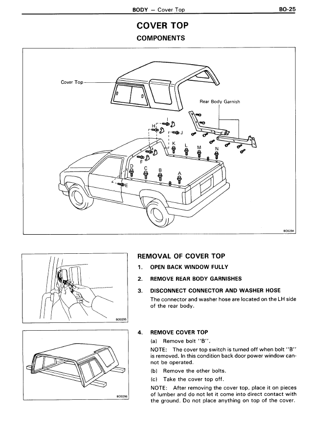

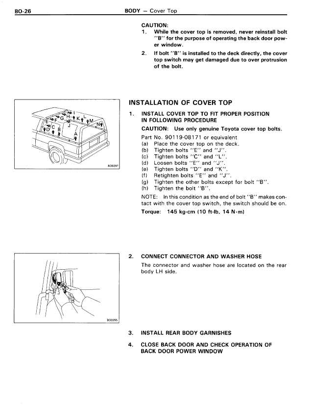

roof removal
Take out the bolts, pull the top off.
No, seriously, it's that easy. You'll have to pop the trim pieces covering the bolts and put them somewhere safe. Then remove the bolts, then have somebody help you lift the top and remove it, it's heavy.
Lower the rear window first.
what ^^^^^ said.
