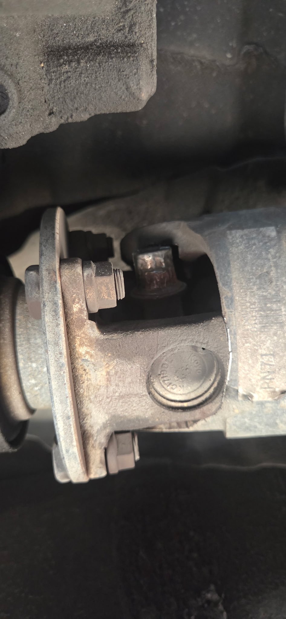

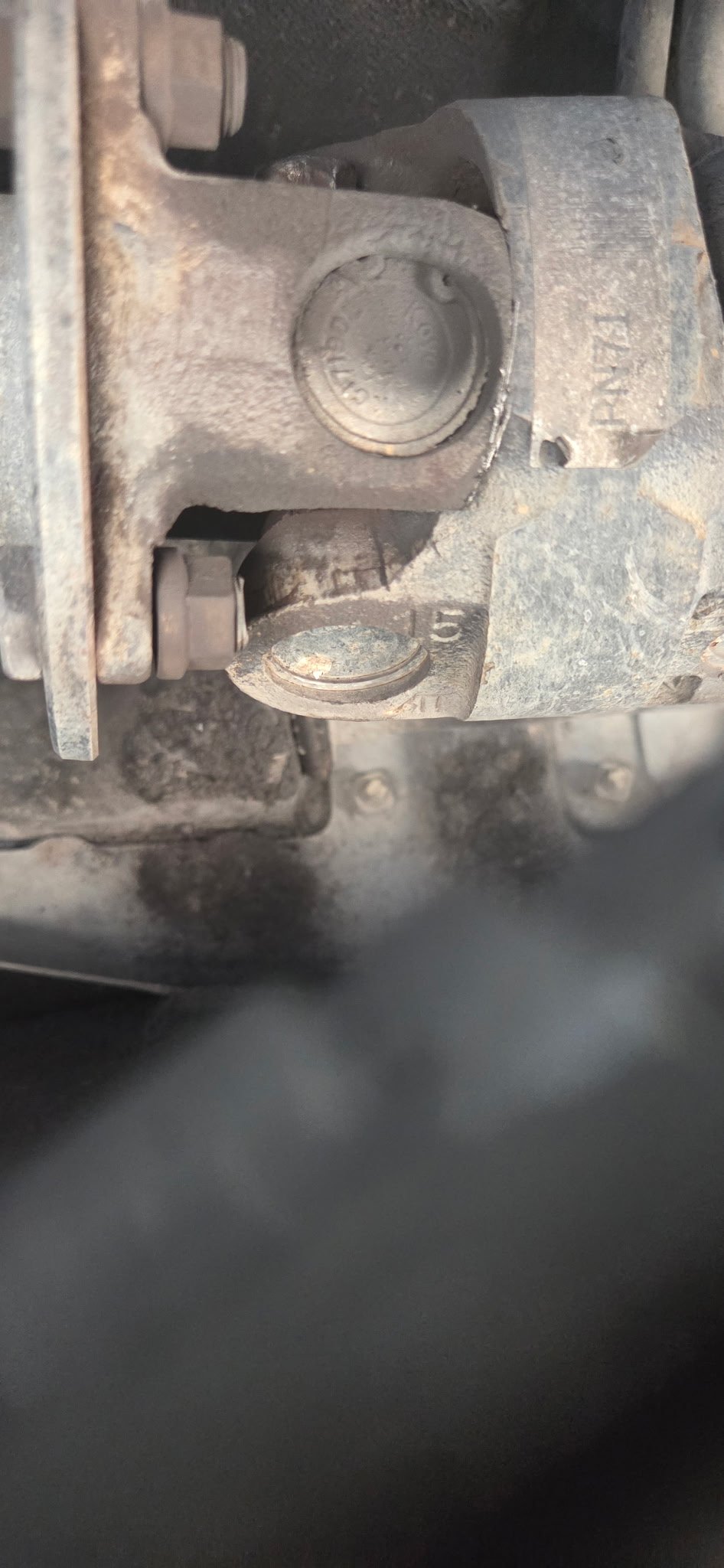

I need help removing the rear drive shaft its free from the rear portion that connects to the rear tires but its stuck at the matting surface other side all bolts and nuts removed. Is there a special tool for this and any tricks to knock it loose?

The images you attached show the nuts still in place. If those have since been removed, a chisel and hammer used carefully at the mating surface will dislodge it.

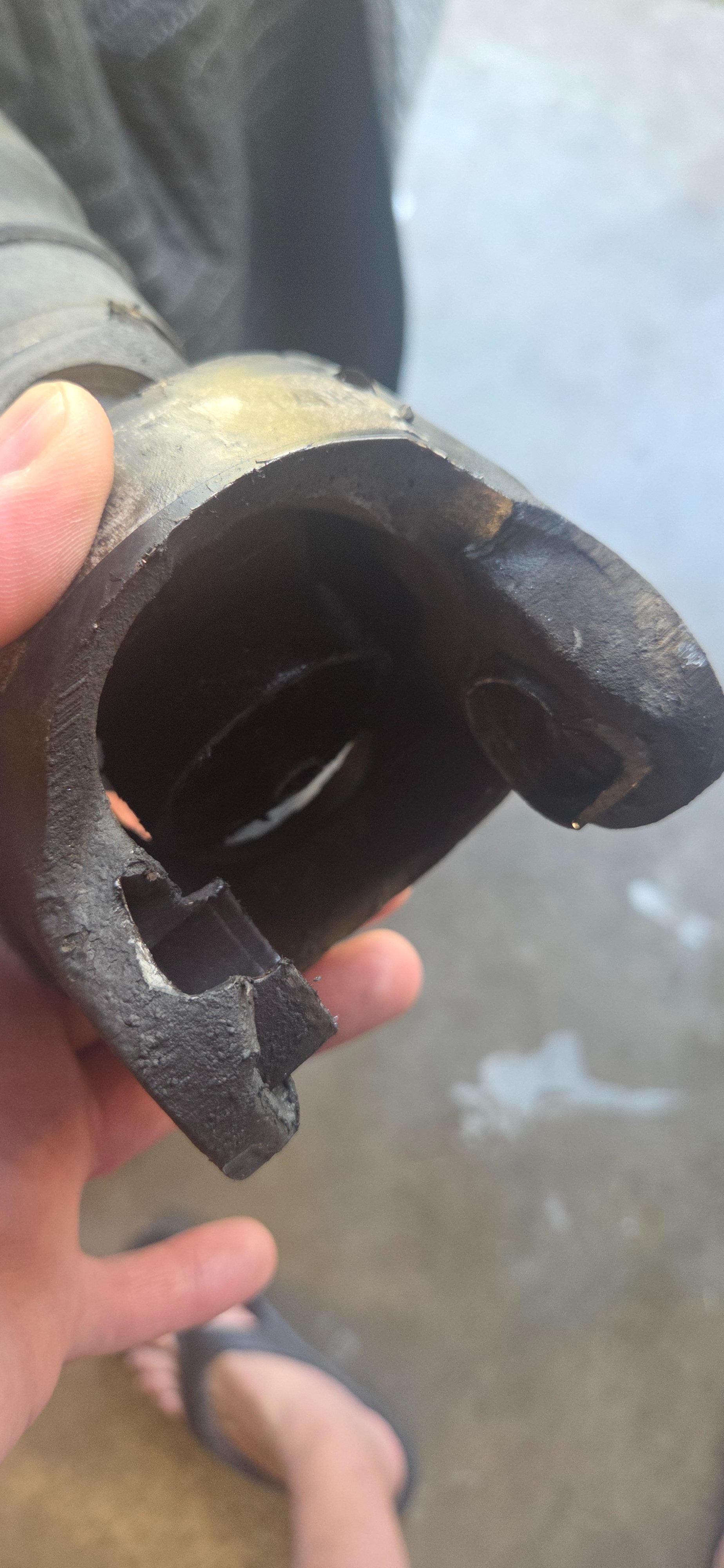

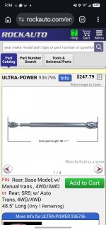

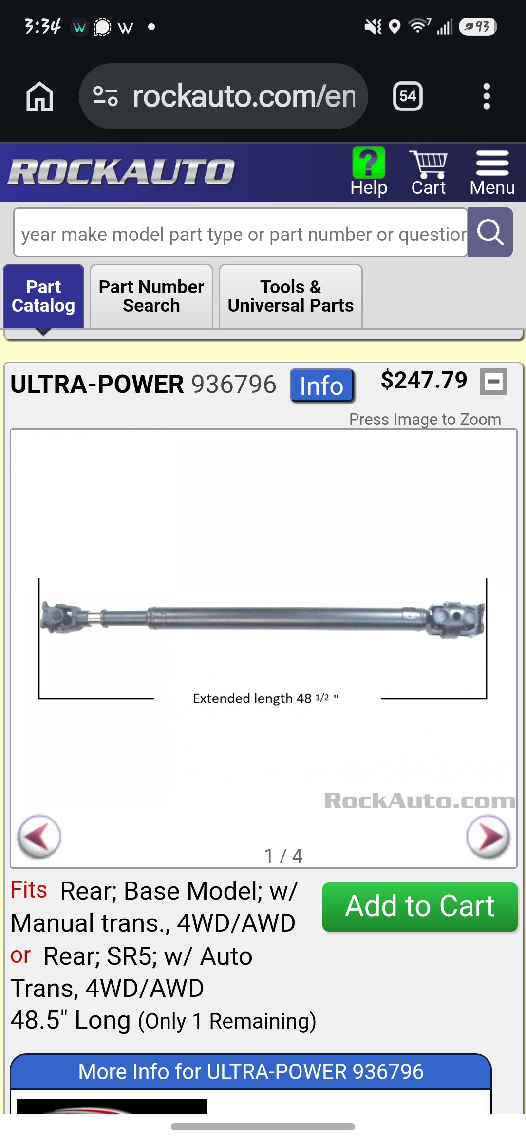

I ended up getting it off but the piece that was stuck at the mating surface seperated at the u joint its still stuck i measured the shaft its about 46in fully extended minus the stuck part i just wanna make sure this was the correct one on rock auto website its showing 48 1/2 in?

Hit that stuck part with a big hammer. Maybe after soaking in some PB Blaster or similar for a while.
Engine (4/6), transmission (AT/MT) and trim (base/SR5 vs Limited) all can change the driveshaft length. Make sure specs match your 4Runner.

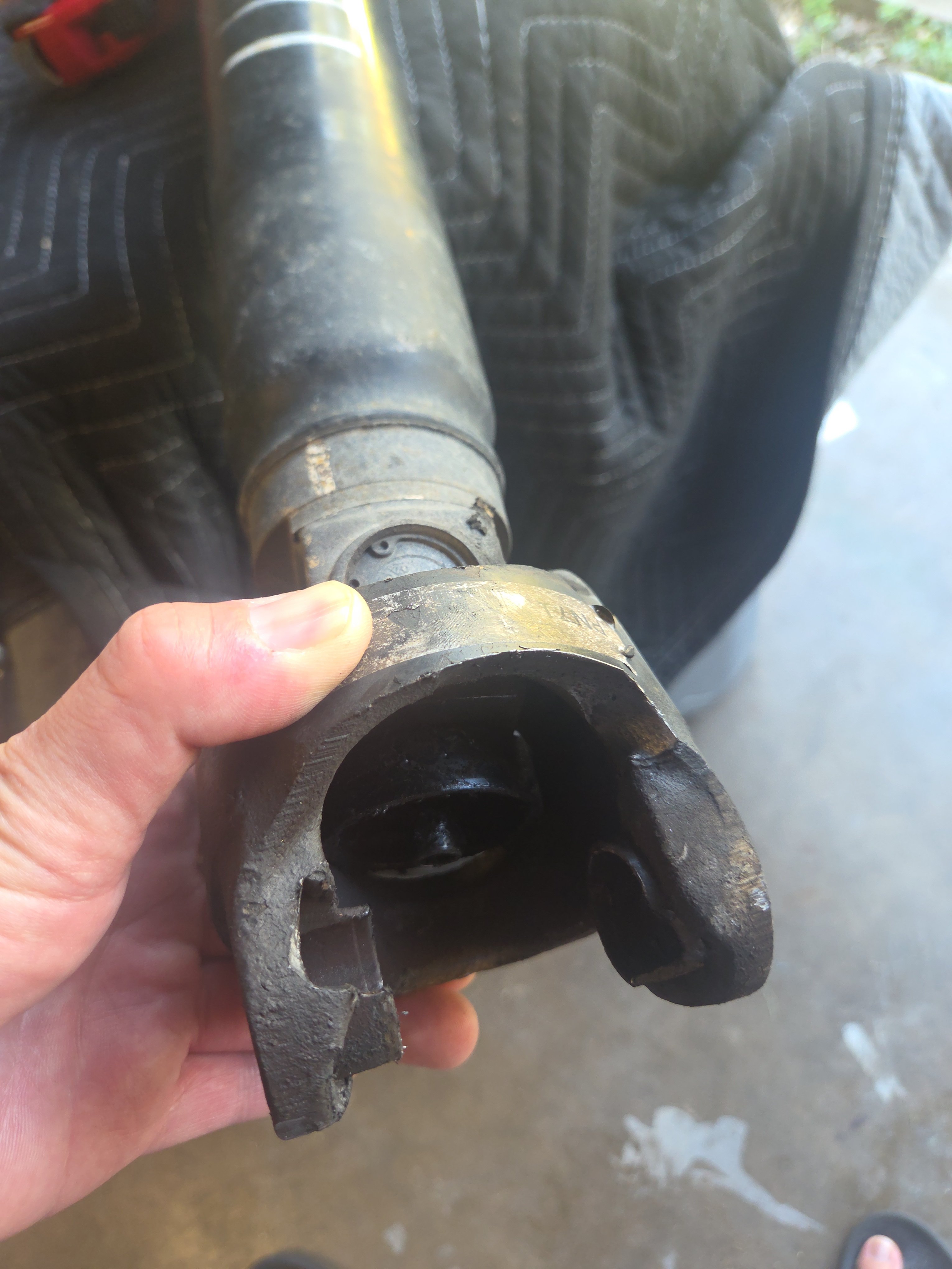

Finally got it off got a new one from rockauto anything i need to know before putting this one ? The new one has this green line on it but it doesnt match up with the white marking i made before i took the old one off
