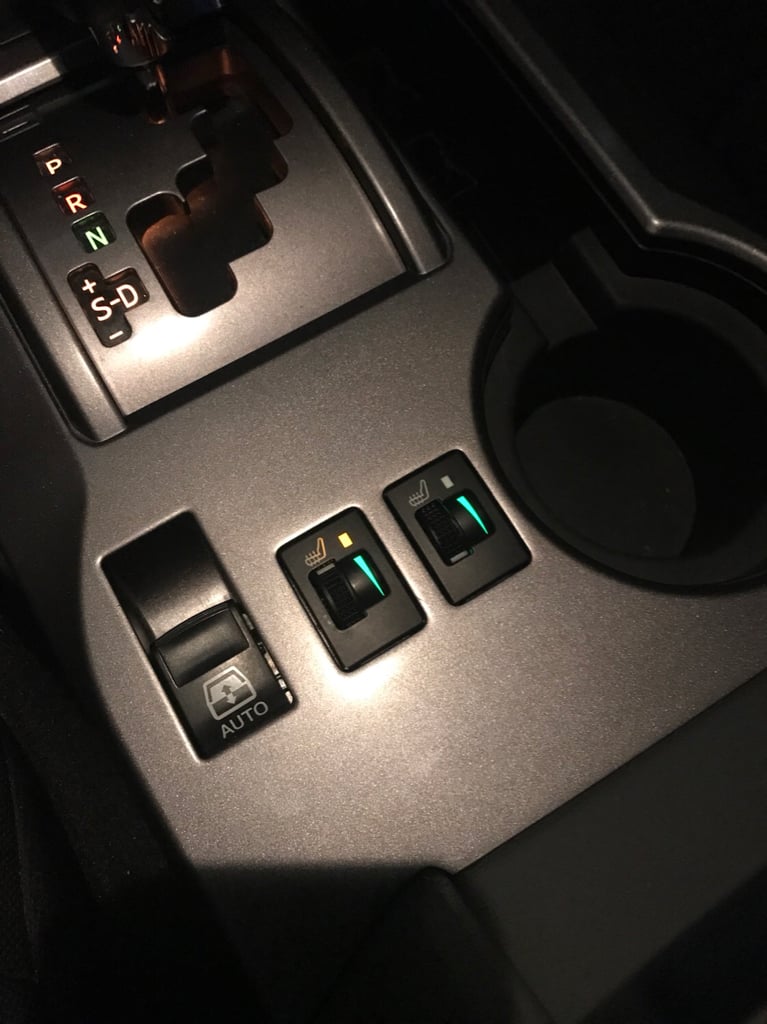

I just had the Rostra heated seats put in with cloth seats. I used to have a car with leather seats that were heated and the feeling isn't all that different. After a few days, I'm pretty happy with the way they turned out. Plus the actual controls fit into the blanks in my center console, so it looks stock.
