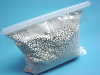

Adding the beads thru the valve stem was difficult. So, I asked Innovative Balancing for their plastic bags, which they sent. Now I can just place the bag with 5 ounces of beads when the tire is placed on the wheel.
Permanent balance for the life of the tire? I'm excited about that.
