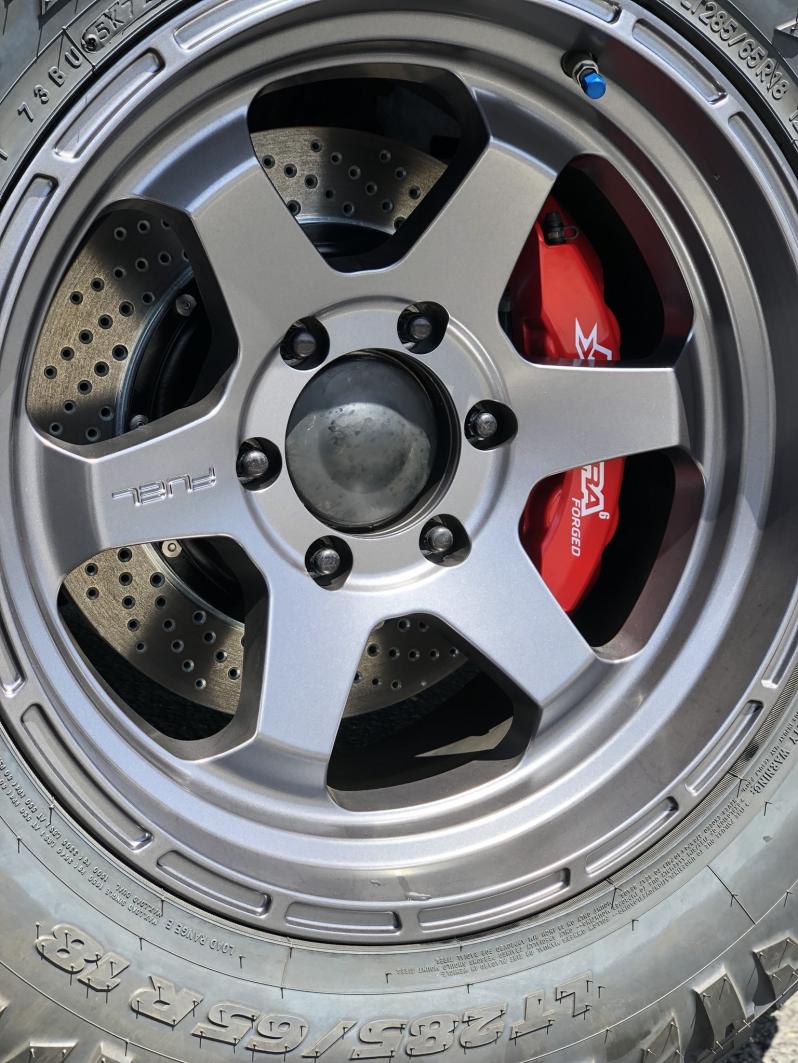

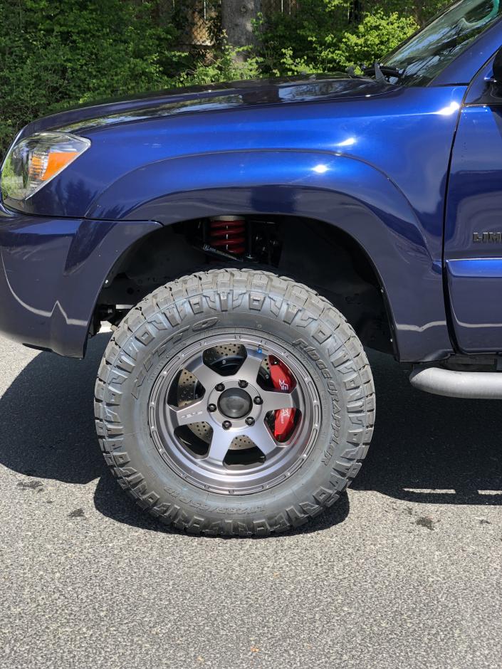

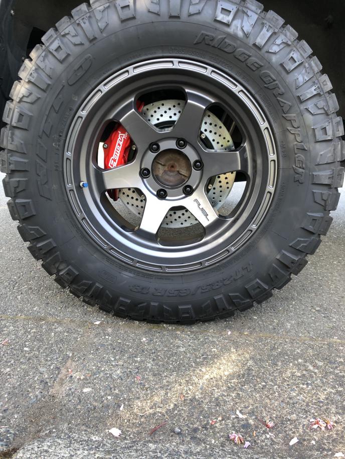

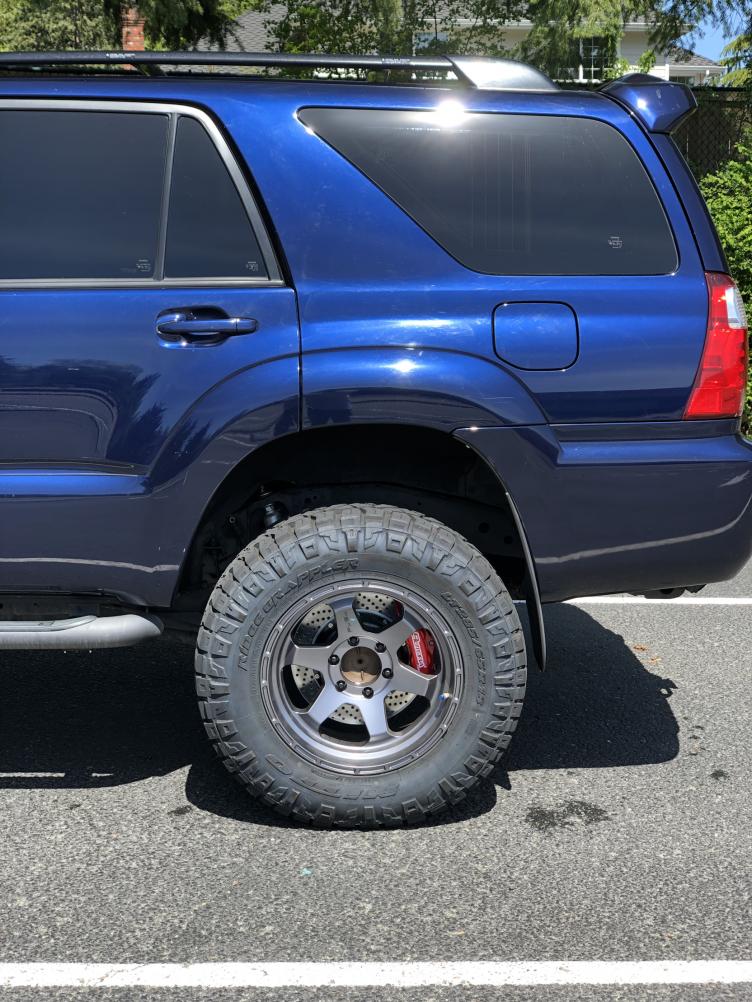

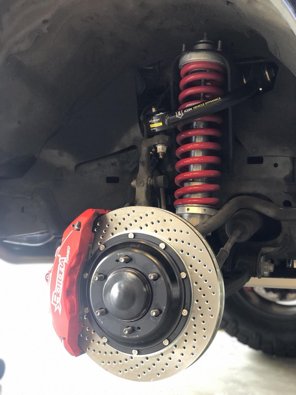

After adding the heavy 285 Nitto Ridge Grapplers, full skid plates, the OEM brakes were just not cutting it. I could feel the additional weight every single time I depressed the brake pedal. It simply took more effort to slow the vehicle down. In addition to the sticking calipers, the shimmy due to warped rotors, (due to the vehicle weight and living on a mountain), and in anticipation of adding a winch bumper, sliders, roof rack, etc... I started looking into aftermarket solutions.
Big brake kits are not cheap. Many folks are not keen on spending thousands on bigger brakes and this is clearly not an upgrade for everyone. I spoke with Loren at Rotora and ordered the 14” front and rear rotors with forged aluminum calipers and stainless lines. Installation went without a hitch. Rotora brake pads are now bedded.
Arguments against BBK:
-OEM system is adequate
-Once ABS kicks in BBK do nothing more to slow the vehicle down
Counter arguments:
-Even with OEM wheels and tires, sticking rusted calipers, warped rotors, and fade seem to be a regular problem secondary to heat. Add bigger tires, trail armor, any amount of towing and the OEM system which is already struggling is easily overwhelmed. Adding larger rotors provides a bigger heat sink and results in less fade with repeated use. Pushing the lever arm out with larger rotors and calipers will assist with slowing the vehicle and require less effort in terms of pedal pressure to do so. Threshold braking obviously takes far less effort.
-Engaging ABS occurs faster and takes less effort.
Initial impressions:

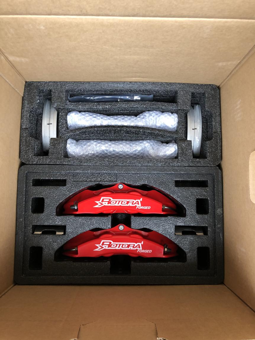

Packaging: 10/10. Everything came packaged in press fit and precisely cut styrofoam.

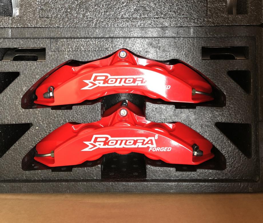

Quality: 10/10. Amazing quality. Caliper brackets are billet aluminum hard anodized black. Powder coated red finish on the calipers is spotless.

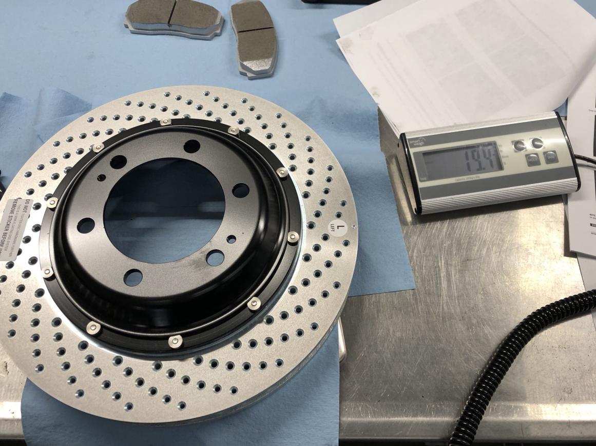

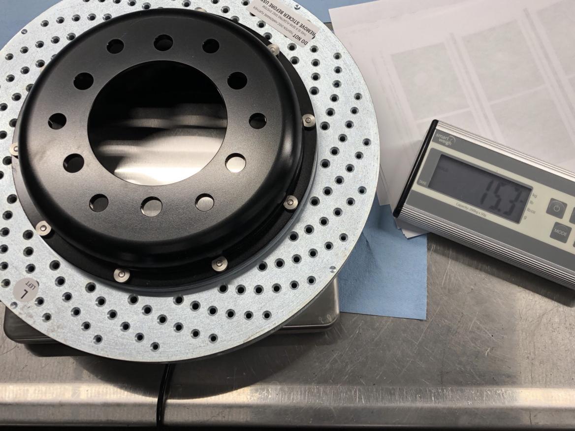

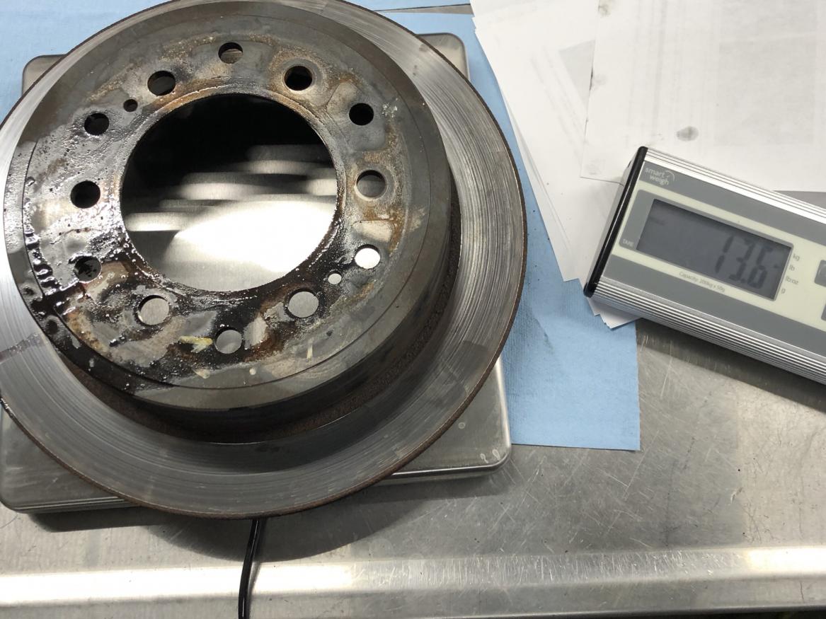

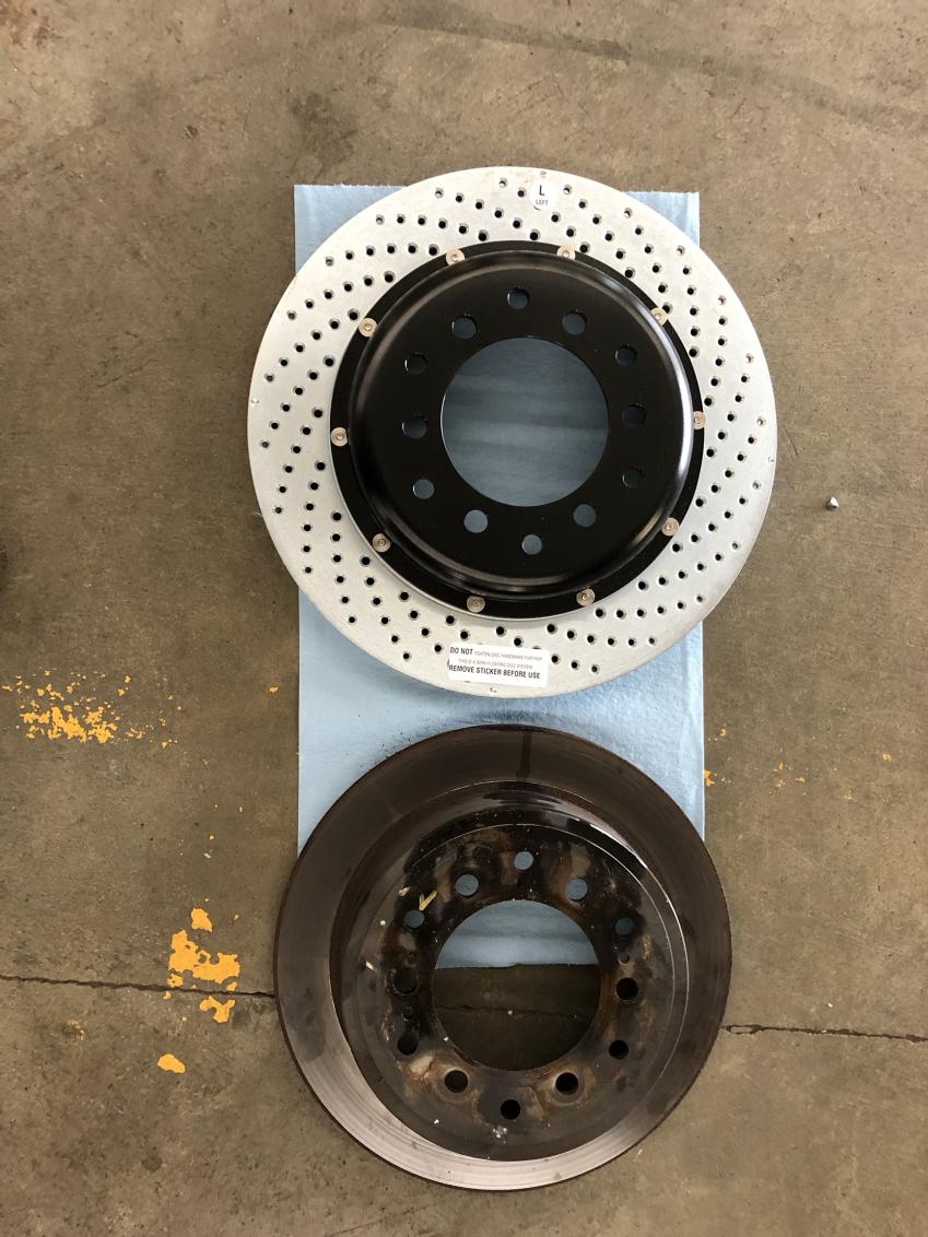

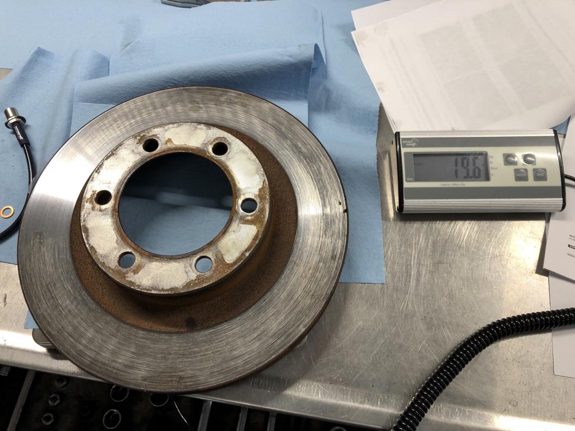

Weight: 9/10. Rotor weight was reduced in the front despite being larger thanks to the two piece aluminum hat. Rotor weight in the rear was increased as they are significantly larger than OEM. See pics.
Install: 10/10. Straight forward. Remove OEM rotors and calipers. Cut dust shields, (or remove them and place washers between caliper brackets and hub). Install Rotora rotors, caliper brackets, calipers and lines. Bleed system.
Pedal feel: 10/10. Takes significantly less effort to slow the vehicle. Zero fade after repeated slowing from 50-5mph x 10 attempts.
Emergency braking: 10/10. Tires skid with less effort and ABS kicks in sooner.
Overall: 10/10. Tremendous improvement over the OEM system.

Looks great and I’m sure in functions even better... did you change out all the soft lines to ss brake lines. Also did you flush out the brake fluid system? How hard was it to get the system to completely bleed all the air out?
Very Nice!
Just a question and a confirmation, does the parking brake function correctly?
I believe you stated in an answer to my question in another thread that one would have to have 18" wheels for these to be installed, correct?
Yes, the stainless brake lines were included with the kit. Flushing and bleeding the kit was not difficult. Used both a pressure and vacuum system. Six 12 ounce bottles of OEM fluid did the trick. I read somewhere that the master cylinder for the 4th gen has a defective seal. Can only use OEM brake fluid apparently.
Very Nice!
Yes, the rear hats were designed specifically to work with the 4th gen parking brake assembly. Rotora also makes hats to work with the 5th gen parking brake system which I believe is a bit different.
Correct. 18” wheels are required to run 14” rotors.
were you still able to use the original master cylinder? I hear that the cylinder needed to be upgraded to a larger one to accommodate BBK.
Not sure where you read that but it is absolutely not necessary with this kit. I mentioned in the original post that the larger heat sink and moving the lever arm out is what make the biggest difference.
Let me put it this way... this kit already significantly reduces the amount of pedal pressure required to slow the vehicle down from any speed AND requires less pressure to engage ABS and stop the vehicle. Clamping force and friction between the pad and rotor is not an issue with this kit. So what would be the benefit of upgrading the master cylinder?
