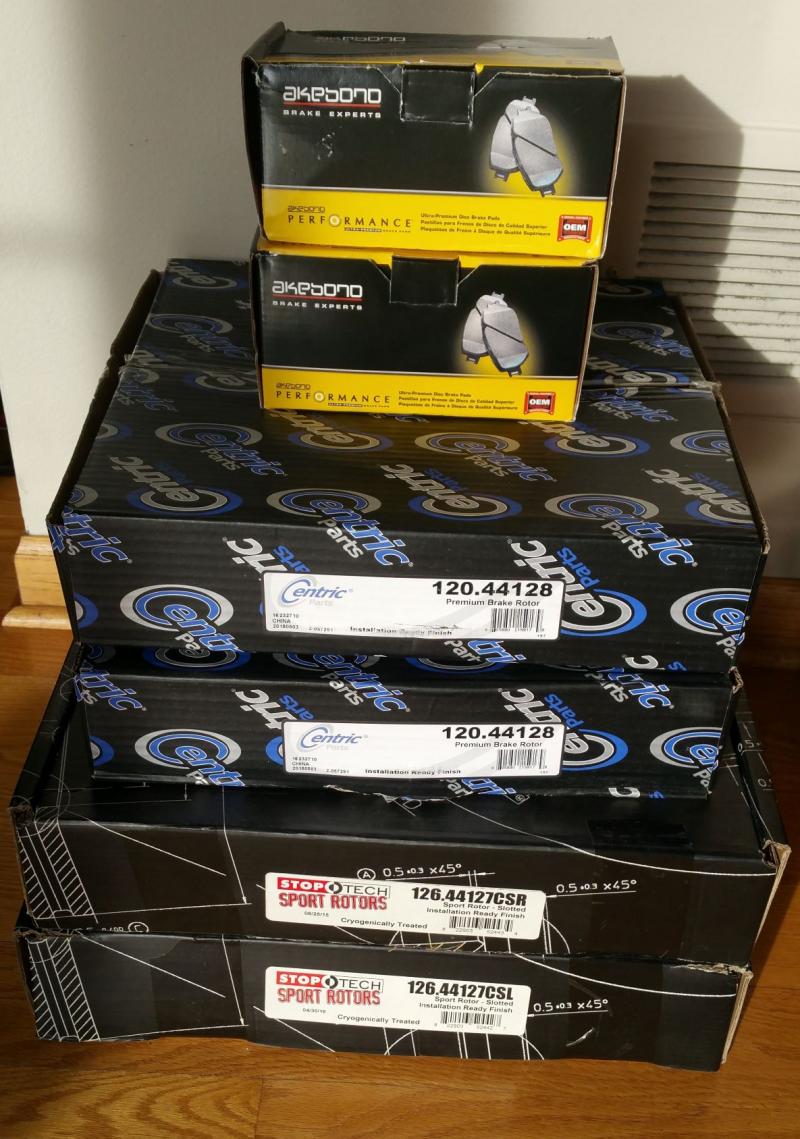

Larger rotors will not increase stopping power. Only larger calipers & performance pads will do that. There is also no consensus that 5th gen components perform any better or are any less failure prone. Performance differences are all minimal as there are no OTS larger calipers that are direct fit for our runners.
I would just go with the larger 4th gen sport options if available.
For the calipers, I would go with a cheaper box brand that carriers a lifetime replacement because they will inevitably fail eventually. Can paint/PC them red yourself if desired..
My last upgrade was with centric rears, OEM calipers were fine. Stop tech slotted cryo fronts and Akebono performance pads all around. Ended up replacing the front calipers with O'reilly since I didn't know my PS was stuck until I started. Used the lifetime replacement warranty a year later when one was sticking and they replaced both without question.
