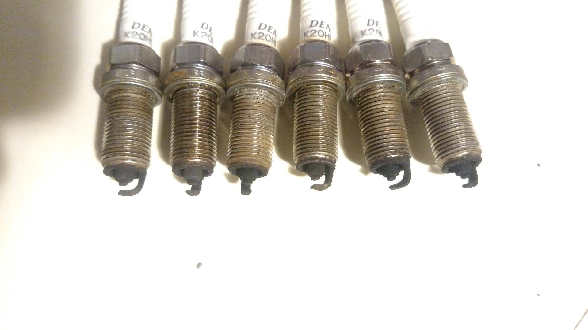

The plugs were definitely in need of changing. I don't know why I thought they were good for 100k miles. Will change them at 30k now. The problem still persists. I refueled on Sunday and did about 90 miles and the tank is already almost at half empty. Do I need to reset the ECU after doing plugs?
The plugs were definitely in need of changing.... Do I need to reset the ECU after doing plugs?
I say it couldn't hurt for reasons of pure science and diagnostics -- you'll then be starting each improvement with a new baseline/clean slate/whatever you want to call it.
If the ECU was compensating elsewhere for fouled plugs, you'll want to let the ECU know that the situation (likely higher resistance) in the ignition department has been resolved.
