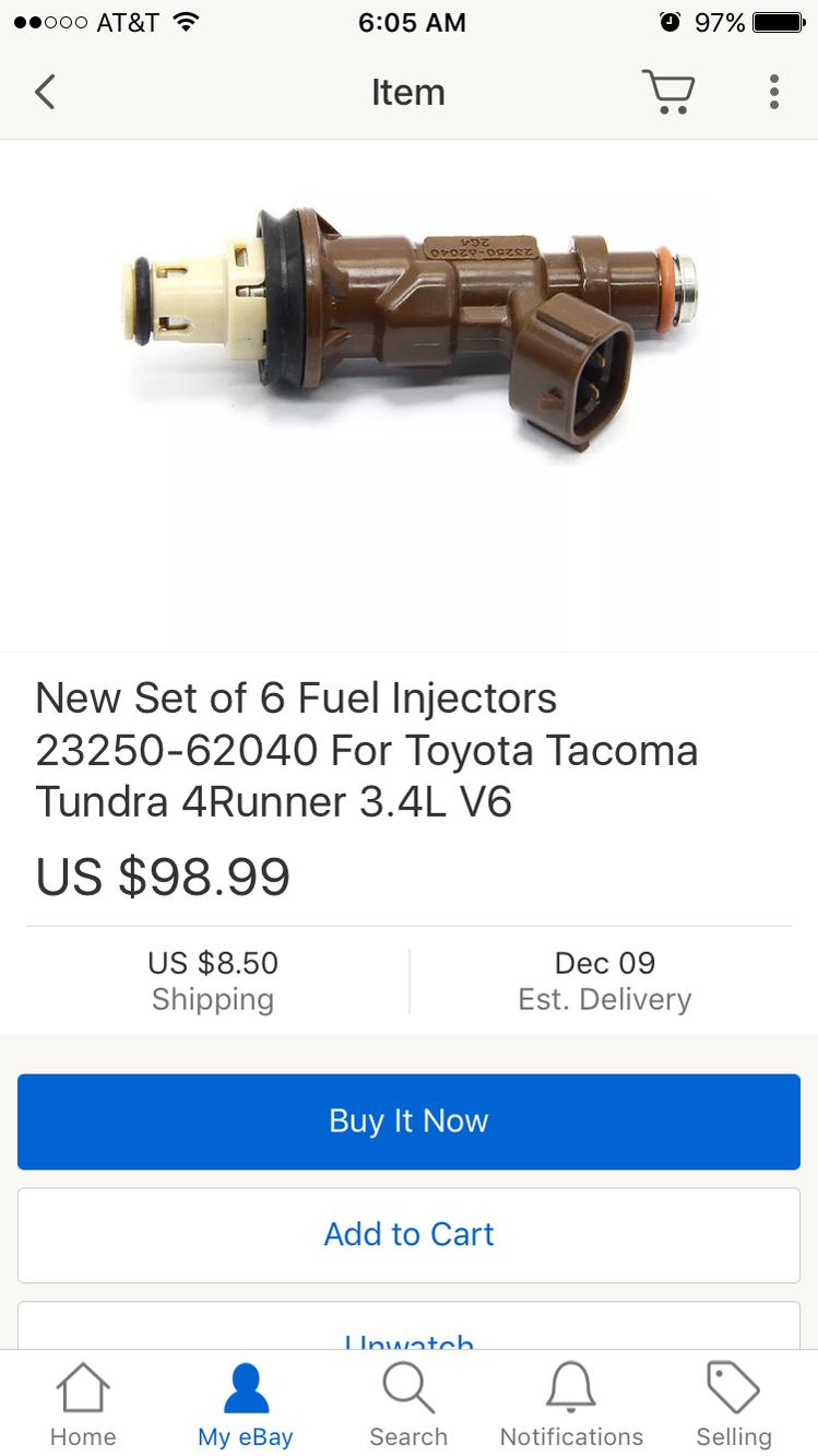

I'm going to go ahead and change # 5 injector,I can get one oem for 28 dollars or all six for 106 dollars off eBay,I wouldn't change all 6 but should I change the three on passanger side or just the #5?
They come with orings so it looks like I just need maybe banjo washers for the fuel rail?
Is the oem aisin?
Looks like I need o rings,fuel rail washers and vasoline?
Are these oem
Aisin brand
