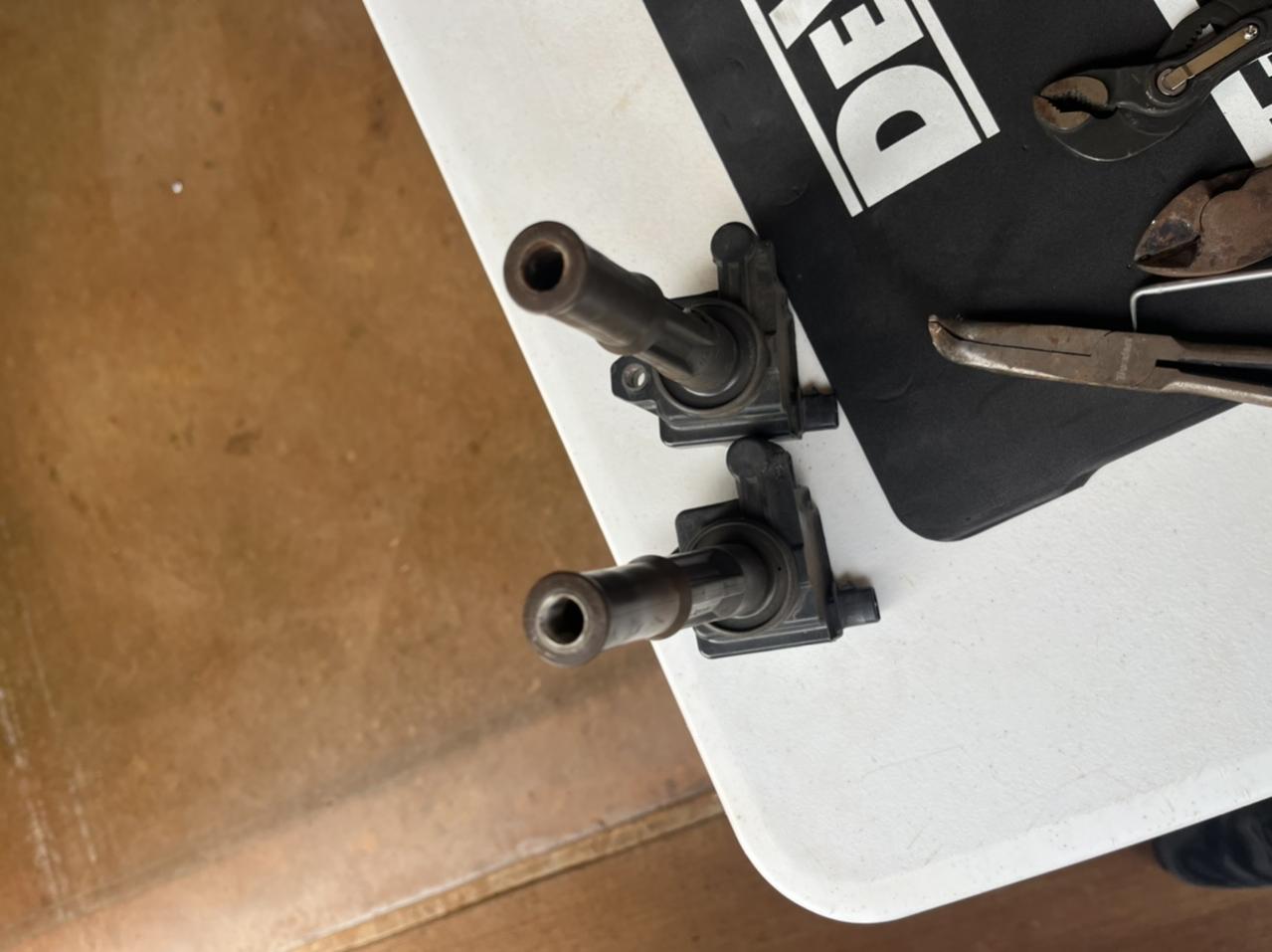

Coil on the bottom looks worn, from the bad cylinder 5. Coil on the top from cyl 3. Swapping now.
Update: Swapped 2 coils, reset the CEL, misfire returned, CEL displayed the same cylinder 5. While I was in there, I inspected #5 spark plug. It appeared slightly fouled. Will replace that plug, try again and follow gamefreakgc advice and ohm test the #5 fuel injector.

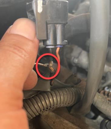

Thanks for all the replies. I discovered an exposed wire on the #5 coil connection. Looks like a past mechanic tapped into it and soldered a lead in wire. The electrical tape degraded to the point I could see it. I removed the tapped in wire, heat shrunk then taped it up some more, cleared the CEL, it ran well when cold, slight sputter returned after restart. Waiting for the code to return, as I have borrowed an improved OBD II that can do diagnostics.

Update: After repairing the wiring into the #5 coil, the CEL has not returned. It does however still mis-fire, but now it takes a couple of hot starts to return.
