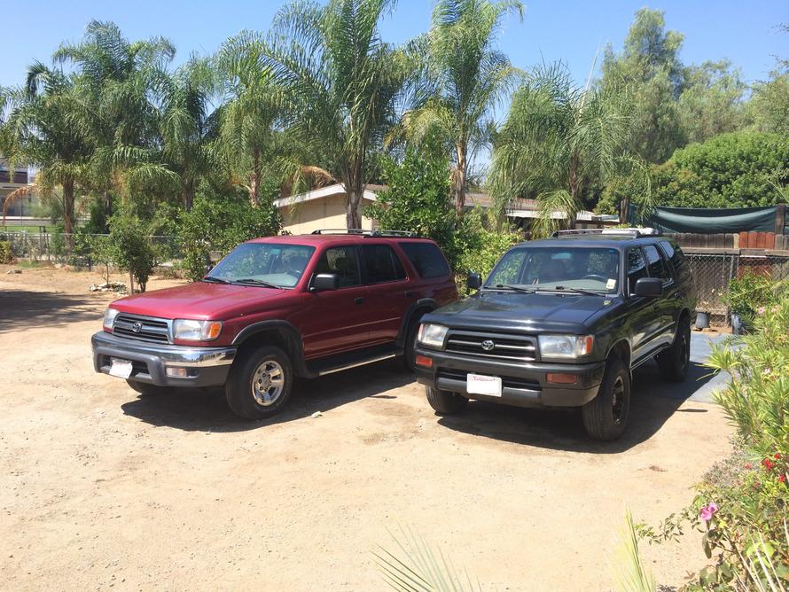

I got her done!!! I have added like 2k miles since, no more check engine lights, misfires, hick-ups, rough-idles. My MPG jumped up to 25ish. I feel like I have a new car haha. I returned my new manifold. I basically did this $2500 job with $320 or so. I'm about to change my oil again. I wanted to thank people on this forum for providing links, ideas, files and pictures(that's why I joined). and If you have questions, I'll try to answer to the best of my knowledge. Ill try to add more pictures to my albums so you can see it. Its the gray one I rebuilt.
