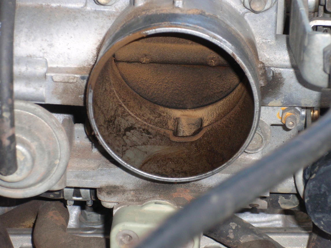

I finally took apart the air intake and found some of the problem, I cleaned the MAF again for the 2nd time this month, Idling very nicely now, smooth and feels like more power, just got a new tank of gas, cant wait to see the MPGs skyrocket to 30mpg!!

wow thats nasty.
If I were you Id do an iduction cleaning and an oil change.. All that dirt cant be good.
wow thats nasty.
I thought about taking off the entire throttle body and cleaning it, but I dont really have the time energy this month...
I used almost a whole bottle of Throttle body cleaner and its running super smooth right now, so Ill leave it be for a few weeks, at least til after my sons 4th bday.
Why would I do an oil change?? the dust/dirt never touched my oil?? the fuel/air mixture stays completely separate from the oil... if I was burning oil I would have another issue altogether.
now on the other hand... my sister NEEDS an oil change, her friend left her oil cap off and she didnt know it for like 2 weeks til I did her brakes and found it missing, luckily, the engine is fine and running well.
