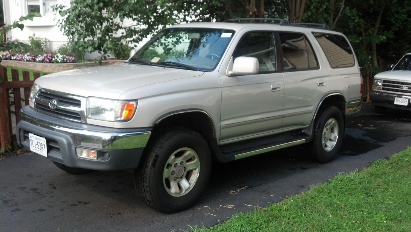

Hey everyone. I was curious what most 4Runners RPMs are when they cruise on the highway at 60mph. I drove my sisters 02 SR5 4x4 V6 Auto - and it was around 2100 RPM's at 60mph. But my 99 SR5 4x4 V6 Stick was around 2600 RPMs. Is this difference normal? BTW I just got the 99 about 3weeks ago - it has 83k miles.
