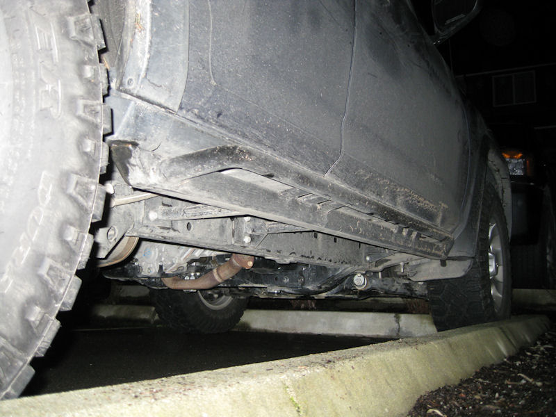

There is a "oh yeah, make sure that you have them on the correct sides" kind of thing. Of the three supports, the two closest together go under the rear door, not the front.
Well, after posting I was becoming more and more convinced I had them on the wrong way around, but I had them set up the same way SeattleMike had them, with the two struts closest together at the rear. Does anyone else's 2011 TE not have the threading in the frame for the bottom hole of the middle strut?
