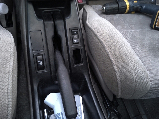

1st pic: no red light sensor ever present, bought truck private party 6 months ago and this spot was always empty

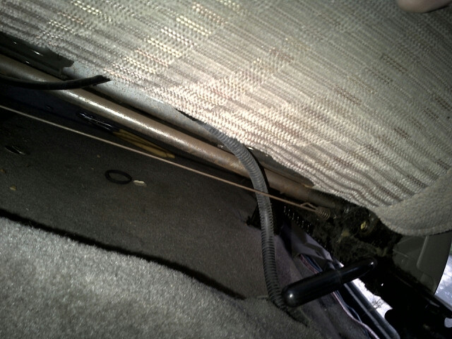

2nd pic: under driver seat, i've slit the rug and looked under - nothing

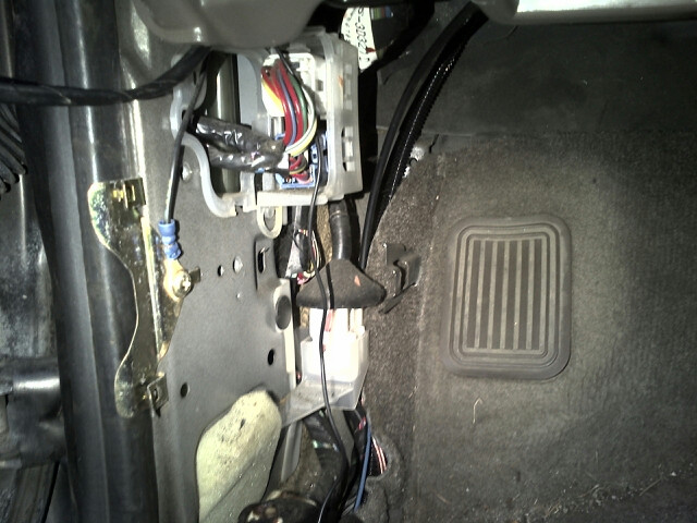

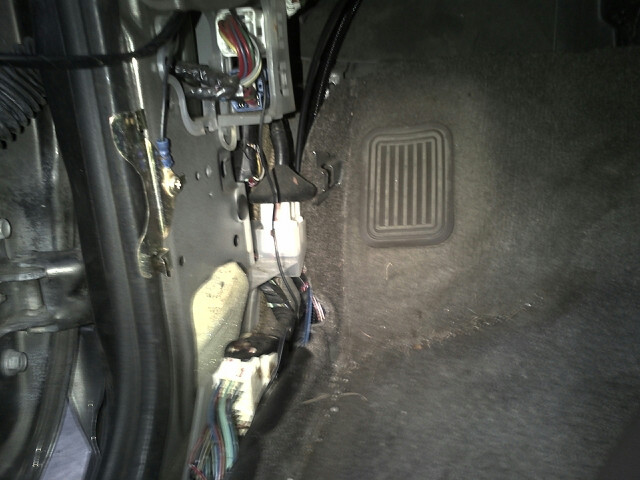

3rd pic: driver side kick panel
4th pic: kick panel close-up
Do you see anything that looks like the brain or the valet toggle switch

sorry bud. you're kill switch isn't in the same place as my 96's. you would have had to disconnect it to pull the kick panel all the way out.
on a seperate note it looks like someone has done a little wiring on yours. do you have an aftermarket stereo? that ground looks added. maybe it was tucked up in the kick panel somewhere?
I'm really not sure how many different locations there were for the brains or switches. I only have my two 4runners to compare it to. (96 and 02) You're situation looks different then both of mine.
edit: also, its quite strange that cycling the key isn't working for you. do you have power to you're accessories when you turn the key or just nothing? or will the key just not fire the motor?

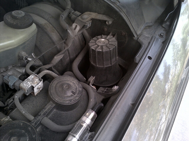

Try looking for the chirper under the hood and back trace the wiring to the module. The chirper on mine was beside the battery wrapped in foam.
Does this look like it could the chirper? Don't recall having this on my 2000. There are 2 wires (red/black) that run from this through the firewall directly to under my steering wheel. I don't see the ecu there but I am going to keep looking

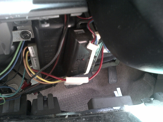

Breakthrough
This picture shows what looks to be both the keyless entry module as well as the alarm ECU zip-tied under the steering wheel column. The keyless entry module is already unplugged (which makes sense considering I never received the key fob) and there looks to be a valet switch of some sort. I will update when hopefully this is resolved
Wow that was an annoying weekend. Big thanks to everyone who provided insight. I took the keyless entry module out completely, disconnected 2 of 3 harnesses that go into the alarm ECU (I left the door lock one in there mainly because I couldn't get it out). Truck started right up, no issues at all and now I never have to worry about that ****ing alarm going off again next time I need to disconnect the battery.

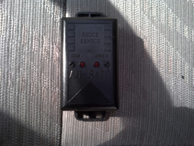

Hey guys, I am working with 1985taylor1925 right now to see if he wants it. I might have been wrong about it being the keyless entry module as it reads "shock sensor" on it. Picture attached, if he doesn't want it I will move down the line in terms of who contacted me after him. Sorry for the confusion.
Ya, I dont think that is the keyless entry module. I think the keyless is part of the VIP module/ECU. But maybe someone else can shed some light on what the shock sensor is for?
