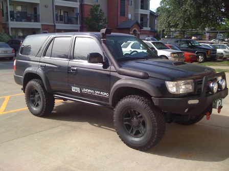

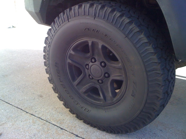

I have done it to my wheels. I like it. I used Rusteoleum (sp?) professional rubberized undercoating. NOT the bed-liner one. The rubberized undercoating seems to have a finer texture than the bed-liner (I have tried both) and if you do it, get the professional one, (it just says professional on the can) its only $2 more but it gave a move even texture and application.
As far as balancing, I just tried to get an even coat. I didn't remover the tires, just taped off. Seems to be OK, I don't notice any vibrations
EDIT: I did remove the wheels from the vehicle though, the lugs I just painted flat black by the way
