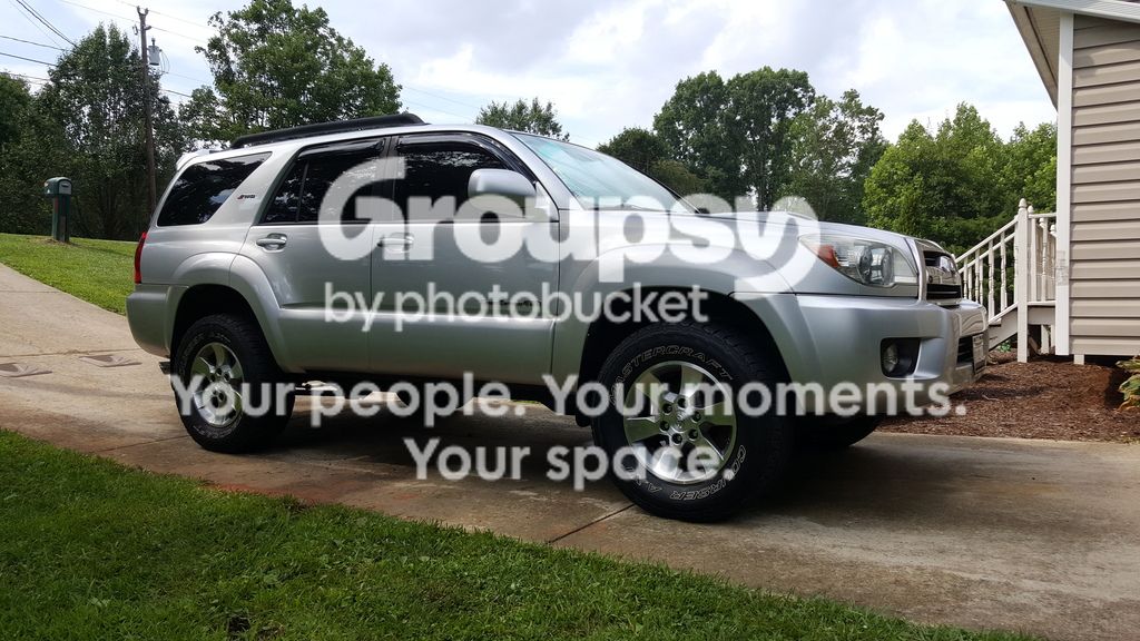

Just purchased new tires (265/70/17) for my 2006 4Runner running 2012 SR5 wheels. I've got 5100s on 3rd setting and Spidertrax spacers. Well now it's rubbing bad. It didn't rub with the factory 6 spokes, but I guess the offset is a lot different. Any suggestions (besides the usual "moar lift".

Tires are larger(~1'') than factory size, and you've increased the scrub radius by adding more aggressive wheels as well as wheel spacers.
Time to lift or trim.
Lifted with wheel spacers and not even on larger than stock tires yet and I rubbed. Trim away until the noise stops.
This setup (265/70/17 on 5100's, stockish rims) may fit (no rubbing) without the spacers right?
Would it fit without the lift?

It may have been posted already. Search J.A. user name. He has quite the write up. My only suggestion in this project is using masking tape to define the line you want to cut. Stand back and look at the proposed cut line and change as needed. You may have to re cut since we are cutting less not more. As a side note: your driver side may not be the same as your passenger, so don't bother making critical measurements side to side.
