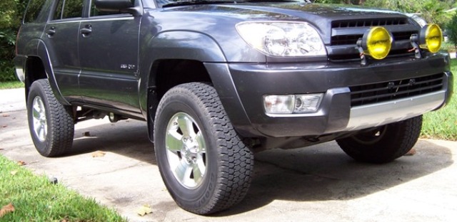

I have 260/75/16 BFG AT and I love them. I went with the 32" mainly because of availability. Sams Club stocks the 265/75-16 but not the 265/70-16. I would have to order the smaller ones and pay more. I ran them for a year or more before the lift was on it and I never noticed any rubbing. No sounds or marks in the fender well. I have never had an issue on wet pavement and they are great in the Maine winters. General makes the Grabber AT which looks real similar but I think you might be limited to a E rated tire. (E=10 ply=very stiff ride) I have a D rated (8 ply) and my wife could tell a difference but not enough to really complain. Here are some recent pics of mine with the BFGs.
