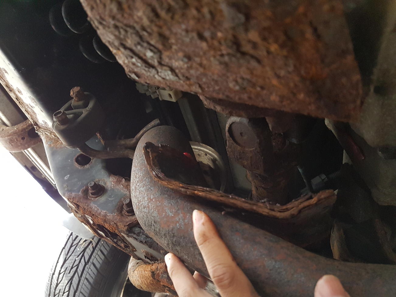

Mine sounds and behaves like his. I got under and found that everything about the exhaust are still tight. But the dust shield protecting the front u-joint rusted and softened so it's barely touching the exhaust pipe below it. Maybe that's the problem.
The dust shield (not sure if that's the name, see the pic) is hung there by a single bolt on one end, and above it is the rotating drive shaft. I can't think of a way to lift it up a bit so it won't touch. Maybe I'll just have to live with the rumble till it rust off completely then get a new one.
Any suggestion? Thanks!
