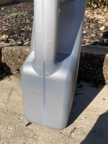

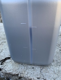

Remembered that I had an empty 5-qt oil jug. Drained my catch pan into it, and look at that—2qt even. I added 24 oz before letting it drain after warming up, which is 2/3 of a qt, so my trans was overfilled by 1 1/3 (or 1.33) qt at the transmission shop. Extremely disappointed in that shop.

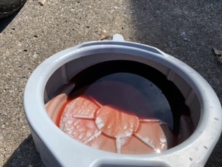

Ok. I haven't driven very much since draining the excess fluid out of my trans. In the last couple of times I've driven it, the shudder is back. I decided to take the level check plug out again after driving it. The fluid was much warmer to the touch than when I let the 4R idle for 20 min in my driveway and did my first trans fluid level check. This morning, out came more than another quart. Here is the total of the extra fluid that was in my trans:
Looks like my trans was overfilled by about almost 3 qt at the shop I had it serviced at (remember the pictured amount includes the 24 oz I poured in before I first let out the fluid level check plug).
