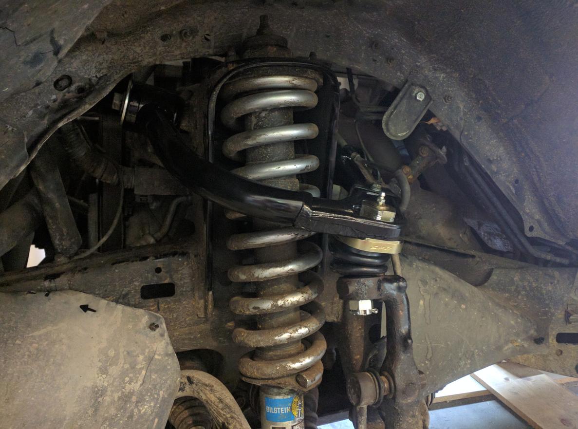

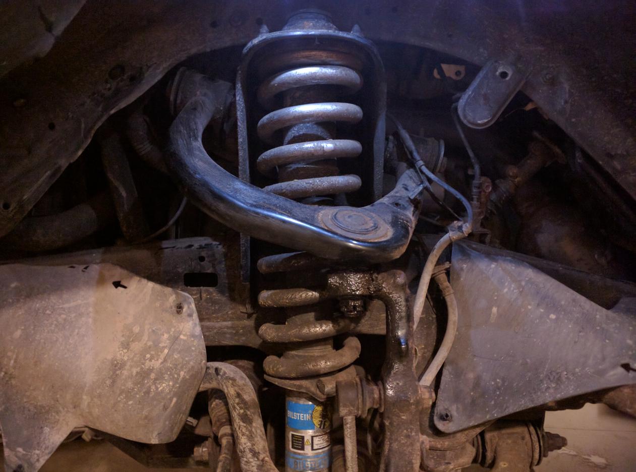

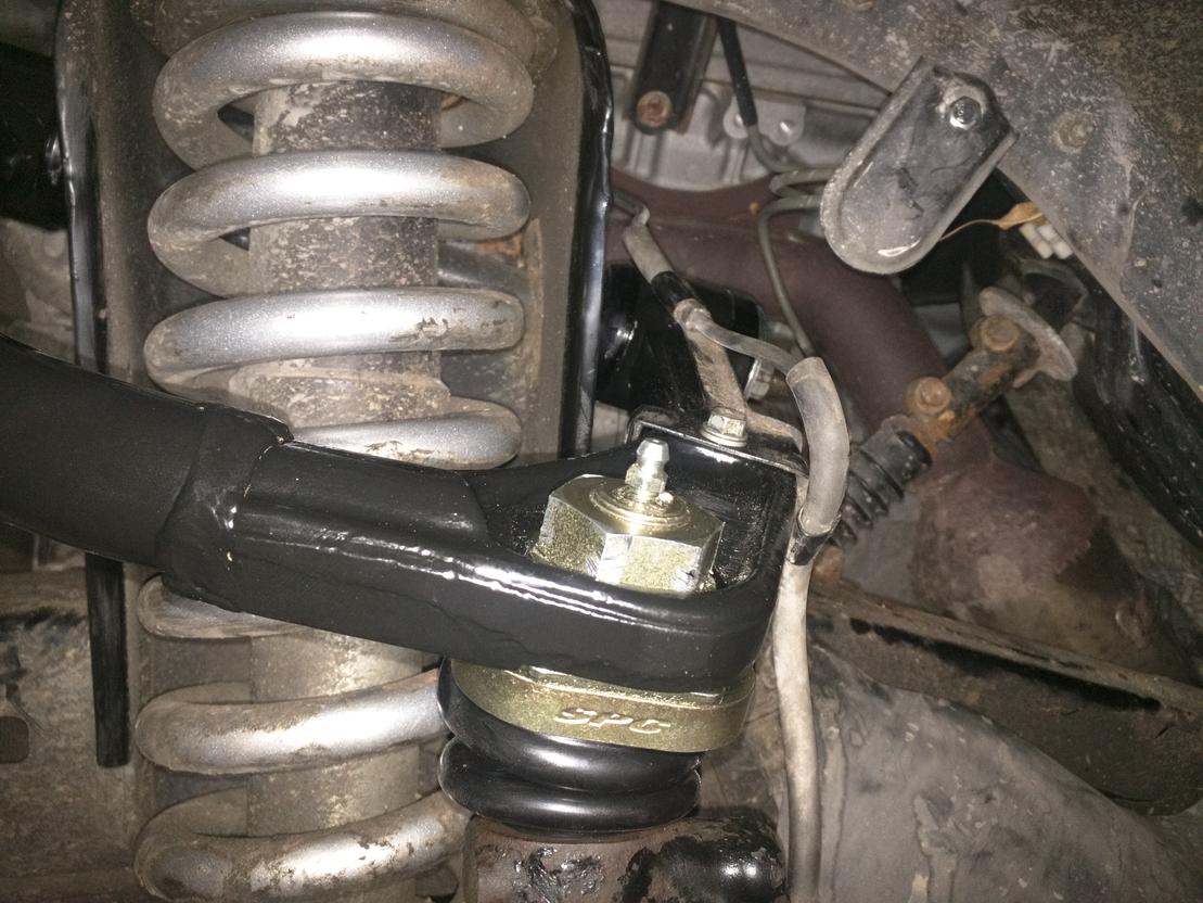

I recently got in on the SPC UCAs group buy and got a set for both my 4th and 5th gen. I am waiting to do the 5th gen with all the suspension, so I took the time I had this weekend and did my 4th gen.
Install thoughts:
Very straight forward project and nothing too unexpected came up. Total install time was right around 4 hours. I'd say 2.5 on the first side while I got used to it and 1.5 on the other side, and that was with a semi expected hiccup.
Hiccup:

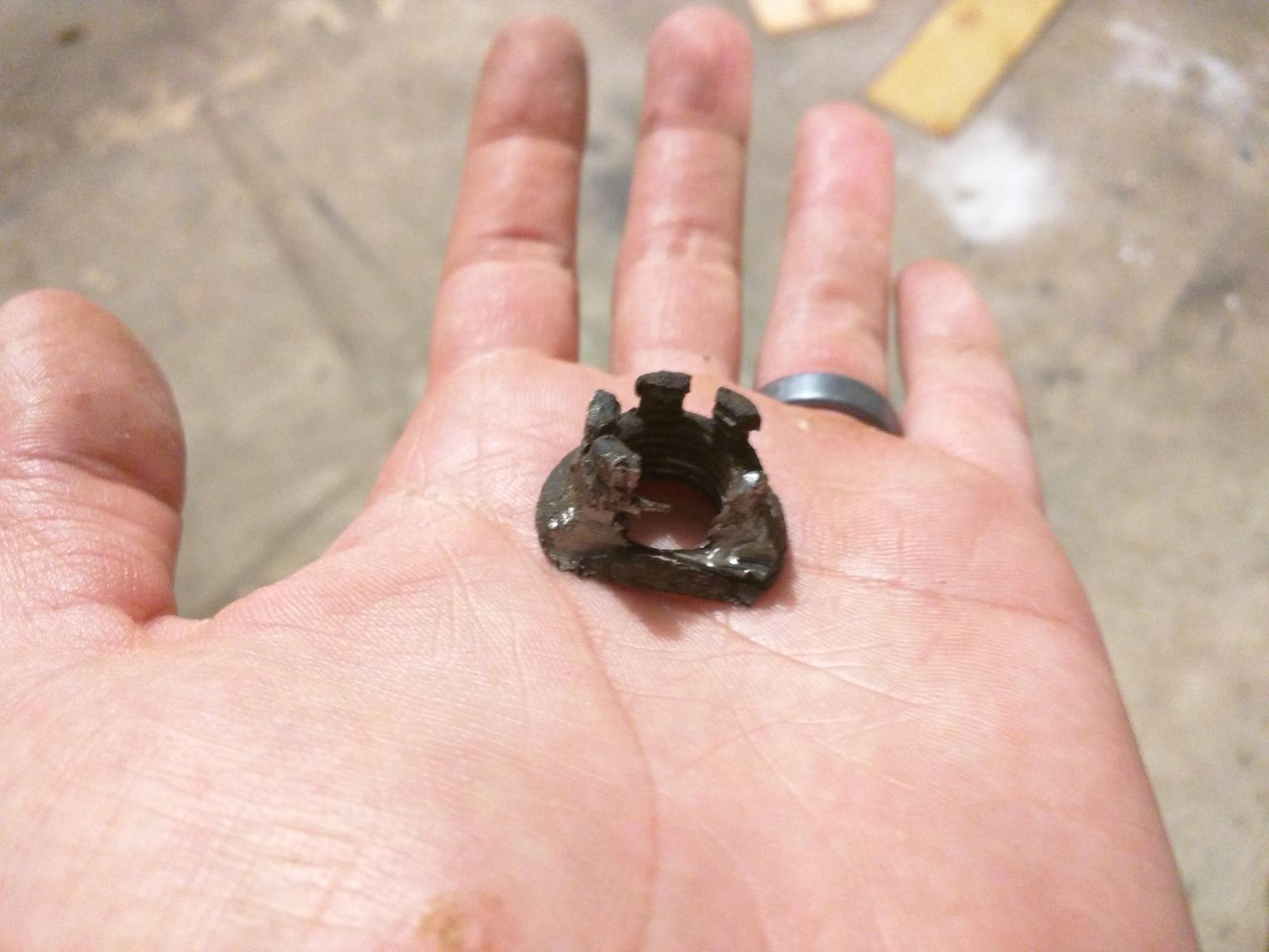

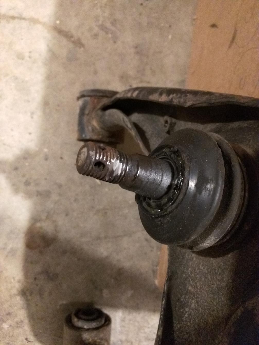

When I was installing my lift in January ( I think), I learned that the castle nut for the passenger ball joint was seized and the post would just spin. With that knowledge, I was expecting to have the second trouble with it this time around. Suspicions we're confirmed, and the disc grinder I had on call went to work.
Side note:
I tweaked my abs sensor lines so they hung a little looser at full droop. Maybe it's the extra droop from the UCAs, but they seemed a little taught. Fortunately, there's enough wiggle room in the length to reposition the wire in all the brackets.

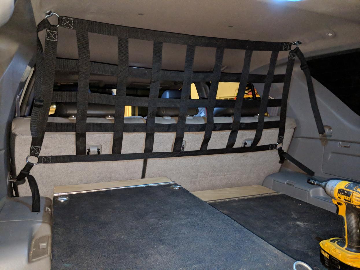

I also just finished up this little project. It's probably not the same type of material as a raingler net, but all in I'm about $12 in supplies, so that's a huge savings.
