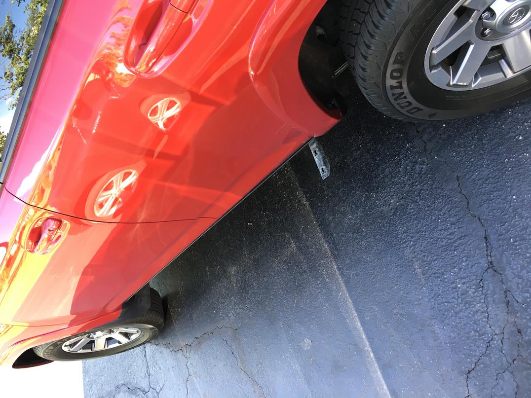

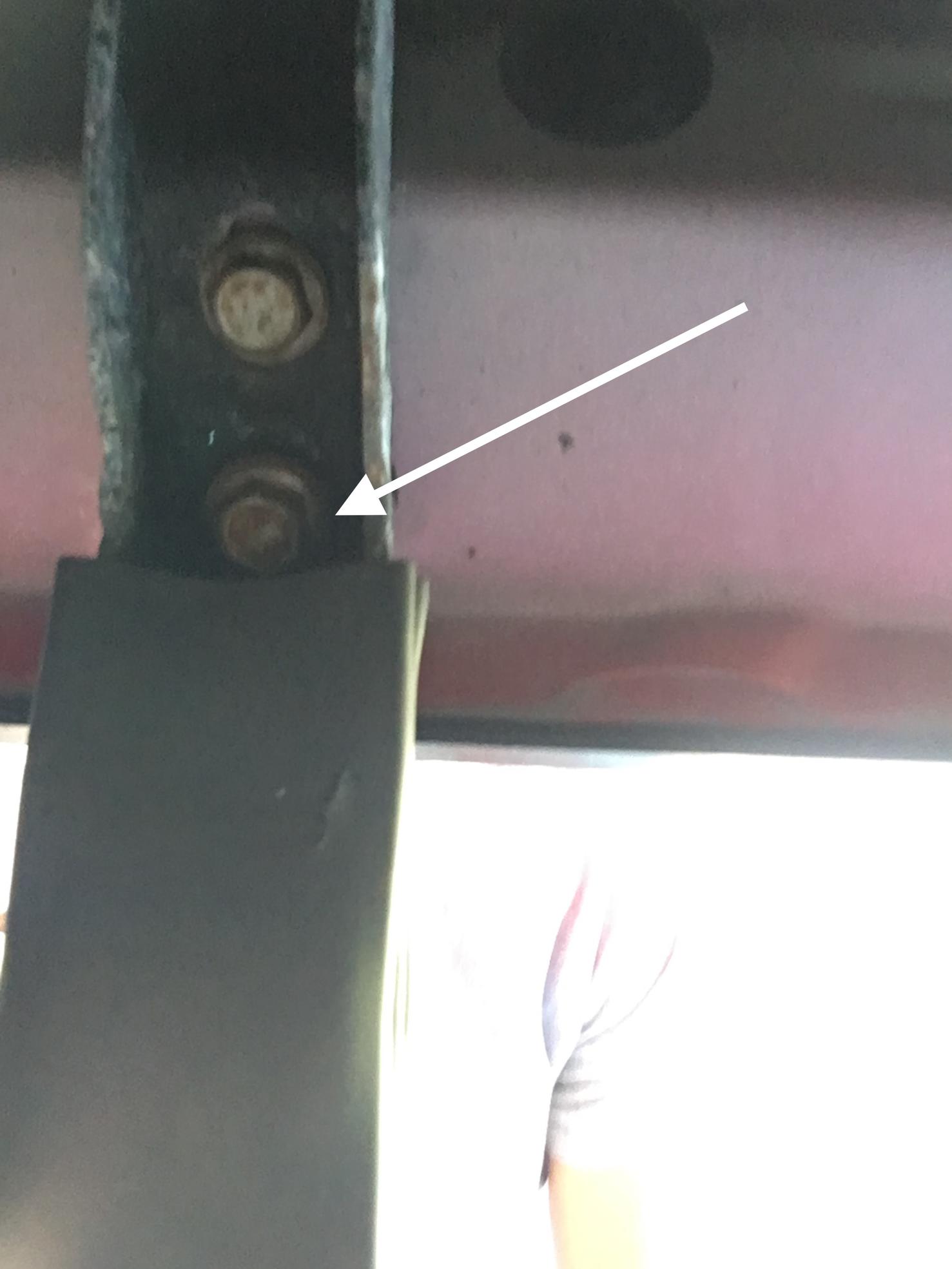

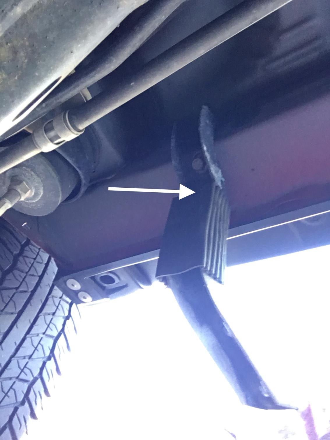

Hey all, hoping to connect to someone on an older thread (or any thread, for that matter). I'm pulling the running boards off of my '15 trail, and one of the bolts is doing the exact same thing. It seems that the nut inside of the frame broke loose, and now the bolt is just spinning. I haven't had any luck with cutting off the bolt, as I still have the bracket on. I'll post some pics below. Any help would be greatly appreciated!!
