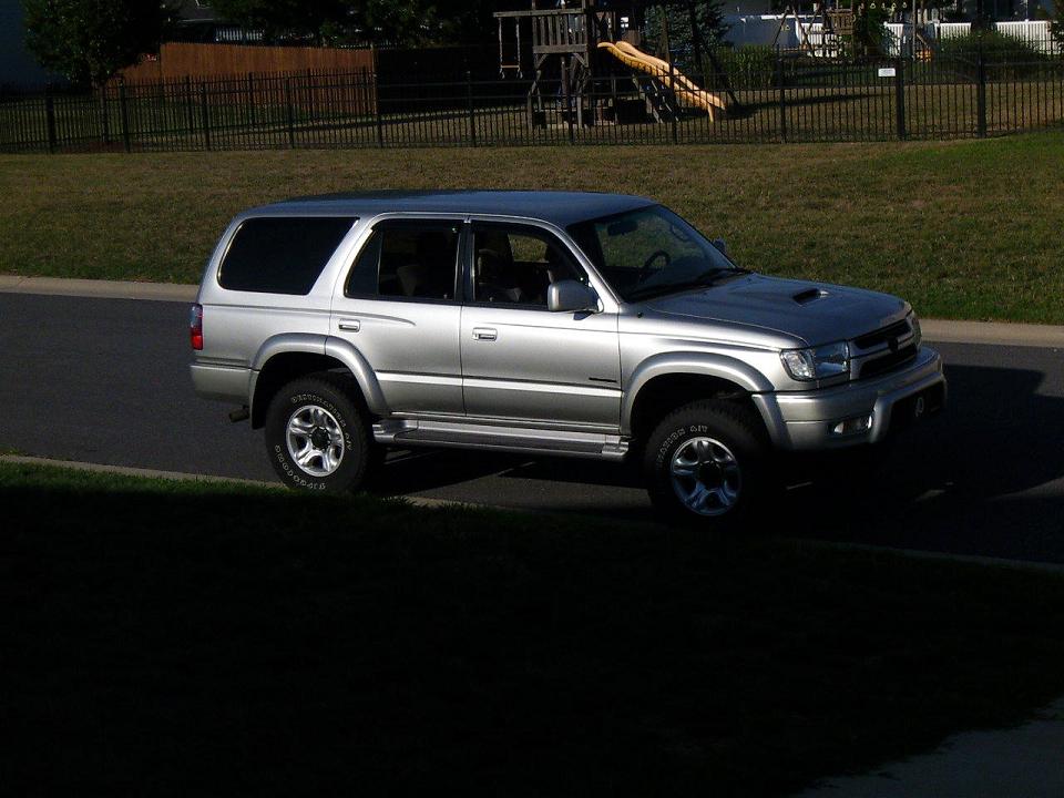

Trust me I found out the hard way that running boards are not all equal (just ask LimitedBob). Limiteds and Sports use the same running board with the exact same mounts but not the same end pieces (front or back). A limited has a much wider, and lower, fender flare while a sport has a slightly narrower and shortened flare.
Essentially a limited running board will not match up with a sport fender flare (the end pieces are not tall enough). However, I have noticed that it is possible to remove the end pieces, so if you still have your orginial running board end piece(s)(you need to match your style of flares), then yes you could switch them out and they should work.
Here's a pic of what happened when I tried to put a set of limited running boards on my sport. Notice the gap between the top of the running board end piece and the bottom of my flare.

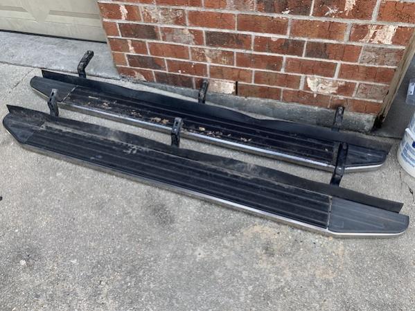

Anyone know where I can find some reasonably priced running board mounts?
I bought some boards off a 2014 for $40, which look great (chrome and black rubber), but I need different mounts for my 93. The ones on eBay for Gen3 look like they might fit but I am not sure and they are priced at over $100 (with s&h).

Wish I did; how are you with a welding torch? I had trouble getting brackets for my '97 SR5, but my local mechanic took one look and in less than a day cut and fit a home-made set that works like a charm!
