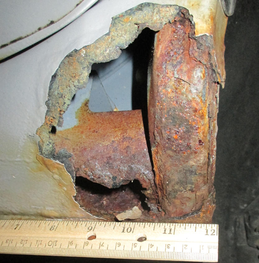

If you live in a cold weather climate, the running boards allow pooling of water to build up which create rusting on the rocker panels. Apparently it's a design defect.
Ah, yes. From a 1997 Pennsylvania/Delaware 4Runner I obtained in November 2013. Left side, directly ahead of rear wheel.
