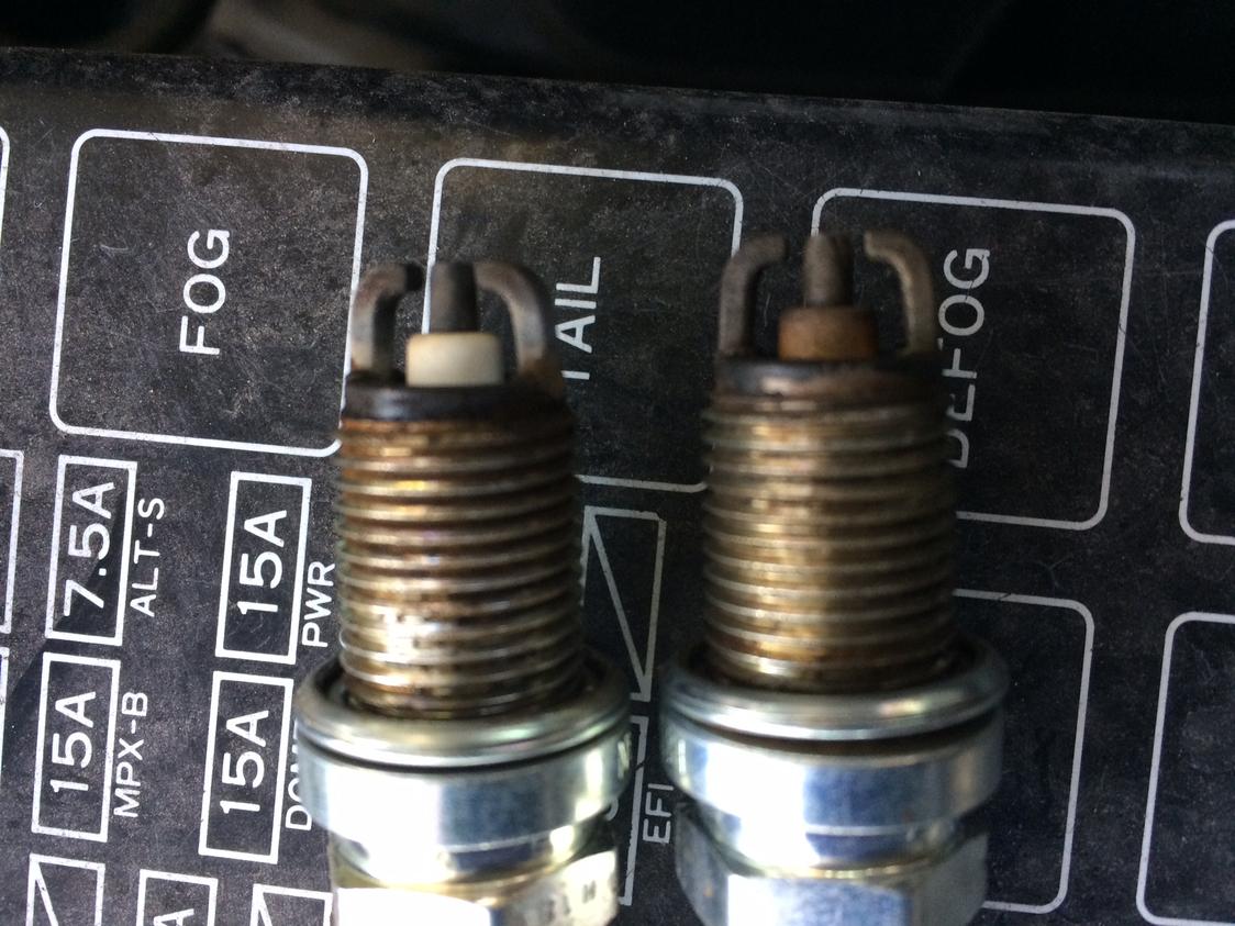

The cleaner insulator tip is from the #2 cylinder. The dirty insulator tip is from the problem cylinder, #6.
There is one injector in town, store is open today.
I am going to swap the 2 plugs, just see if any thing changes.
Then I am going to swap the #3 coil pack with either #5 or #1 for one more test of that set up.
Any comments on the plug differences?

Switching the plugs sounds like a good idea because that dirtier plug could be fouling. Question is, what caused that plug to foul?
Here's a couple good articles related to your problem:
Spark Plug Fouling
DIAGNOSING MISFIRES

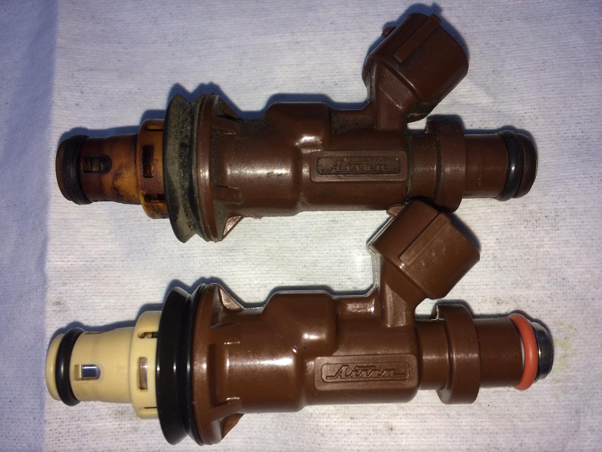

Installed new injector in #6 cylinder. Got a little better but still rough idle and sorta stumbling, running rough under acceleration. It did not set a code on the test drive but it still isn't right.

Here is a pic of the old and new injectors.
