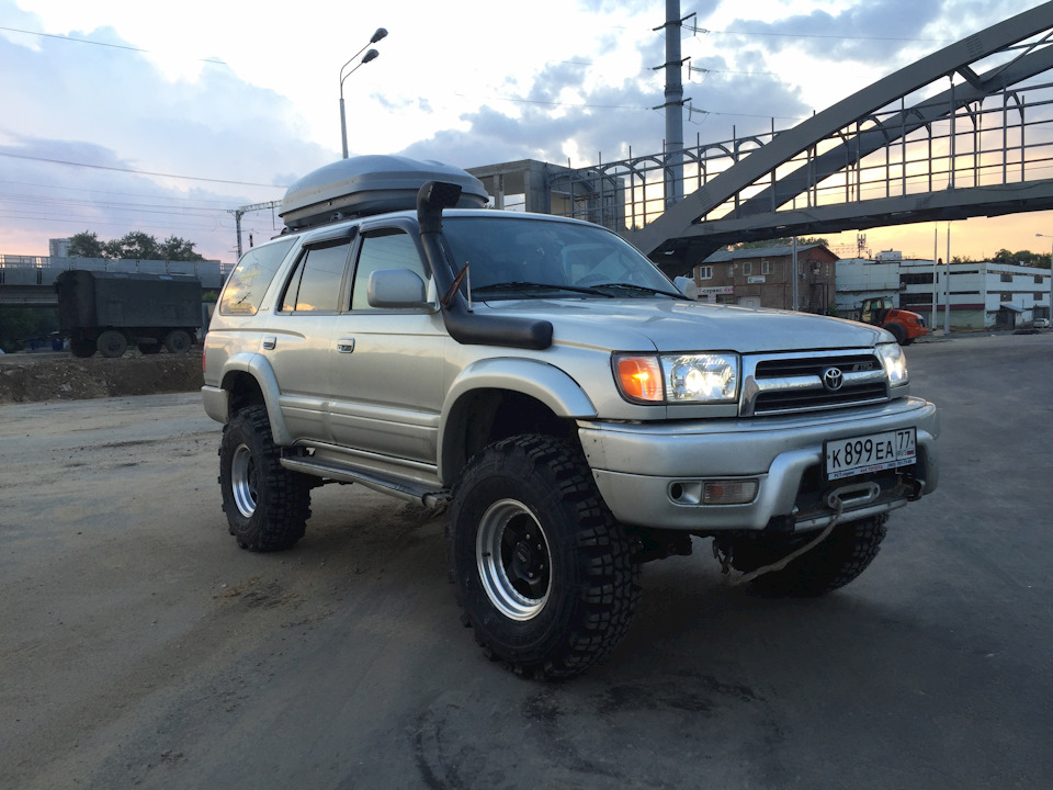

It's my SLR("Samiy Lutchiy Ranner", in English - "the best Runner")
3rd Gen Limited '00(not California Spec)
Shortly about it:
Multi-mode,
3,5" Front Suspension Lift Bilstein 5100/Ironman TOY055B
4" Rear Suspension Lift TLC80/OME 2861
2,5" bodylift
Eaton Truetrac Front Locker
OEM Rear E-Locker
Front 5,29 Yukon Gears
Rear 5,29 V6 Trail-Creeper Super Finish Gears,
315/75R16 Mickey Thompson MTZ
China NoName Snorkel

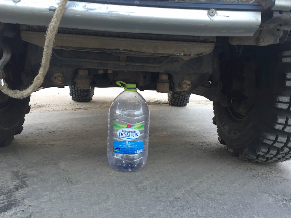

Custom Front Kingone TDS winch (17 meter per minute, 15000lbs) with Synthetic Rope 13mm

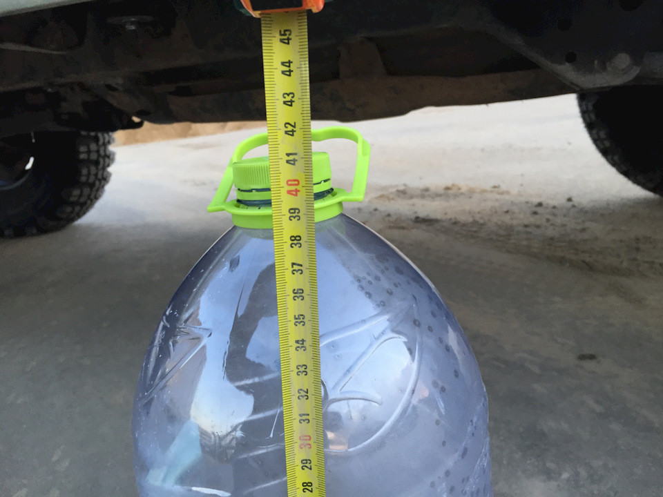

34cm under front armor
